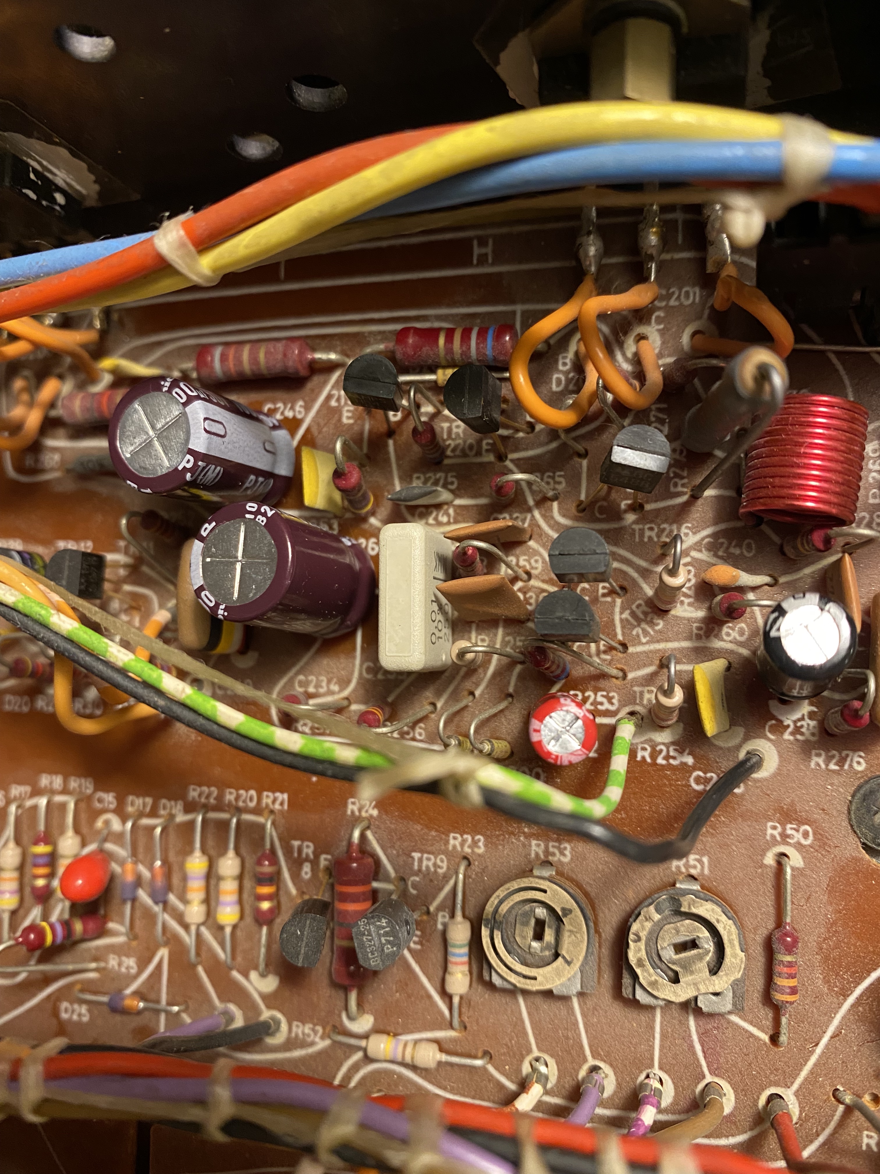

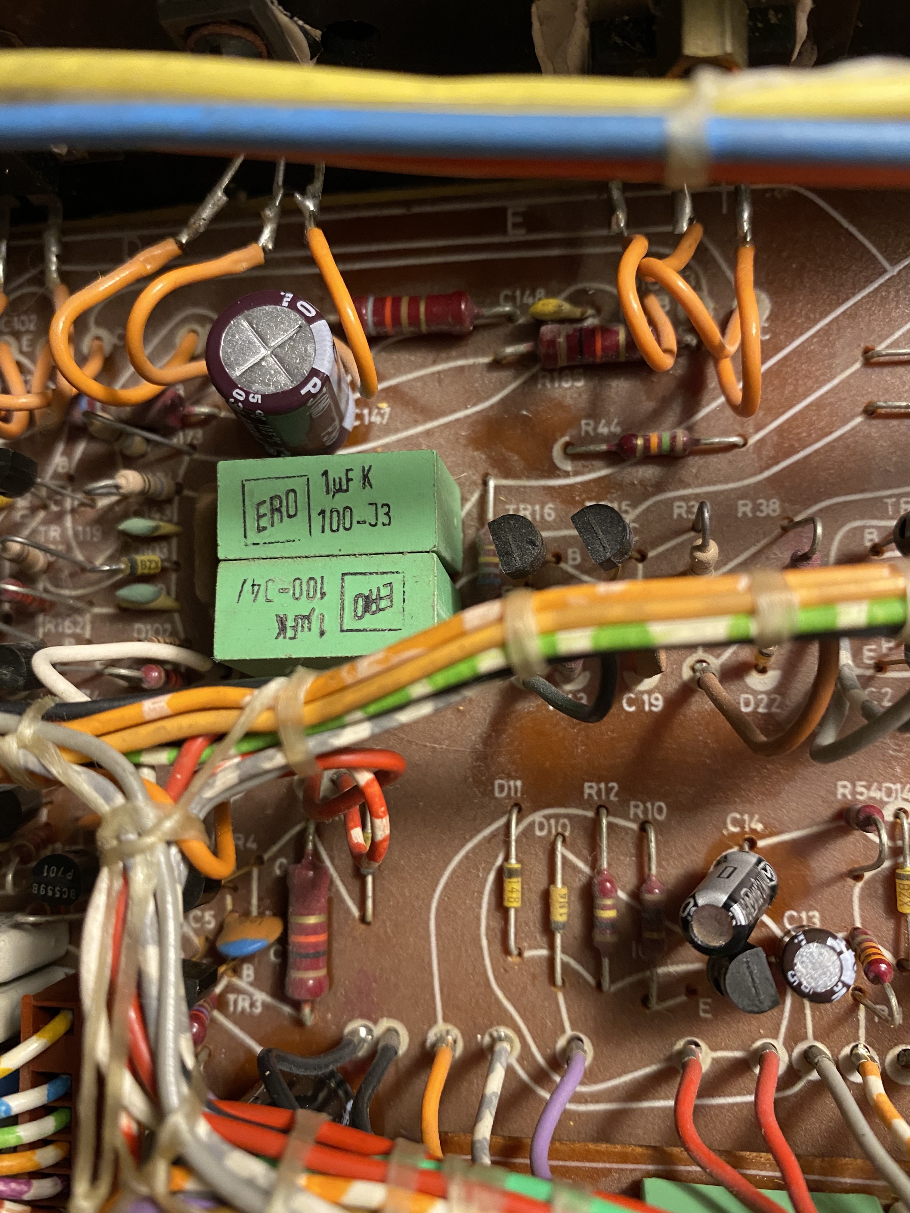

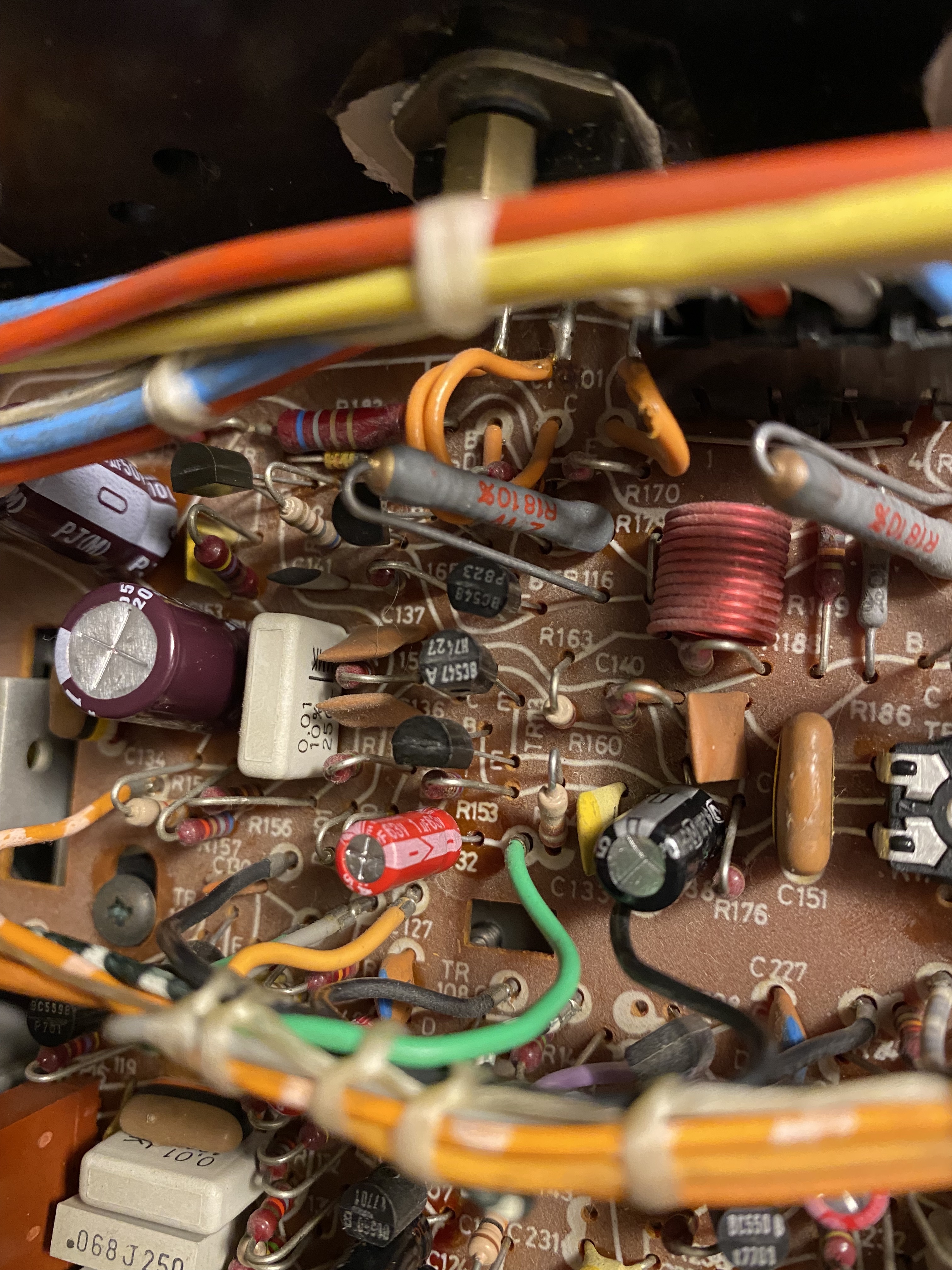

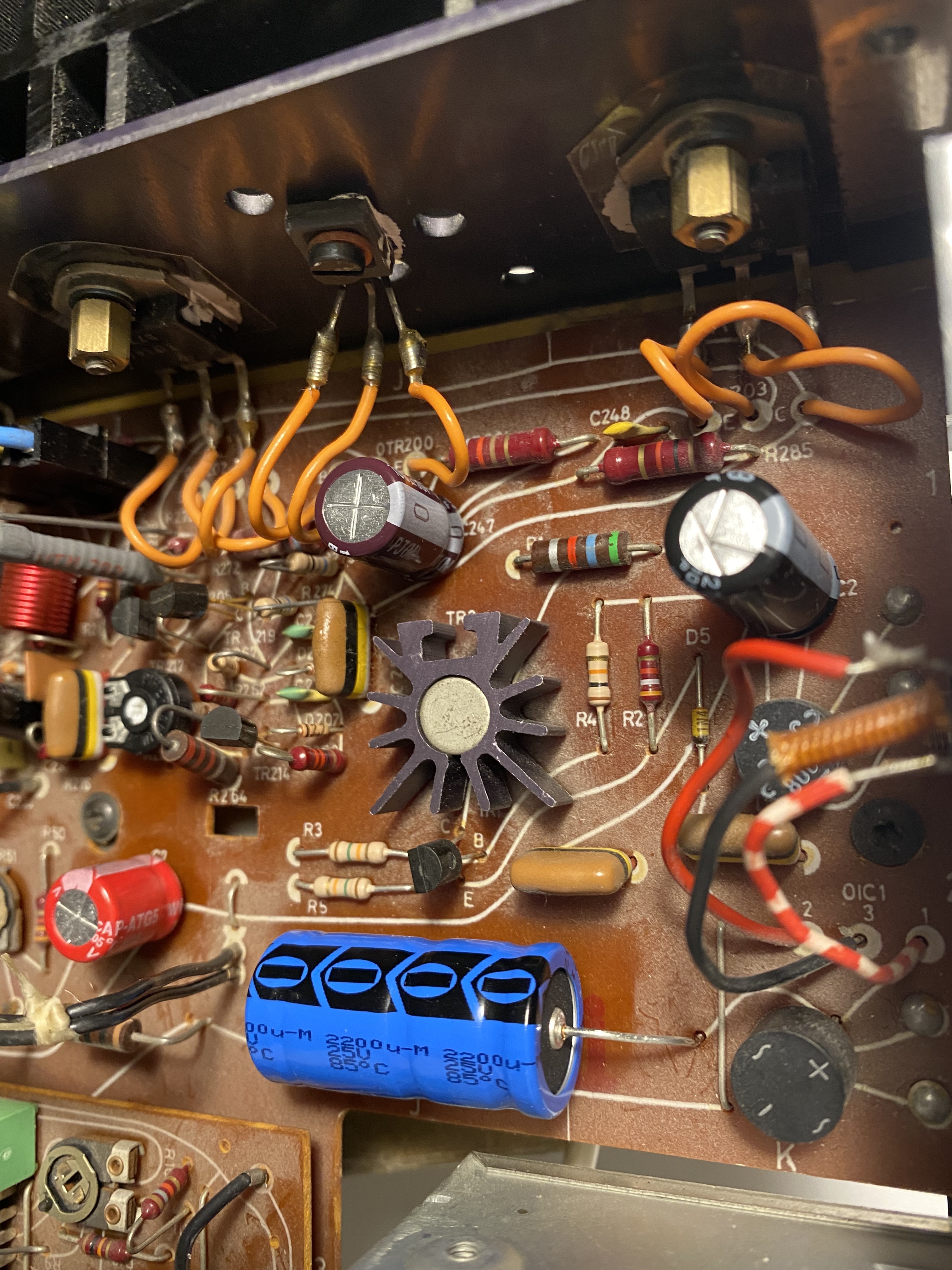

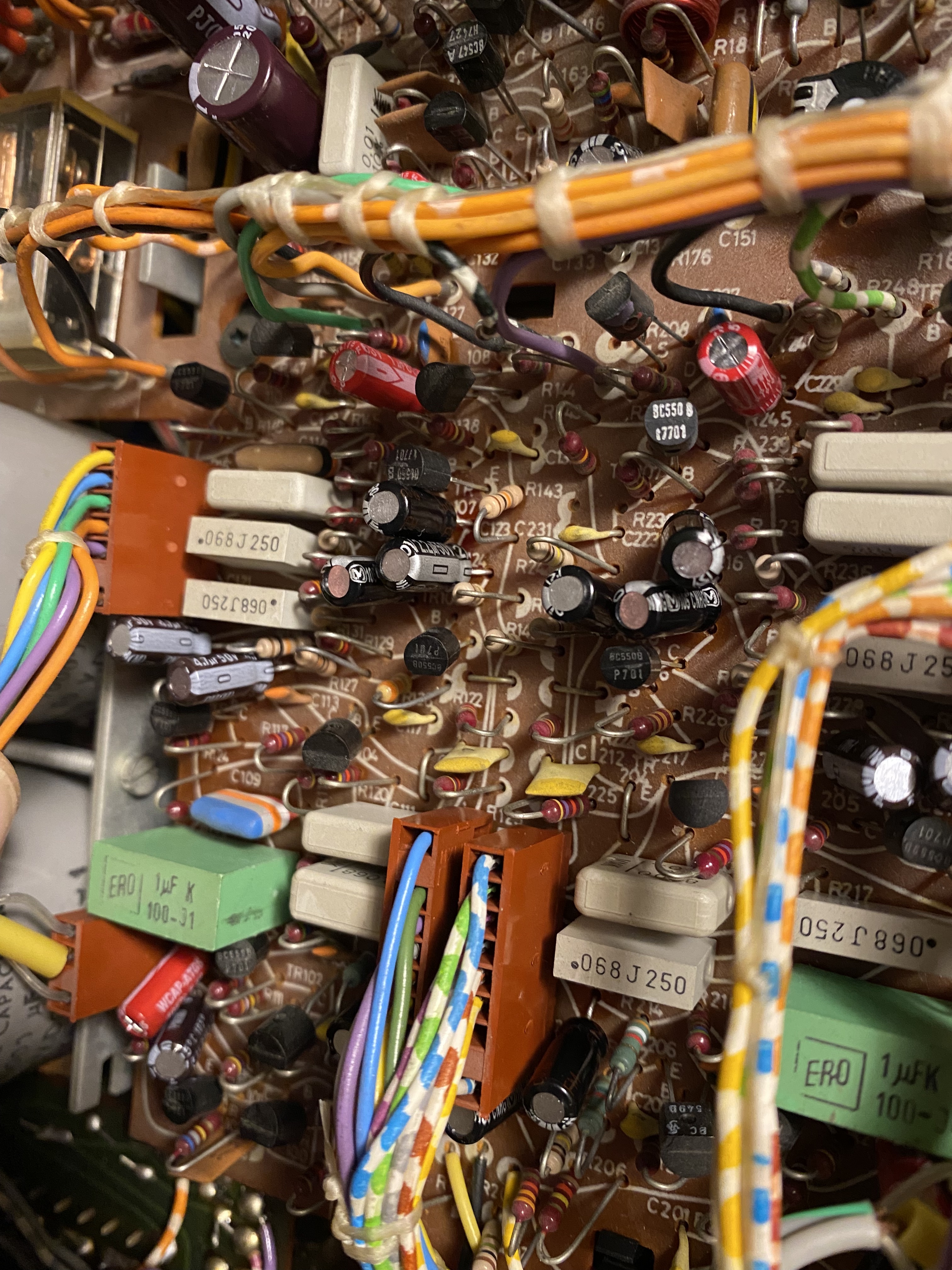

Hello fellow Bang&Olufsen enthusiasts,
I recently bought a used (well, they all are at this point) Beomaster 4400 that was in desperate need of a recapping. So, I have changed all the caps and also the light bulbs, and there is some good news:
1) The Beomaster turns on, the lights for ON and The S-meter as well as the stereo LED and the two stereo lamps are working.
2) I have adjusted the no load current and the heat sink stays cool.
3) I have sound in the head phone jack :)
The bad news: When I check the 35v rail, I get nothing. So I am presuming the protection relay is active, though I hear no click when turning the BM on?
I have been measuring the transistors and TR11, 115, 120 and 217 look suspicious. Since I am not a radio technician, I humbly ask you if there is anything obvious I am overlooking.
/Filip

Do not interpret the polarity by the circuit board.  Sometimes the schematic can be wrong but sometimes the board indication (the white, circle) doesn't always mean the negative side of the capacitor goes there.
Ideally the best scenario is you are recapping an original B&O board that hasn't been worked on.  In that case you can follow how the capacitors are installed and replace them one at a time, keeping the polarity as you found in the original.
If you no longer have that luxury then you will have to analyze the circuit and figure out how that is on the actual board and determine the correct polarity that way.  That can be kind of a pain but is a learning experience :-).
Another option is to take advantage of this Beoworld Forum and where you are in doubt about a certain capacitor - take a nice photo (maybe a couple) and post it here.  Some Beoworld workbench members will be able to look at it and tell you which way the polarity goes.
