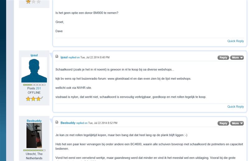

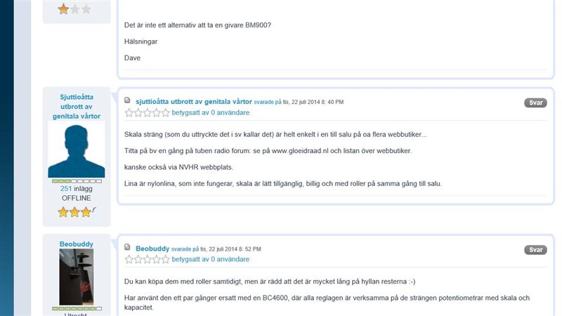

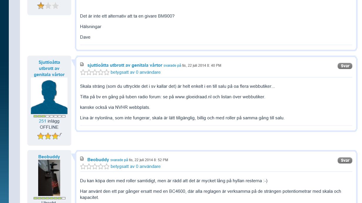

This thread interests me a lot, not least for the abundant element of vintage equipment. In fact, it interests me so much that I use a translation page, www.microsofttranslator.com, to translate the content into my language, Swedish.
But when I let the above mentioned translation services do its job I get an in many ways surprising results: "ipaul" is translated to "Sjuttioåtta utbrott av genitala vårtor", or in English: "Seventy-eight outbreaks of genital warts". Well, it's true. Is there any explanation for this?
A clip from the original page:
And after translation:
