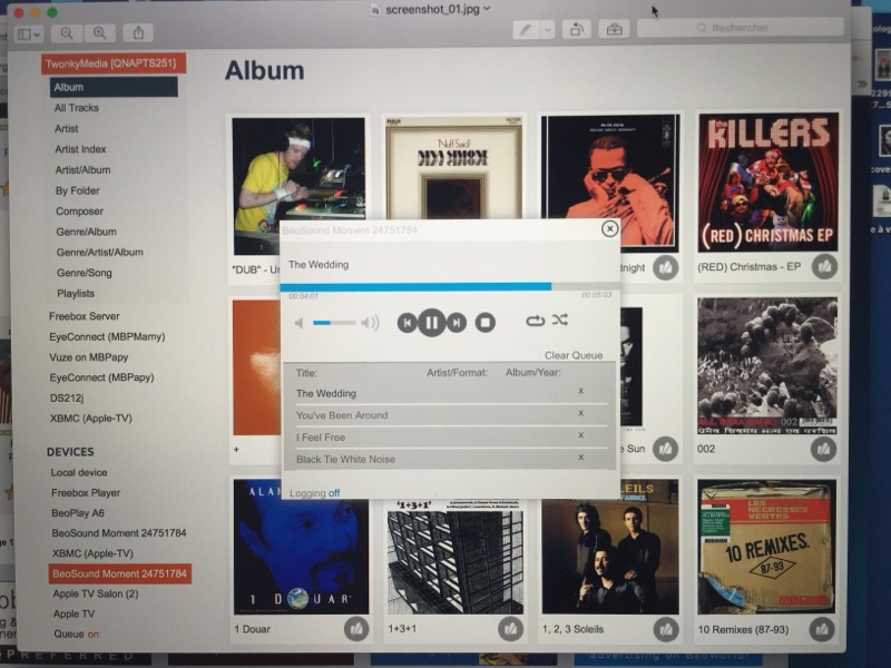

Not sure if the option was there prior to the latest upgrade, but you can stream music directly from the DLNA server to the Moment. I find this a good option as the Twonky user interface is more user friendly when searching for artist albums or tracks than the JukeBox or the BeoMusic App.
mbolo01: Not sure if the option was there prior to the latest upgrade, but you can stream music directly from the DLNA server to the Moment. I find this a good option as the Twonky user interface is more user friendly when searching for artist albums or tracks than the JukeBox or the BeoMusic App.
So you go into the Twonky server interface to e.g search? How do you initiate to play the selected song on the Moment?

Hiort:So you go into the Twonky server interface to e.g search? How do you initiate to play the selected song on the Moment?
This is strange to me, have tried it before but it was sending the sound to my V1, not to the Moment. (BeoLab speakers are connected to the V1).
"Believe nothing you read and only half of what you see, let your ears tell you the truth."
mbolo01: Hiort:So you go into the Twonky server interface to e.g search? How do you initiate to play the selected song on the Moment? On the left frame of the Twonky Interface (running on QNAP) you can select the output device. There are two Moments (don't ask me why) but one is working perfectly, you can even control the volume from here.

I´m running the old version recommended by B&O so that feature may not be there. I will check however.
Hiort:I´m running the old version recommended by B&O so that feature may not be there. I will check however.
