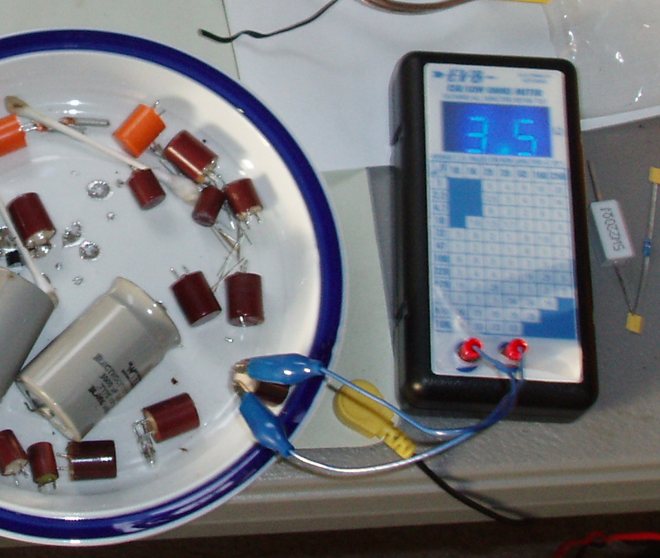

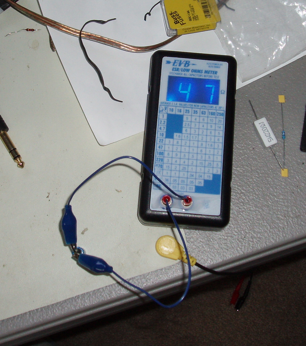

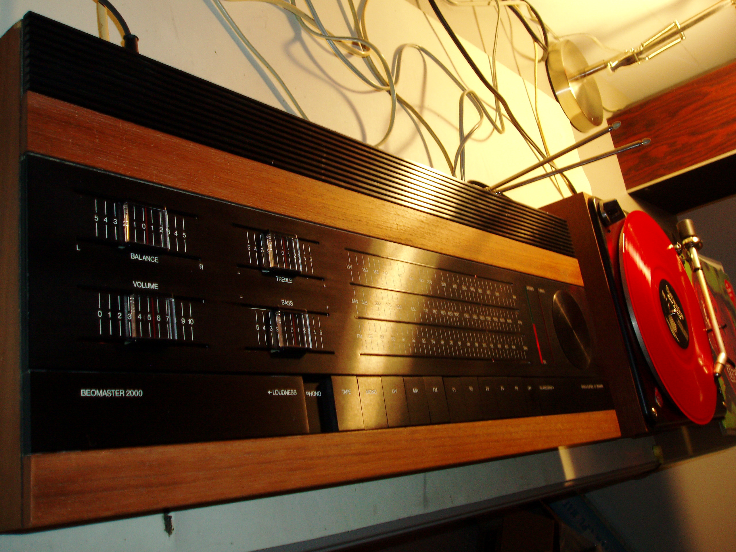

Ricardo replied on Tue, Feb 23 2016 10:48 PM
....... and I already like it. come with a handy scale printed on the faceplate. In the first photo you see one of the new 100uf 50V caps I use in the 901. right on scale.
The next photo shows the reading of the most wasted looking of the 100uf 40V caps I replaced. It is nearly 6 times the scale average. very handy little tool especially if you think you have a bad replacement cap installed somewhere.

Ricardo:
I have an Anatak blue esr meter and have been using it for about 3 years, even useful when measuring on board. My experience is that only about 30% of the old caps needs renewal but many of the rest are at the limit of going bad
