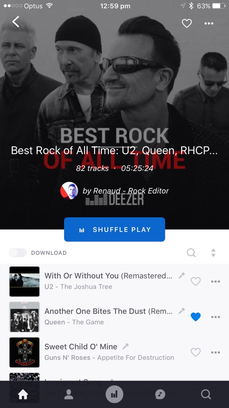

We both started using iPhones to play music; the main Objective had been to demonstrate Google cast but we started with Airplay via the Essence.
Intense high volume static ensued.
He ran to get a Beo4, I killed my App, the crackling continued so I grabbed the BR1, and we both hit standby at the same time and silence ensued.

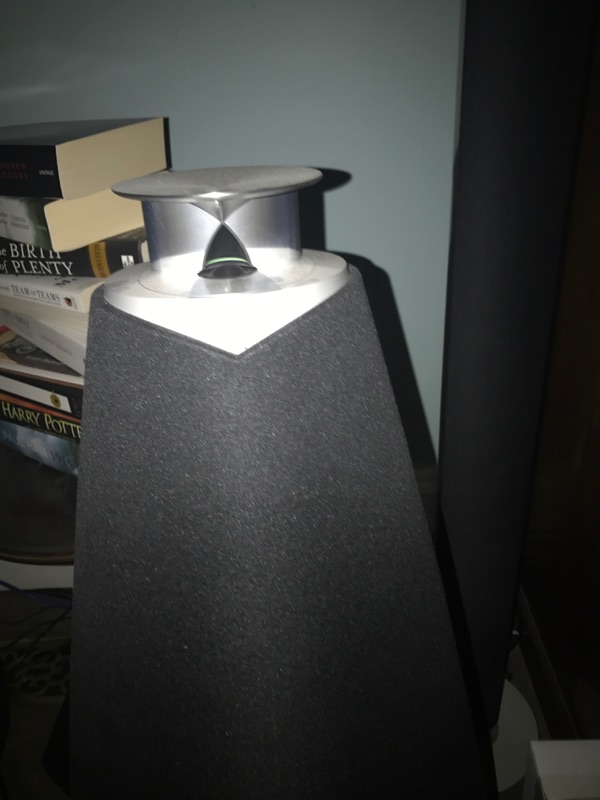

Imagine smaller kids or other visitors who might come to close to the speakers just to inspect them and then the armageddon starts. That might end in hearing problems or a heart attack. Dogs & Cats might have real trouble after that noisy surprise, too.
Some people might see these as USPs Stick out tongue
In my case I do want to protect the grandkids but also have them keep their distance Big Smile a fine balance
Today I hammered the speakers for 3 hours without any problems -- Another One Bites The Dust on these speakers was a joy to experience 🔊 Cool 🔊
