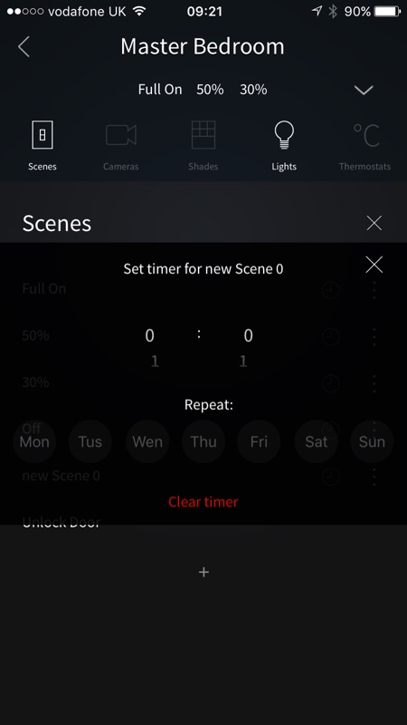

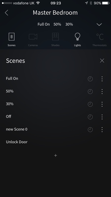

athos replied on Thu, Mar 9 2017 9:15 AM
After installing the new BLGW sw, the old Blink app (so not version 2) gives issues. Everything works well, only when I want to go to the "homecontrol part", the app stops and goes back to the homescreen of my iOS device. Tried it on a iPad mini 2 and on a iPhone 7, both gives these problem. The Beolink2 app does work proper. Only missing the possibility to make timer tasks.
Seanie_230
UK
Posts 2,278
Have a look below
Create a scene then type the clock
