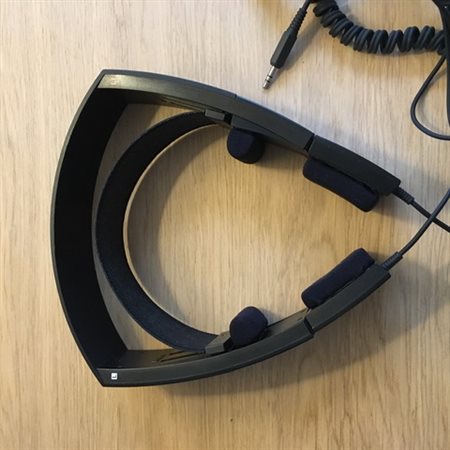

Hi alls,
My Form 1 Headphones arrived yesterday.Of course they needed some attention but it is in general good shape (alu plates, markings, units, all good).
The headband was dirty and whitening, so i put in water and brushed it with a scotchbrite sponge. I removed all the dusty coating, very dirty process, put gloves and protect the table and ended up with a clean and black headband which looks like cardboard. Can't figure out how it did look like when new and I may replace it with leather as another member did but for now I wanted to keep it "original".

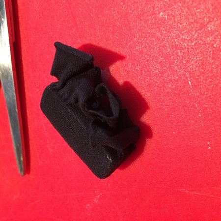

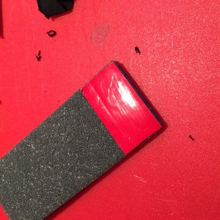

Of course no foams at all. So here is my attempt:

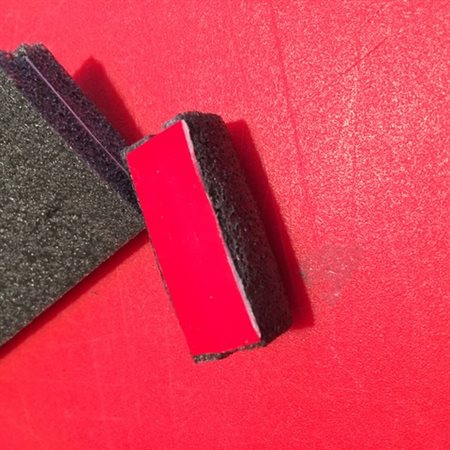

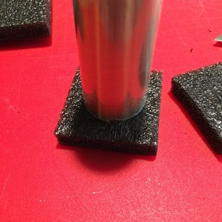

I used yoga mat (6 mm thick) for the"spacers" and a foam plate from an old parcel protection (10 mm thick) for the ear pads).

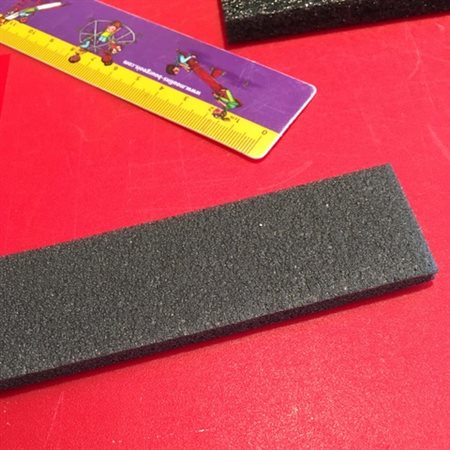

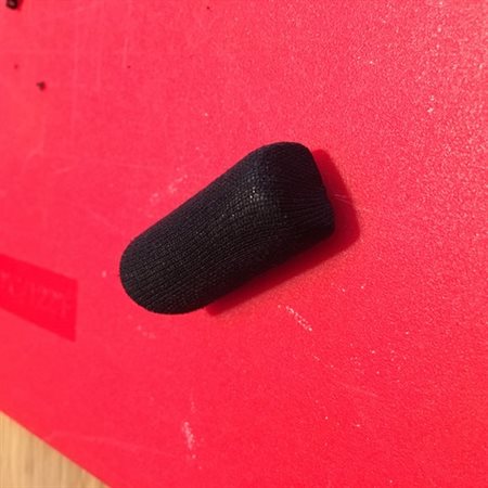

The spacers:

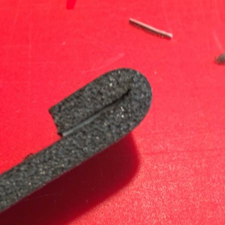

Now cut at 15mm from the top (actually 14 is better). And another piece of red double sided adhesive tape.

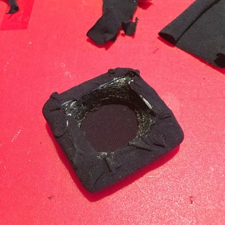

I used a decommissioned pantyhose. Cut a small square, wraps it around starting with the corners. stick it to the double sided adhesive.
Cut the remains tight.

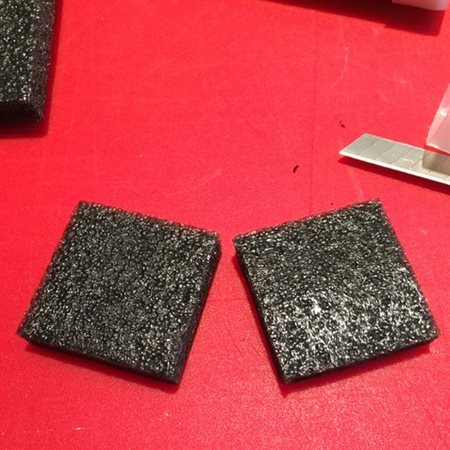

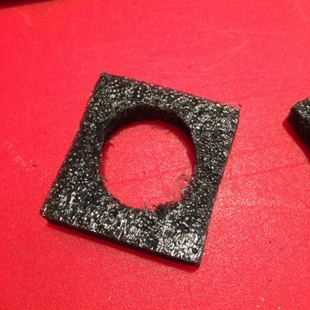

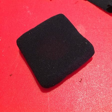

The ear pads:
Same technique.
Stick it all with double sided tape (maybe not red this time!).
I need to do it all again with a little more attention and care but it works!. Don't know about original foam density but i've tried it like that (not for hours though) and it's quite comfortable enough, no strong pressure on the ears or temple. But I must say that you look really weird with those headphones on!

Hi alls,
I did refine a little bit my technique and end up with thinner, more flat pads with less fabrics folds thus sticking better to the headphone.
Here is a step by step "how-to" if anyone interested. Regards…
