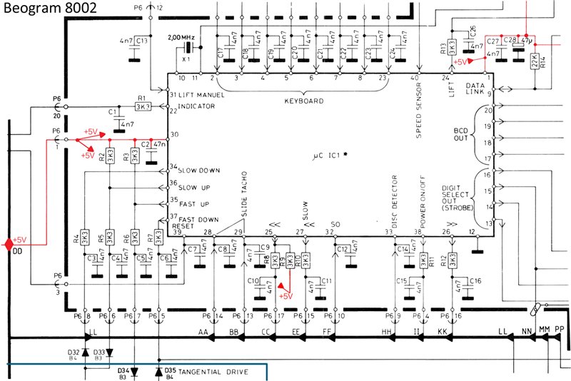

Were you measuring right on 2IC1 pin 24 or were you at P6-18 (which is where the signal goes)?  That "Lift" signal goes to the base of 1TR8 so if it turns on that transistor then it will be around 0.7V.  The signals I was wanting you to monitor with a scope are 2IC1 pins 34, 35, 36 & 37 per that table in the service manual. I wanted to see if you can see any states (slow down, slow up, fast up, fast down) when the turntable is supposed to be off. Also that the states are per the service manual when the uC is sending the commands to the platter drive.  I am expecting the pins to be in their off state which means the uC is doing its job but some other fault in the platter drive circuitry is resulting in the motor turning. So yes, check those signals at Standby.
Here is a better version of uC (2IC1) from the Beogram 8002 schematic.  This part of the schematic is pretty much the same.

ALF replied on Sat, Jul 7 2018 11:31 AM
Yes, I was measuring at P6
now, please bear in mind the platter spins anti-clockwise while
checking Pins 34, 35, 36 and 37 in STANDBY mode with my scope:
all signals were about p-p 200mV or less and of similar shape, meaning you were spot on with your prediction.
but the drive still gets enough voltage from somewhere to spin the platter in STANDBY mode, stop is just not happening 🙄

sonavor replied on Sat, Jul 7 2018 4:08 PM
Okay, good. I think that confirms that the uC (2IC1) is good and the voltage(s) causing the platter to turn is some problem in the tangential drive circuit. I guess that brings you back to the brake circuit (where you were several posts back). I am away from my workbench for a while so I can't check the voltages on a working Beogram 8000 at the moment.

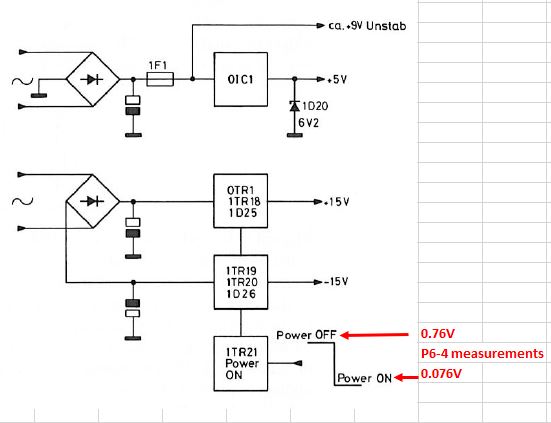

at an earlier reply Martin suggested that 0TR1 is not closing but continue supplying a drive voltage, which makes a lot of sense!
the question for that however is:
which part is allowing 0TR1 to stay ON ? Its emitter would have to be a constant voltage supply and the only wheel to turn
would be via its base, cutting down the +15V supply ?! Or do I see that the wrong way ?!

The +&-15V supplies are controlled by 1TR21 which in turn is controlled by pin 38 on the uC
Based on Martins explanation of startup I can think of two scenarios:
1. The brake is activated but the rotation is not sensed so the uC keeps powering the brake circuit. It was expecting to sense rotation, then stop the rotation and turn off the 15V PS via pin 38 but this never happens
2. The rotation is sensed but power is still supplied to the base of 1TR31 via an effective short in the base circuit which keeps 1TR31 biased on which leads to continual backward rotation of the TT.

With "the base circuit" I mean any part of the circuit that is connected to the base of 1TR31. If there is a leak path that can generate approx 0.16mA of current flow then this would generate enough voltage drop in R109 to allow 1TR31 to be biased on. I think this is pretty unlikely to be happening now that you have confirmed that 1D35 is ok.
To absolutely rule this out can you confirm that you can still get the TT operating clockwise at 33.3 or 45 rpm. If you can, is the voltage at the base of 1TR31 approx the same as the PS voltage supply which would indicate that it is biased off. If it is biased off then there is no continual leakage path.
Regarding 0TR1 not turning off, measure the voltage at the collector or 1TR21 when the 15V PS is supposed to be off. If the collector voltage is around 0.7v then the uC is most likely still controlling it to be on. If is is 0v you may have a short in 1TR21. If it is 5v then the fault must be closer to 0TR1 as the uC is not keeping it on.
Regards

ALF replied on Thu, Jul 12 2018 11:18 AM
Hi Lonnie,
if I connect he deck to mains and quickly activate play before the platter starts spinning anti clockwise everything works fine and 1TR21 collector
shows about 0.67V.
i can do a similar thing if it is already connected to mains and the platter spinning the wrong way by “hand-braking” briefly and activate play...same result.
once the deck is in STOP/OFF mode the collector at 1TR21 goes fluctuating between -0.8 to -1.1V .....not 0V and not 5V !!
no progress yet...🙄

ALF replied on Fri, Jul 13 2018 1:19 PM
Hi Lonnie,
the emitter of 1TR18 is about -0.63V  practically unchanged at PLAY and STOP/OFF.
yes, I have the 15V at 0TR1 which does not change, nor do emitter and collector at around 22V.
0TR1 definitely does not close !!
ALF
Lonnie
Posts 70
Lonnie replied on Fri, Jul 13 2018 1:27 PM
Hi ALF,
I opened up my BG 8000 to take some measurements:
At P6-4 on Standby = 0.76V, during Play = 0.076V
Collector 1TR21 on Standby = 0.067V, during Play 0.58V
So during standby 1TR21 is biased on and during Play it is biased off. A little different to how I thought it worked.
Your measurements of -ve voltage at P6-4 are an issue that we need to understand.
Lonnie
Posts 70
Lonnie replied on Sat, Jul 14 2018 1:07 AM
Hi ALF,
The emitter voltage at 1TR18 is correct and 0TR1 will only "close" when 1TR18 is biased off which means the emitter voltage at 1TR18 goes above -0.63V. This will only happen when the -ve 15V supply is turned off. Things to measure and check:
Examine solder of pins P6 - 3,4,5 to confirm there are no solder bridges
Double check that 1TR21 has been replaced with NPN and is not in backwards.
Measure the CBE voltages of 1TR20 & 1TR19 during standby and play.
If you don't find any errors I'l lift the base of 1TR21 off the pcb and measure the output of uC pin38 during standby and play operations to see if it still puts out -ve voltages or if it puts out similar voltages to what I measured on mine.
Regards

Lonnie
Posts 70
Lonnie replied on Sat, Jul 14 2018 6:51 AM
Hi ALF,
You need to replace 1TR20 (PNP) and I think you should also replace 1TR21 (NPN) at the same time.
Regards
Lonnie
