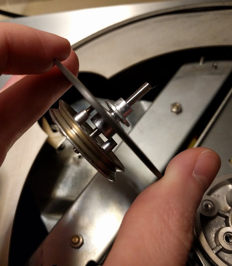

JBR2021 replied on Sun, Sep 12 2021 4:13 PM
Hello,
I am looking for a brass pulley which is missing from my Beogram 1200.
Any lead on how I could get one?
Best,
Jonathan
JBR2021
Posts 3
JBR2021 replied on Sun, Sep 12 2021 4:14 PM
Hi,
I look for a brass pulley which is missing from my Beogram 1200.
Any idead on how I could get one?
Cheers
Jo

"transparent shrink tube"
Now that's a superb idea - I'll remember that!
Menahem Yachad
Top 75 Contributor
Jerusalem, Israel
Posts 1,249
Perhaps these members who have good metal workshops, could make up a pulley for you.
Soren Mexico, and Evan
Search for them, open their profiles, and start a conversation
There may be other members who could do so, but these are men who have done excellent work for me.
