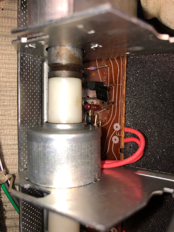

None of the lights bulbs are powered on the PC12 - motor control. This problem existed before I shorted the audio output. Three of the bulbs illuminate through an external 9V battery. The motor activates when any of the command buttons on (PC 12 motor control) are activated on.
Only three of the clutch disks activate when standby is pressed or when the individual channels are pressed: Volume, >
Also when pressing TAPE on EL Switch - PC No.8 after any other setting i.e -Aux2 and Q4 both sets of lights stayed illuminated I. AUX2 and TAPE; Q4 and TAPE
Therefore there seems to be a problem with power reaching part of (PC 12 motor control).

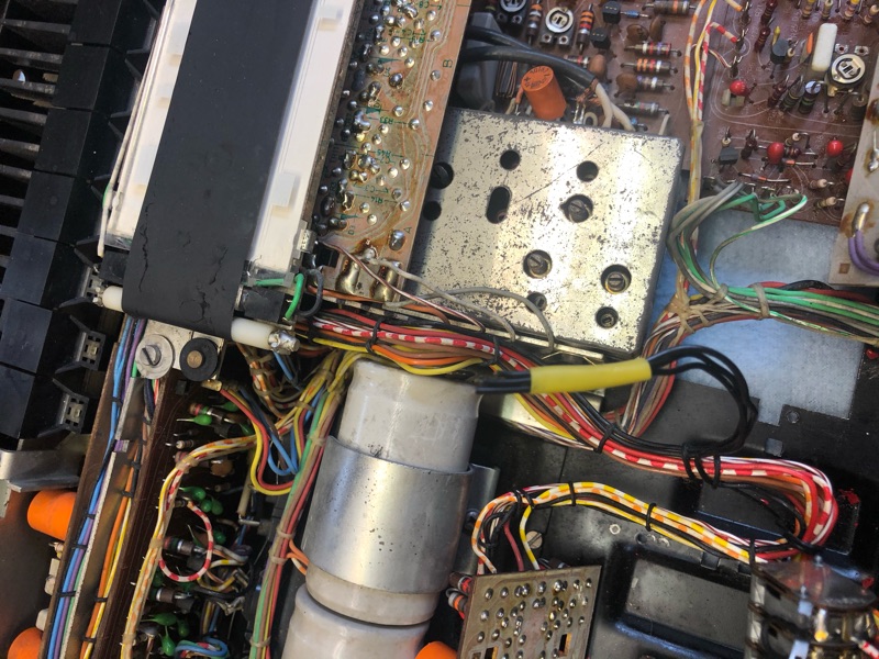

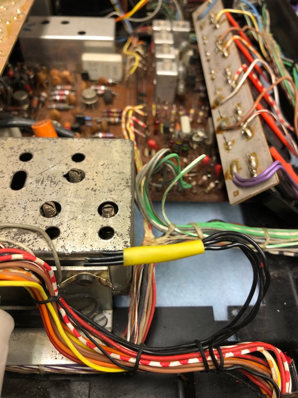

Finally were the set of unused leads pictured in the yellow sheath not wired to enable an upgrade on the machine at a later date?

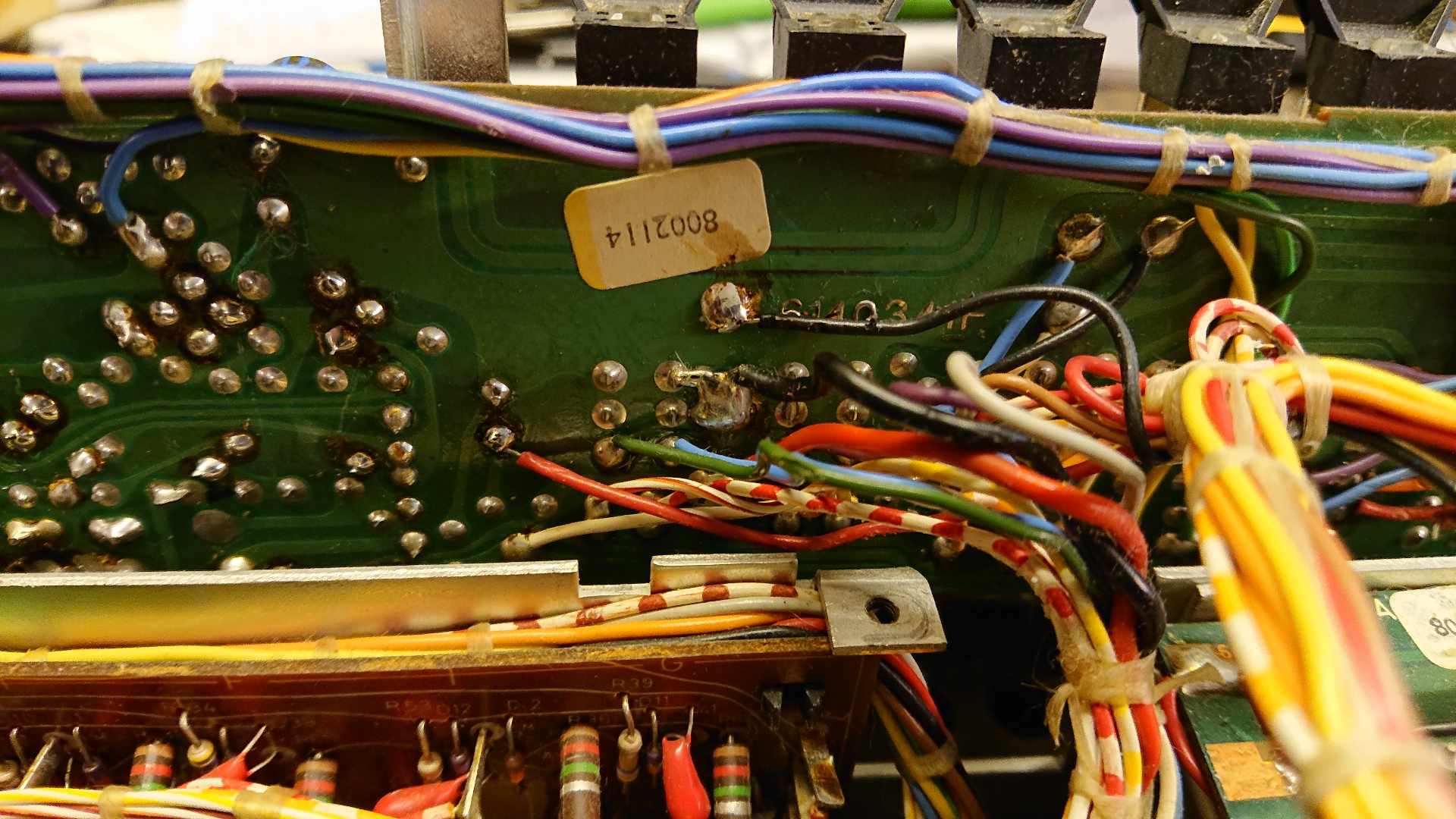

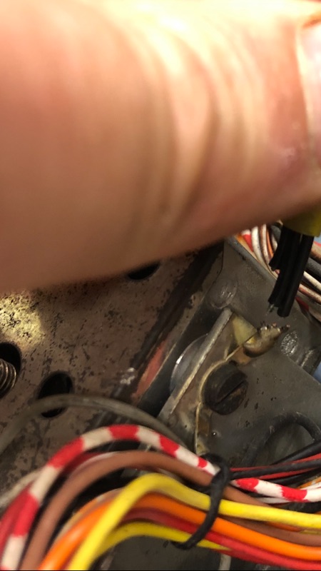

There's a lot going on there......your going to need to tackle one at a time.....the black wires all tied together are almost certainly ground connections that have broken away, these single strand wires are a menace in this unit and are constantly coming loose....they will also be responsible for some of your problems, they should all ne tied/soldered to a central point close to where they are right now...do you have a circuit diagram?

Thanks for this. Funny you should mention the grounding issue. On a closer inspection last night I
discovered the initial source of the wires. I will resolder now.

Craig replied on Sat, Aug 8 2020 9:03 AM

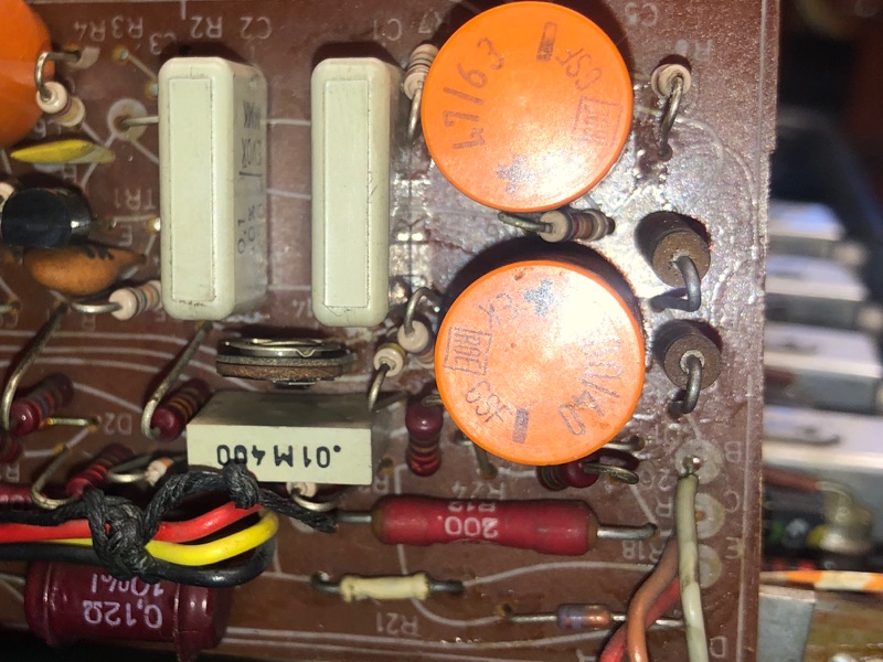

Yes that looks right....also check the four big output capacitors.....i have found these failed due to corroded connections and out of spec.

Hi again, I have soldered the three wires to grounding terminal.

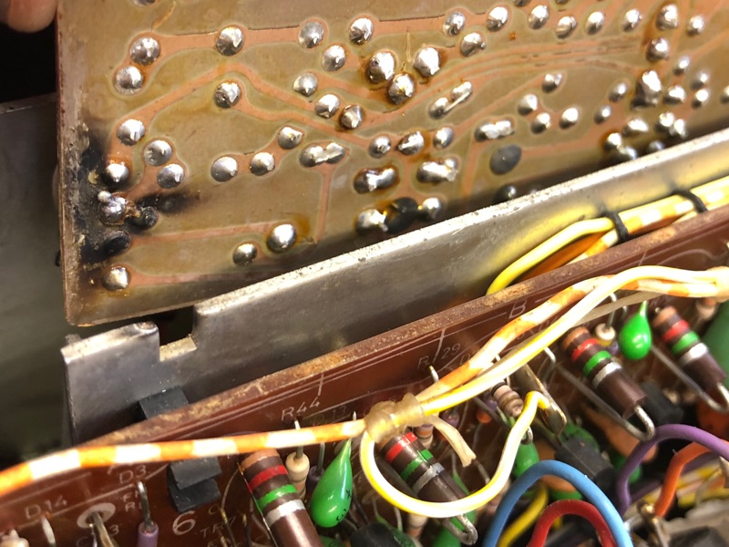

I am getting and learning all the pitfalls of this system that I’ve read about. When turning on the power again one of the Darlingtons blew (MJ3001) and the red resister beside it. I will order some more Darlington and persevere aware of the complexities with this repair. In the meantime, thanks.
One question would you or anyone else on here have an up to date Capacitor list for one of the main suppliers?

That power output board will have bowed over time and that's possibly why it has shorted out against the support, in one of my repairs I inserted a sheet of thin mylar the same size as the output board between the board and the metal support to prevent this happening.....

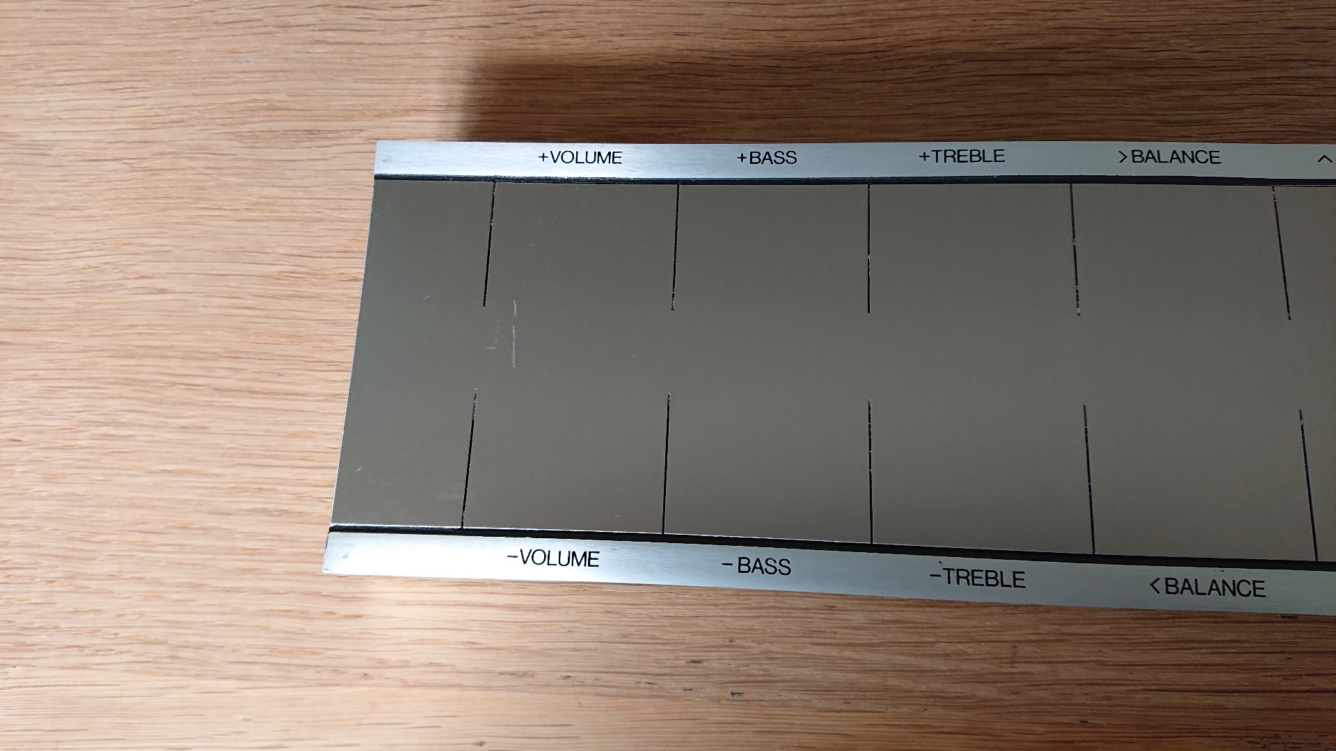

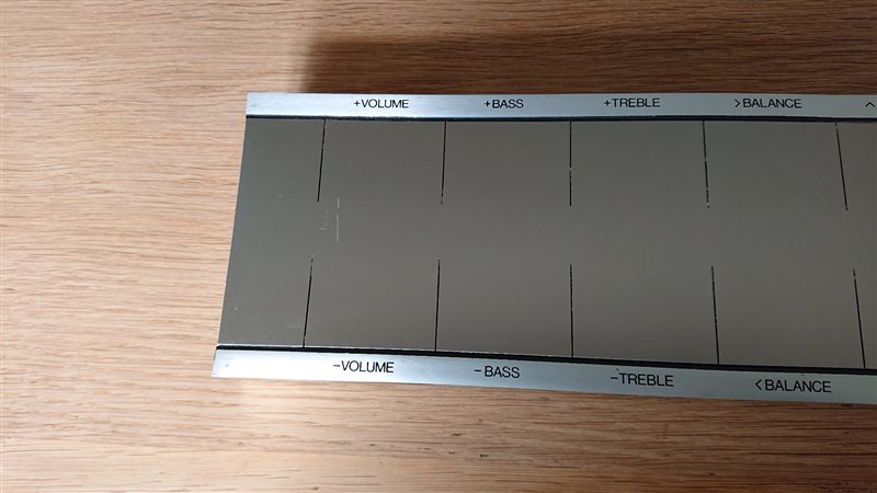

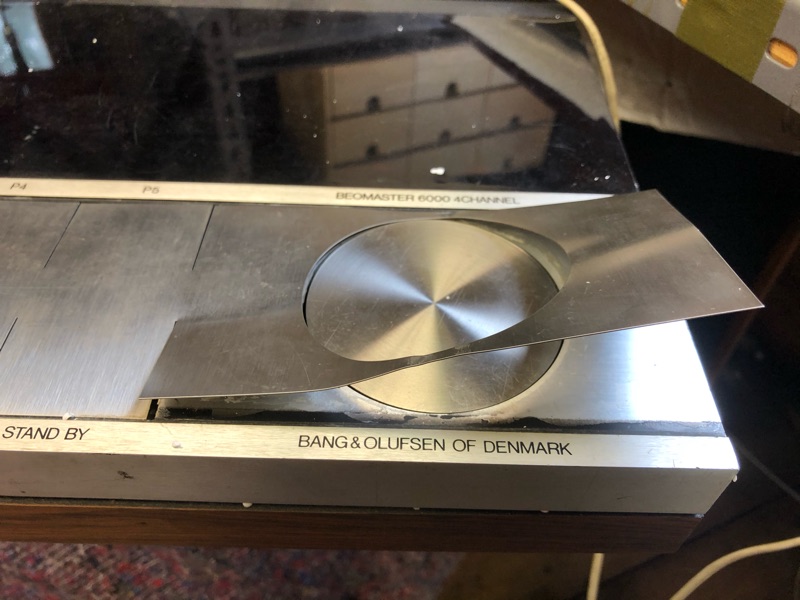

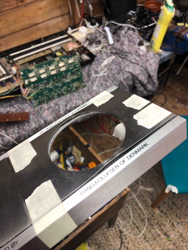

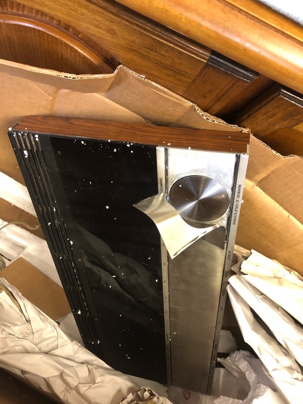

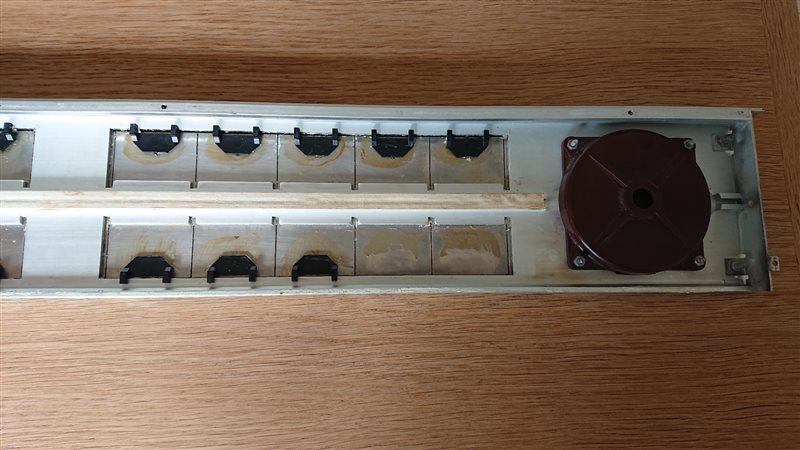

Here is the control panel for the Beomaster 6000
(Type 2702) pre delivery
And how I received it
After some work on my part, but this will never be without damage I’m thinking. Any suggestions?
The cosmetics aren’t a massive priority right now....

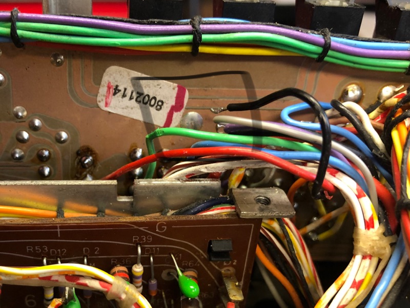

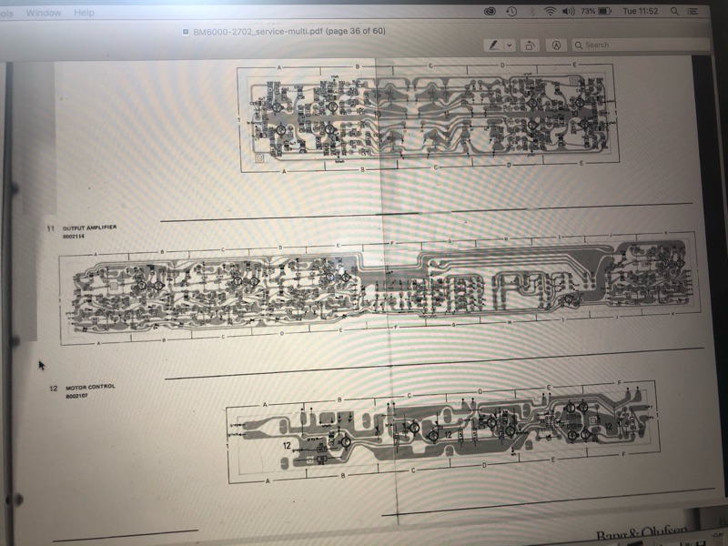

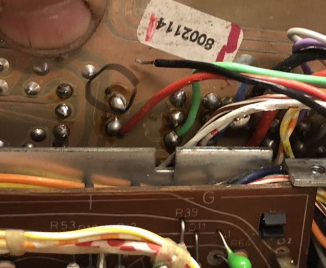

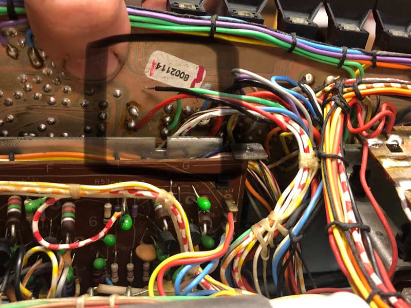

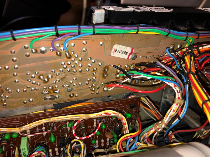

Hi, is anyone able to confirm if the loose black lead goes on the solder point above the red lead on the board pictured?

sonavor replied on Wed, Aug 12 2020 3:43 AM
Hi,
For a complete look through of a Beomaster 6000 (type 2702) restoration I suggest looking at the really nice restoration by Alain ("boneofiel") on the Beolover Blog
The link takes you to the end result but you can use the back links at the bottom of each page to go through the whole thing.
For those of you that tackle one of those restorations my hat is off to you. You are much braver than I. The Beomaster 6000 quad unit has to be the most complex and difficult Beomaster to restore.  Alain has been restoring them for a long time.

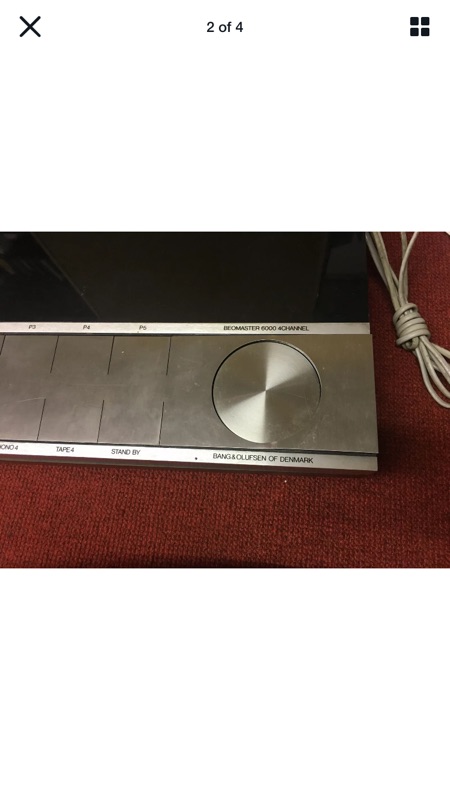

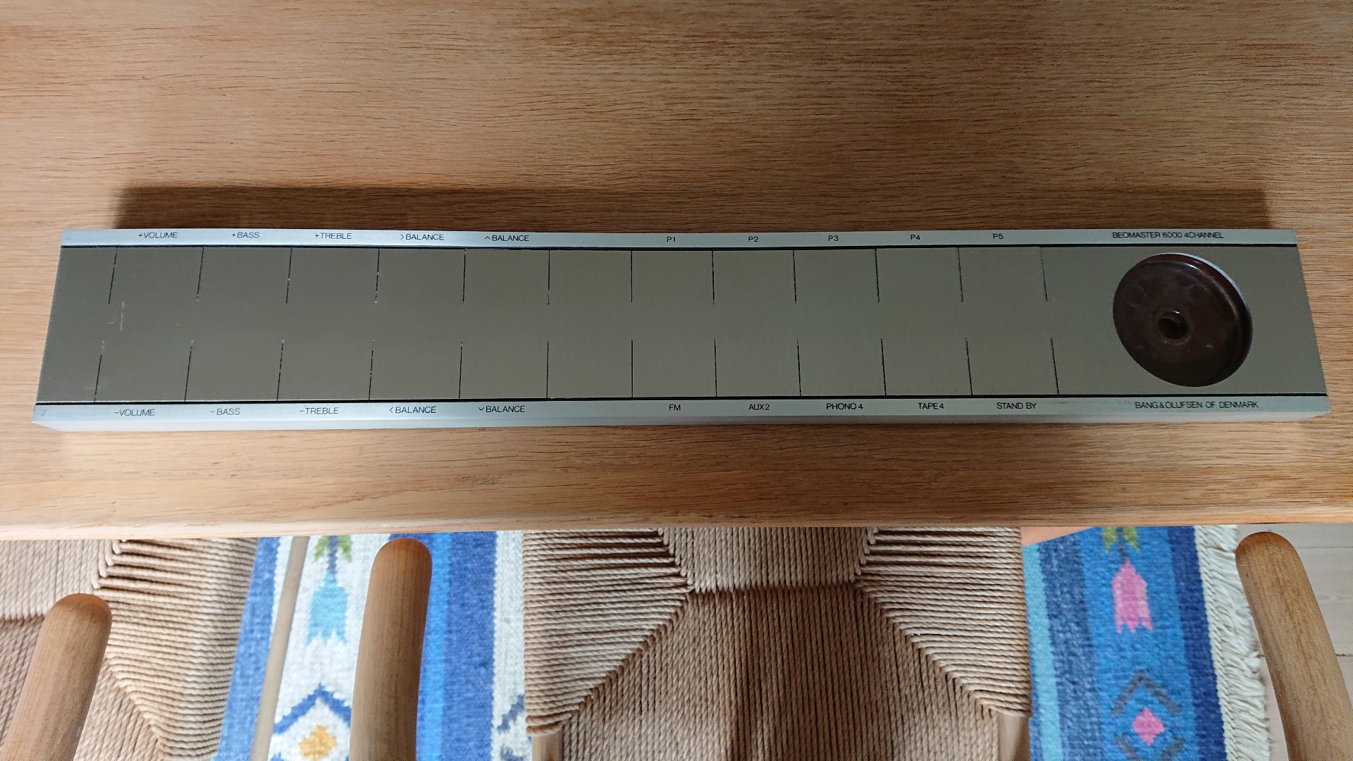

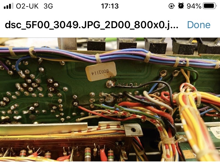

square4
Posts 241
square4 replied on Wed, Aug 12 2020 12:30 PM
Hi Struer.
Here is a picture of mine bm 6000
Henrik.
square4
Posts 241
square4 replied on Wed, Aug 12 2020 12:43 PM
You can click on the picture to enlarge it.
Henrik.

Seems like that black lead is going to the grounding connection. Mine may not have ever been attached unless I’m not looking properly.

Isn't the solder pad you were thinking it went to the same ground?  It looks like your black wire was just attached to a different point on the plane.
-sonavor
Struer
London
Posts 106
More confused now. Can’t find the spot where it came off... and the manual on this section isn’t such a sharp scan
sonavor
Top 25 Contributor
Texas, United States
Posts 3,732
sonavor replied on Wed, Aug 12 2020 7:20 PM
The photo of the same area from square4 shows his corresponding black wire going to the solder pad that is the one near your board sticker.
You could put it there.  It just doesn't look like yours came from that same spot.  Your boards are slightly different.  The pad next to the red wire you originally pointed out looks like that is where it came from. It should be the same node as square4's black wire.
That being said, I would still recommend...Get the service manual out, verify exactly what the black wire is (what it is supposed to connect - to and from), then verify that on your board. You can't go wrong that way.
-sonavor
Struer
London
Posts 106
Very well deduced. I agree, but that pad has never used touched by a solder. Maybe those boards are from slightly different era machines.
I’ll check the manual again but the one I have downloaded from this site is a bit doesn’t have a sharp scan of that board diagram
sonavor
Top 25 Contributor
Posts 3,732
sonavor replied on Wed, Aug 12 2020 10:00 PM
From what I can tell the lead that the red wire is on is the 11C41 positive side (on the output amplifier board).  It looks like the red wire carries 60V from the P7 board. The other side of the 11C41 capacitor is to ground and that is where the black wire goes.
-sonavor
Struer
London
Posts 106
That sounds right as the other end of the black lead is part of a cluster of three black leads that go to a ground post/ terminal.
So X marks the spot then in this pic?
Or a circle I should say
sonavor
Top 25 Contributor
Posts 3,732
sonavor replied on Wed, Aug 12 2020 10:37 PM
That is how I read it.
-sonavor
Struer
London
Posts 106
Yes, with the black lead re attached it means that the lamps on the EL board stay illuminated again when selected, without the black lead connected
the lamps or button don't activated. So that helped and is useful to have re attached.

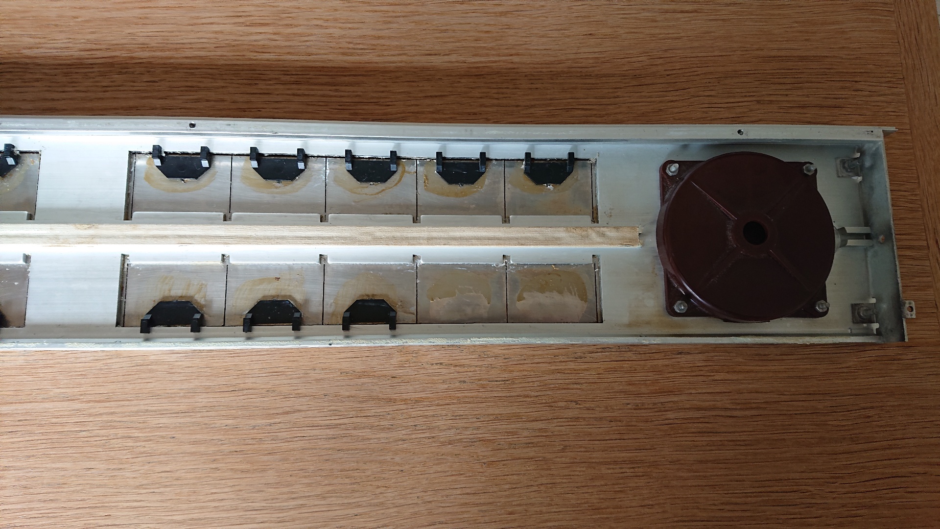

square4
Posts 241
square4 replied on Sun, Sep 6 2020 12:52 PM
Hi Struer.

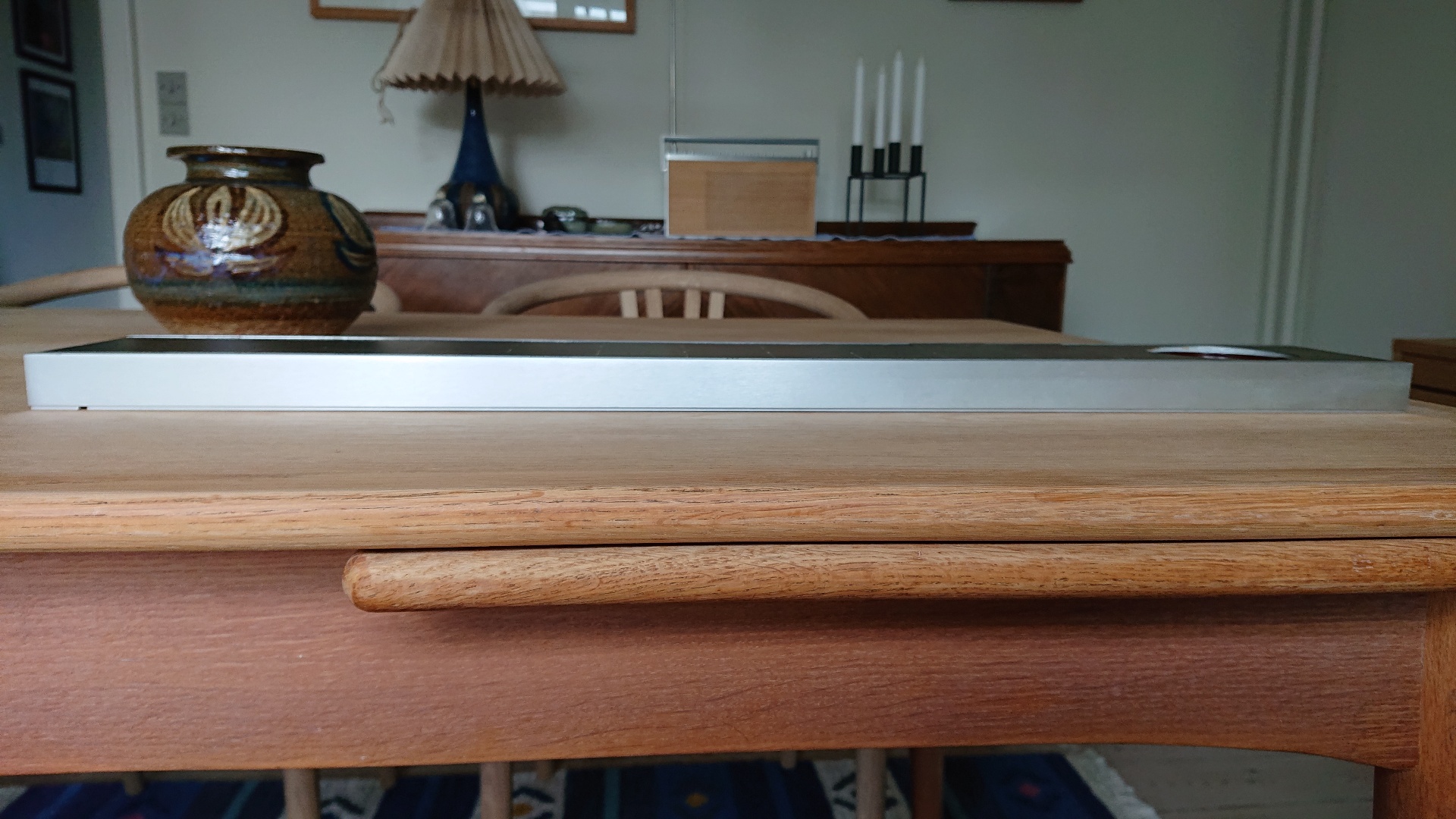

I was almost sure i had a control panel lying somewhere and now i have found it.
It is in really good condition,it has small scratch and on the back side there are 2 plastic pieces missing,but you can take them from your own panel and glue them on.
it is for the last of the bm 6000 models with a hole for a small red lamp which lights up when using the remote control ,but it can certainly be used for both models.
Are you interested in it ?

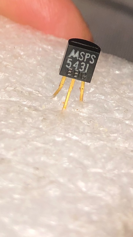

Hi, does anyone know of a suitable replacement for:
MSPS 5431?
Any suggestions appreciated,
S
Dillen
Copenhagen / Denmark
Posts 13,191
Dillen replied on Sat, Oct 17 2020 12:39 PM
SPS 5431 (The first M is the Motorola logo) is a small but tough darlington beast.
Something like MPS A65 or perhaps BC880 (different pinout!).
Martin
Struer
London
Posts 106
Thanks Martin, I salvaged an MPS A55 from a Beocenter is working. Both directions of the motor are now spinning at the same speed. All clutches are activated when any button is pressed on board 13.
