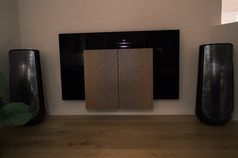

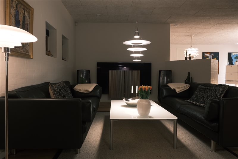

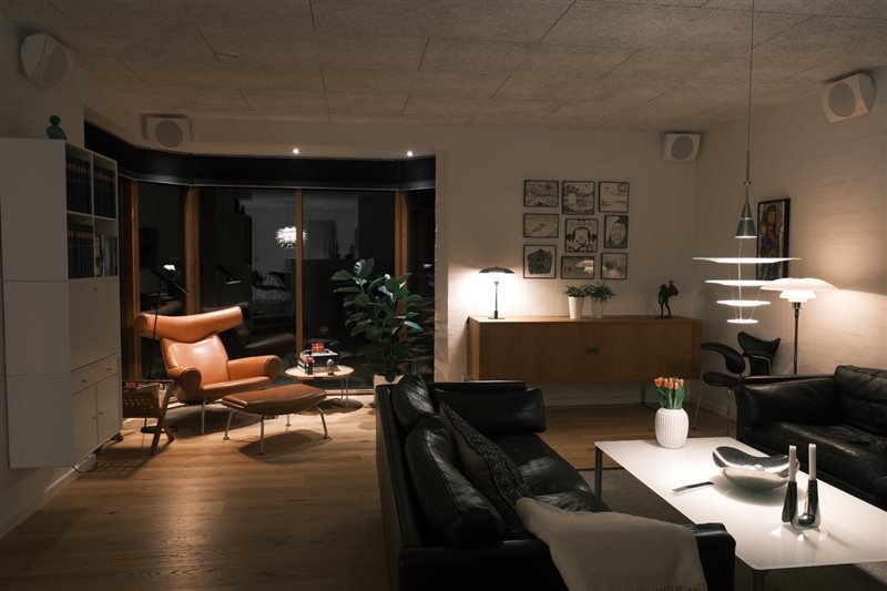

The BL50,BL17 & Harmony have now been installed and I promised to send a photos
1) I will not comment on the sound quality as the whole system has not been calibrated yet.
2) The Panasonic udp 9000 is connected and I am now able to answer the questions I asked originally in this post. Despite the Panasonic manual clearly states otherwise, it is possible to change the settings in the player settings menu so that video automatically is output via HDMI (to Harmony) and the blu ray player will automatically switch to spdif (directly to BL50) when I am playing a cd. That is an awesome feature.
3) However, I have still not figured out how/if I can use my beoremote one to change the volume when I am connected directly to the BL50 via spdif. Currently, I am using the app to change the volume and I would prefer to use my beoremote one.
4) everything in my system is wired - this also applies to my other rooms with BL18’s, Beosound 35, A9, etc. However, I was not aware that the BL50 had to be connected to the internet and I don’t have an Ethernet plug near the speaker. I am not satisfied with the WiFi performance of the BL50. I have a new UniFi system but the BL50 “jumps” off the 2.4ghz again and again. As per point no. 3 above I need to use the IOS app to change volume and settings on the speaker but that is not possible if the BL50 is unreachable. I don’t have this problem when the BL50 is plugged in to LAN.... I would like to have known this when I renovated the house and I am not sure how I will solve this issue now.
5) I am using IR cables to control my ATV4K and the Panasonic. Is this recommended for the ATV or is it better to use BT fir my setup?
6) the Panasonic and my sons Xbox One X is placed behind the wall you see on the last picture.
7) I am streaming music via Deezer Hifi, I am playing cd’s on the Panasonic, and I am also playing music/flac files stored on my Symology NAS
8) all in all I am happy with the setup but it needs calibration and I need to solve the issue mentioned above.
Thank you for your answering all my previous questions
PS. I really like the Halo’s - they are really Awesome!!!
