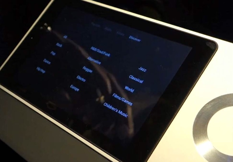

I was wondering, not all to long ago a saw the below screenshot here, displaying the genres on the moment. Do these reflect the standard genres for your own collection on the moment? Or does the moment do its own external database consulting for your numbers to place them in a genre? Otherwise it might make sense to name your genres to this standard. Any current moment users that know the anwser?

That is genres Moment are getting from Deezer. Does not cover the content on e.g a NAS.
