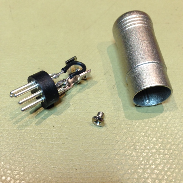

The Aux socket has a fixed voltage out, you have to use the Powerlink socket, or one of them, each carries both L and R. What you need is a plug for the other socket to trick the 9000 into thinking it's hooked up to PL speakers. Without it, it assumes it is part of a Masterlink remote setup and disables the PL audio outputs if I recall correctly.
I think Steve at Sounds Heavenly could get you a plug, or I'm sure someone here knows how to make one and can advise. I haven't seen mine in ages so can't take it apart and advise on what's wired to what.

Yes, I have designed a Powerlink Blanking Plug, which goes into the spare Powerlink socket to make the Beosound 9000 think that it has Beolab speakers connected.  This is needed due to a software issue that tells the 9000 not to respond to remote control commands unless Beolab speakers are plugged in.

The only thing you need is a Din-plug and a piece of wire between pin 2 and 4.
If no powerlink is used, the BS9000 starts in option 0 (A-opt) mode. Re-programming to option 1 will make the BS9000 functioning again.
Every time the BS9000 is disconnected from the mains, the BS9000 has to be set again in option 1.
So the plug is a usefull investment.

Just to clarify - as Wokbelly mentioned that he has Beolab speakers connected to the Beosound 9000 as well as his Klipschorns, he won't need the DIN plug with the link wire.
