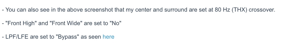

Here are my settings in full (seems like it needs to be opened on a computer) - https://picasaweb.google.com/106757494016008090298/OnkyoSettings?authuser=0&authkey=Gv1sRgCKWb94qtg9ji3AE&feat=directlink
- The speakers of the BL5's (fronts) are set to "Full Band" as seen here
- Subwoofer is set to "No"
- You can also see in the above screenshot that my center and surround are set at 80 Hz (THX) crossover.
- "Front High" and "Front Wide" are set to "No"
- LPF/LFE are set to "Bypass" as seen here

I get the impression that you have set your BL5s to not get any input below 80Hz, and that the LFE is not being sent to them, from the image below, which is your description of the settings you've made.
Which means you should be lacking in ooomph.
You write that your center and surround are set at 80Hz crossover.

Ari - I just had a look at the screen grabs of your setup.
Slide 2 - Go through the options, pick Large for your front speakers, not Normal, if the Large option, or something similar, is available.
I see you have switched Analog Subwoofer OFF. Why? This may mean that the subwoofer signal is not being sent to your speakers. Experiment.
But you need to be certain that you are sending subwoofer signal and LFE signal to your front speakers, and that you haven't configured for those signals to be sent elsewhere.
If you set things up correctly, using THX shouldn't be a problem.
Don't use Dynamic EQ or Dynamic Volume, leave these OFF. You want as straight a signal as possible to the speakers, from the source, as these are full-range and fully capable of delivering the audio, when not constricted through faulty set-up.
Using room calibration shouldn't be a problem. (I do wish that the BL5s came with a reset to normal level feature, one can reset them to a factory calibration, but that's just one that fits a listening room in Struer, if I remember correctly. The built-in room calibration that fits them to the room they are in is useful, but you don't really know whether you are getting the best they can do.)
That said - I had my BL5s set up for movie playback with such power and throw to the audio that the representatives of B&O who came to have a listen were worrying about structural faults appearing in the walls of my flat. My downstairs neighbor at the time could attest to this - his china was moving along on his shelves when I watched a movie. I adjusted the volume after learning that, but he came to watch movies, and then we turned things up. Those speakers can produce amazing audio if fed the correct signal, that uses their full range capabilities. I didn't do anything particular with my processor to get that result - the speakers were fed through LINE IN from the PRE-OUT, and the processor was set up as I mentioned above:
Most processors give you the option to switch off their internal amplifiers, if they are equipped with such. You don't need that, so just select PRE-OUT ONLY.
1. Front - LARGE (or whatever other description is used in the processor menu)
2. Subwoofer - NO
3. Subwoofer signal to Front Speakers
4. LFE to Front Speakers
5. No Dynamic Compression or Dynamic EQ - not necessary with these speakers)
