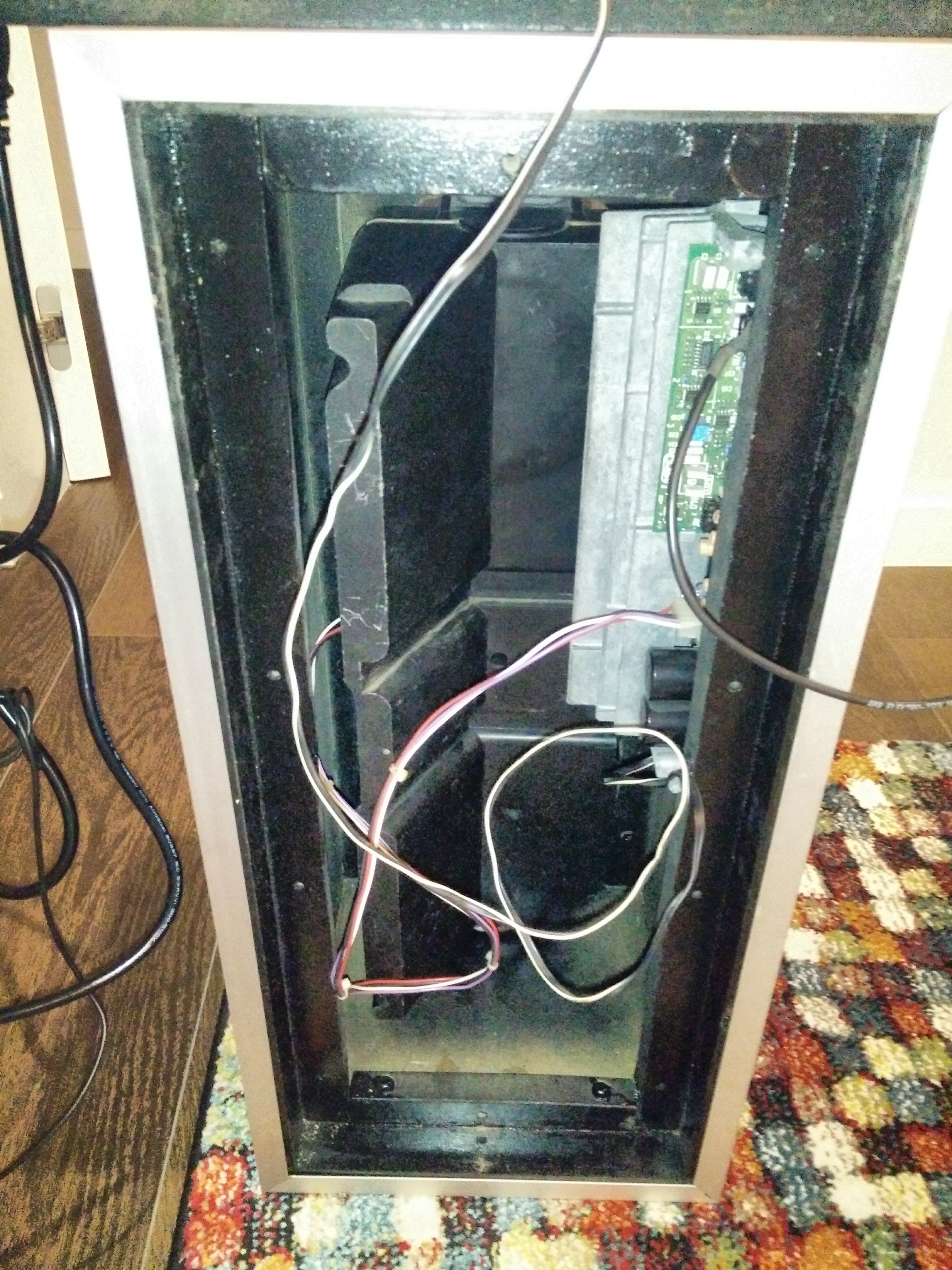

I just removed the speakers + crossover + amplifier units from a beovision Avant.
I'd like to buy a power source for these amplifiers. But i don't have any clue how much Volts and Amperes it should provide.
In the picture are the connections shown. Is there anybody who knows which pin on the left side is + and - for the power supply? Or isn't it the left connection?
Also There are 4 pins on the right (audio?) Connector. Can someone tell me which pin is which? (left/right/ground/??).

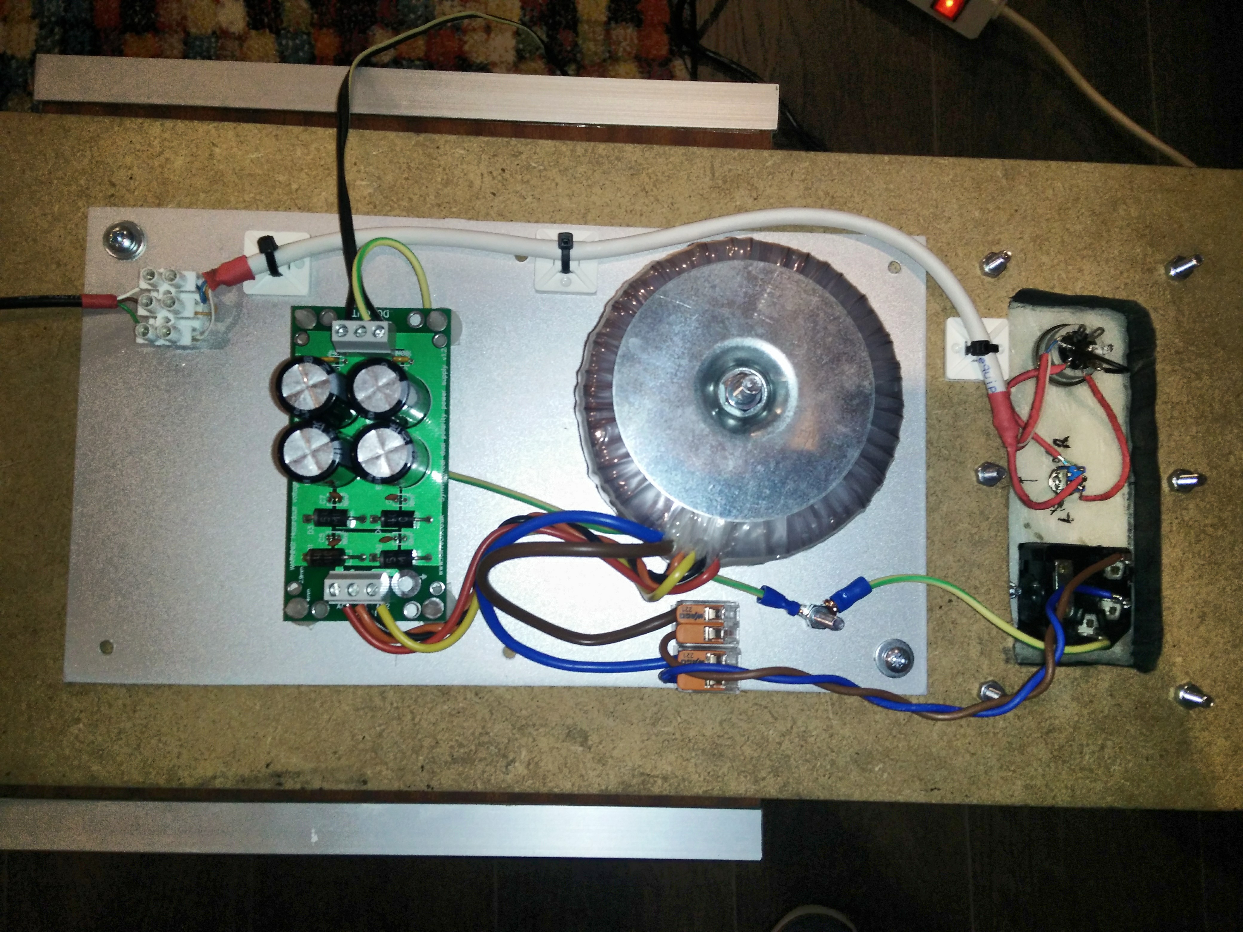

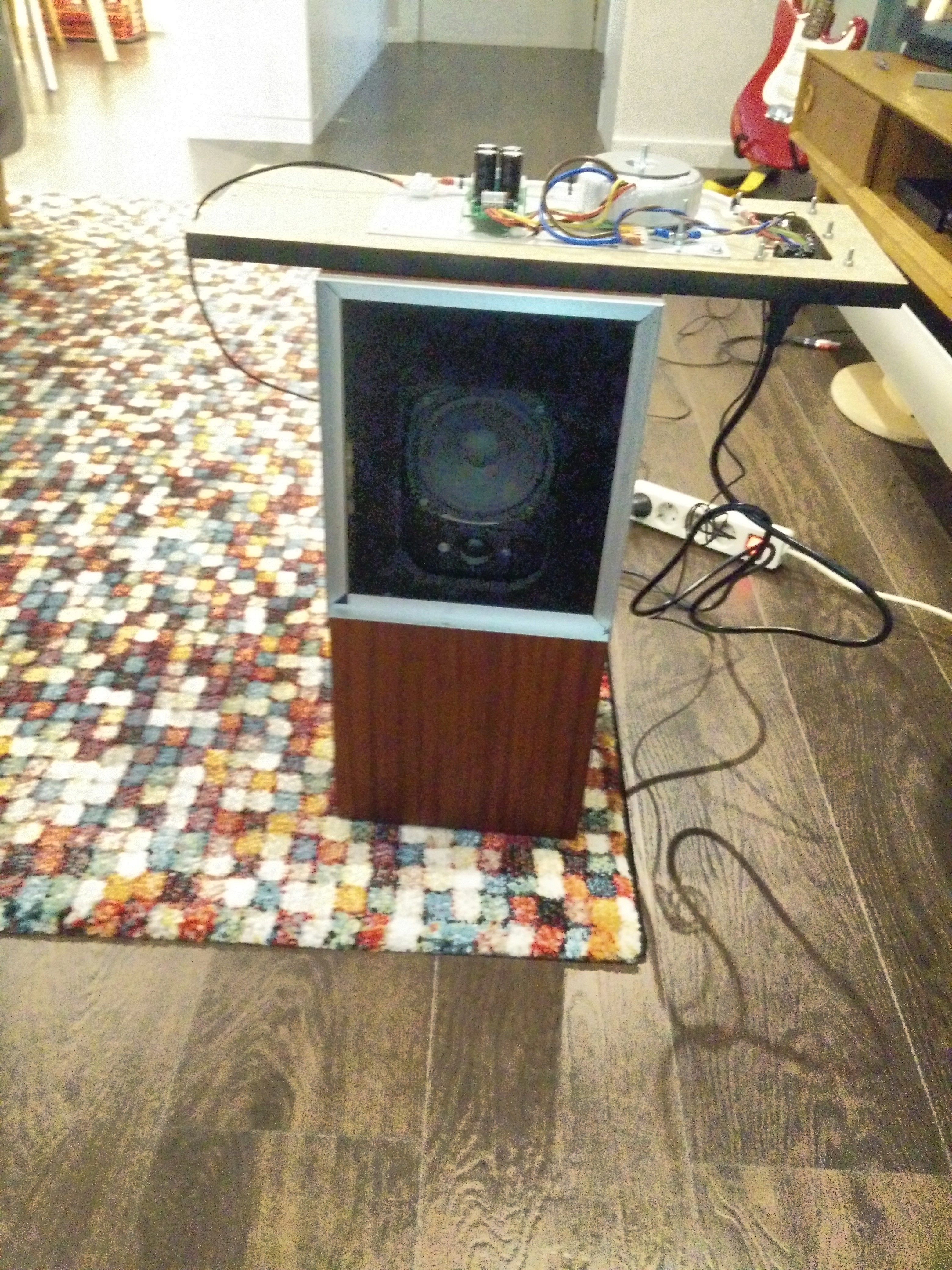

Finally managed to get a clear sound from a project like this...
Was given the amplifiers and speakers from an old avant
With the help of beobuddy diagram i got a suitable transformer from an online store here in europe and a power supply pcb from eBay. If it's not against forum rules i'll post the links to where i bought them.
https://youtu.be/6dL2h1SfU8c
Any comments on circuit are appreciated.

BEOVOX141 replied on Sat, May 18 2019 10:37 PM
Hi Duarte.
Nicely done, complete with the classic B&O aluminum trim! It goes to show that one mans trash is another mans treasure!
All about attitude and imagination!
You now basically have a Beolab 4000, since it really is-  the Avant speaker.
I dont see any fuse anywhere, which really is mandatory for all the right reasons! The rest is pretty much by the book! You even included a left, right switch!
To bad you already cut the big hole for the speakers, the extra volume you have available could properly have improved the system.
How is the sound? You actually put a ported system into a sealed box, what happens when you close the box ?
Anyway,-  Congratulations on a speaker for life Lets have a Party !!!

Nice Job! I just got the same modules from my fd TV. how many AC Volt output of the transformer you using to get the DC +- 20v? thanks share that!
