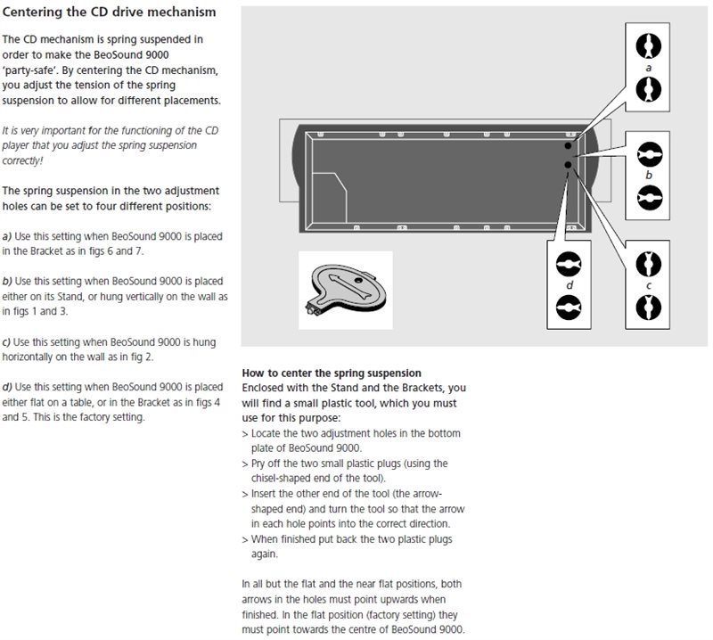

Hi, I have moved the position of my BS9000 from horizontal to vertical and now it is not playing properly
Any advice would be helpful.

Have you adjusted the position switch to the vertical setting?

Sorry to hijack the thread, but hopefully I'm still on topic: is there an alternative to the red plastic key? I recently bought a BS9000 and it didn't have one. Could I use a small flat-bladed screwdriver, or something else?

Yes you can use any thing that fits the slot. Large headed screwdriver /coins etc
