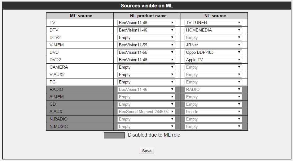

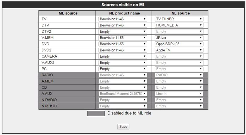

Now when the BC2 is gone, I want to access the Radio source on the TV from my Link speakers, but nothing happens. (It plays over the BL11 when I press RADIO in the main room)
I tried to change the NL/ML converter role to both A.master and AV.Master but no change. (It was V.Master when the BC2 was in the network.
Does it matter that the ML socket that use to be connected to the BC2 is empty (not connected to anything)?

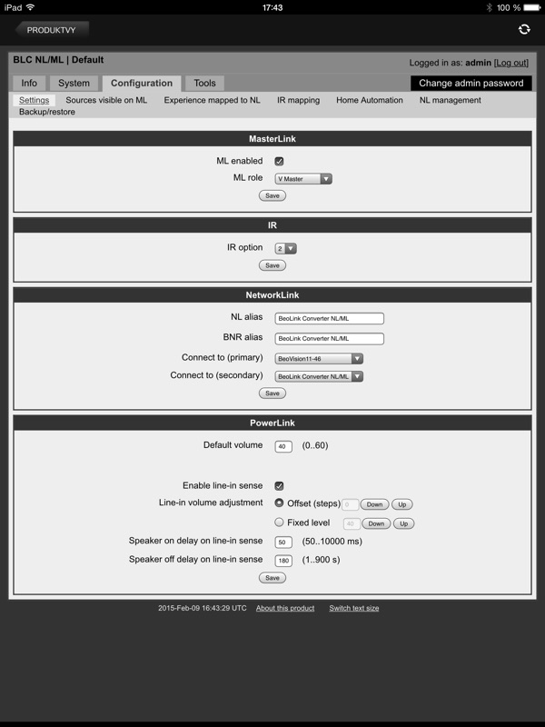

I´ve set the NL/ML as V.Master. In the view "Sources visible on ML" the ML Audios Sources are greayed out, and the video sources are not. Is that what you mean?

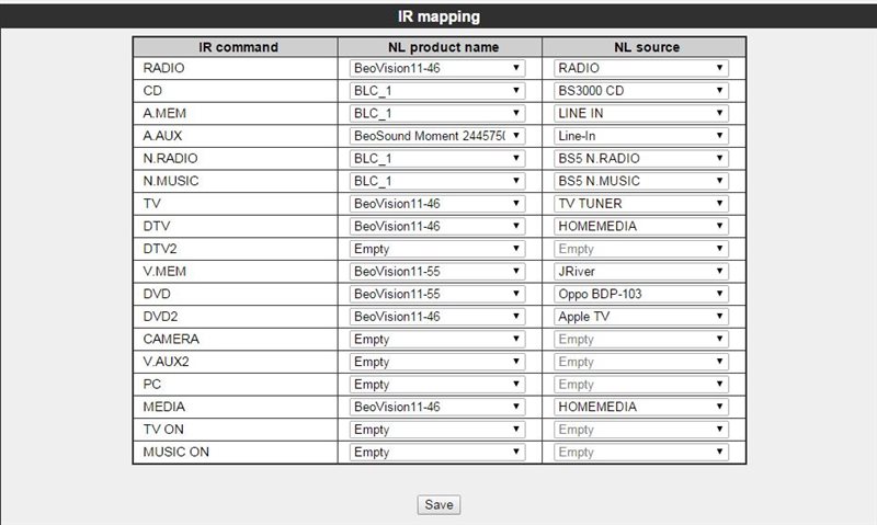

But you need a workaround. First you take a BEO4 who can give the command DTV2, A-DTV2...

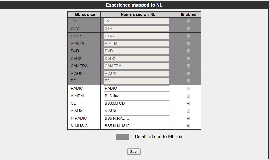

Important! You can not assign the remote's radio button to the TV radio source anymore. Asign a new button for the TV's radio source for example DTV2 (it has to be a video source button). Next do the following in the converter: (Stay on V-master, No problem with a loose ML-connector.)
IR mapping: DTV2 > Beovision11 > Radio
Experience mapped to NL: Radio > check off the mark (very important!)
Sources visible on ML: DTV2 > Beovision11 > Radio
It should work now when you push the button DTV2 on your TV & BL 3500. Remember if changing sources on the TV itself, the Radio will also be lost in the link, (! Only 1 source can be activated at the same time on your BV !)
The BL2000, (old software for DTV2?) but you can make it part of the ML by pushing these commands: the Mute button if the BL3500 allready plays, or first Mute and then choose DTV2, if nothing is playing (or maybe A-DTV2 is also working, give it a try on the BL2000, I haven't tryed).
Now it should work, remember it takes some time before you hear your TV radio source. The NL source needs some more time to start in comparison to the ML audiomaster.

thats correct in this setting. Be sure you have UN-checked the RADIO box in "Experience mapped to NL".
And assign the right source to the right IR command in the tab: "IR Mapping"

No luckSad
Here are my settings.
Nothing happens at the BL3500. Not even accessing whatever is played on the masterlink.

Hiort, do you have something connected to the USB of the NL/ML converter (the 000.000.000@.......... IP address in your setup).
Maybe you should do a reset of the NL/ML converter. Something is going wrong there!

Hi,
you have to use a Beolink Converter type 1611 . This gives you the necessary 'Audio Master' on the Masterlink Bus, if no other Audio System is connected to.
Connect your iPod with a headphone plug / DIN cable (best choice to buy is soundsheavenly who is a sponsor of this site) to the Audio AUX Link connector of the Beolink converter 1611. With the Beolink 1000 / Beo4 /5 /6 you activate a videosource (TV, SAT, DTV, V-Tape,DVD....) and the converter puts the signal from its AUX Link onto the Masterlink Bus and the Beolab 3500 give you the sound Smile
HHH
Posts 10
HHH replied on Tue, Feb 10 2015 11:21 AM
Sure - if you added a TV with ML (would be v option 2 in your case) then you have the "Current Master" covered and now you can make the NL/ML BLC your "Audio Master" and now you can activate the line-in from the BLC on your ML and NL rooms (just login to the BLC and map the line-in to a source command of your choice that's compatible with your exciting ML system
You could also choose to route the sound thru the ML TV and distribute that way, but then you would have to deal with delay/Ecco between ML and NL rooms (you could also pull the sound from your NL TV)
The simplest "Current Master" is the old AUX-ML Converter this would do the trick also (just remember to power reset it after you configure your NL/ML BLC role as Audio Master) as depend on what version you have it can auto configure it self as either a Audio master or Video master based on what it sees already excist on the ML
Really endless possibilities :-)
hope the info is helpful

Hiort replied on Tue, Feb 10 2015 12:30 PM
Thanks everyone for providing inputs for my problems/challenges.
I thought it would be useful to summarize some of the findings, for others thinking of replacing their Audiomaster with a Moment:
  1. You need an Masterlink Audio or Videomaster in the system. Otherwise ML will not work at all, since nothing is providing current into the ML.
  2. NL/ML Converter does not fulfill that function.
  3. Simplest way is to add a Beolink Converter type 1611 on the ML side. That will feed the current needed in the ML system.
Back to my specific configuration:
Adding the Beolink Converter will solve my number one usecase:
Pick up whatever is played out on the Master link, on either BL3500 or BL2000.
Number two usecase is being checked by B&O:
Press RADIO on the remote in linkroom, and have the "Radio source" on Moment (integrated to a BV11) to play out on the ML.
I have confirmed with my dealer that a Moment integrated with a BV11 respond correctly on a RADIO command from a BEO4. Its possible to configure CD to trigger e.g MUSIC on Moment.
Question is still if the Moment will react to a RADIO (or CD) command sent from ML over a NL/ML converter, over the BV11. As said above, the question is sent to B&O support.
Hiort
Sweden
Posts 2,895
Hiort replied on Fri, Feb 13 2015 7:52 AM
Update on my issue:
Added a Beolink Converter type 1611 instead of the Audiomaster i removed. Just plugged in the ML connection I used for the BC2.
Now everything works as before:
I can press TV on my remote from a linkroom and play TV sound over BL3500.
I can join music played from A.AUX source from NL/ML converter  (from my Playmaker) from linkrooms. (Pushing PLAY buttion on BL2000 or MUTE on BL3500).
I still cannot access anything played from Moment. Moment is not putting anything out on the Masterlink (or NL/ML converter is not). As I understand replies from B&O Customer Service, this will be fixed in the upcoming "multi room release" .
