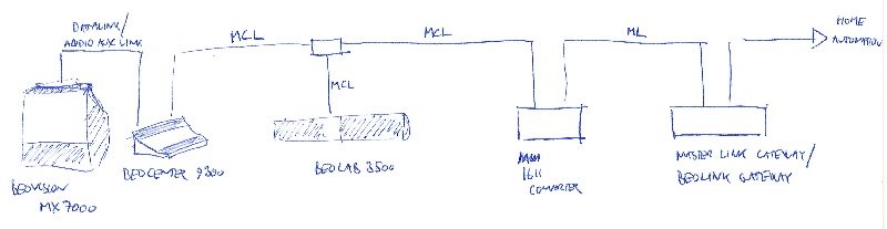

The reason I am asking is that I have an idea of building a setup like this, as I have some of the products already:
  • Home Automation System: Schneider Electric LK IHC Control
  • MLGW / BLGW
  • 1611 converter
  • Beolab 3500 (with MCL port)
  • Beocenter 9300
  • Beovision MX 7000
something like:
  1. Is something wrong in the above picture?
    (e.g. should the 1611 converter be placed between the BC9300 and the BL3500?)
  2. Will it work at all?
    The main purpose is control the B&O equipment from the Home Automation system, not vice versa.
  3. What can be controlled from the MCGW/BLGW?
    - Will I be able to control the TV? Turn it on/off? Change sources?
    - Will I be able to control the BC9300? Turn it on/off? Change sources? etc.
    - Will I be able to control the link room Beolab 3500?
  4. Would anything require a BLGW instead of a MLGW?
Any feedback appreciated!
Best Regards,
Jakob

The problem becomes one of transmitting the "LIGHT" and "CONTROL" commands. Even many fairly recent ML products require a software update to enable transmitting those commands. This is the case with the older BeoLab 3500. My dealer has told me that the parts needed to update the older BeoLab 3500 are no longer available. Some people have found a workaround solution by placing a BeoLink Active in the same room as non-compatible products. Note that what we are talking about here is the ability to receive and transmit the 'LIGHT" and "CONTROL" triggers. Any product would still be able to execute the actions resulting from the triggers from macros.

So, if you don`t have already installed the MCL cabling, why not use Masterlink ?
This way you can connect the MLGW and BL3500 directly to ML, the BC9300 with 1611 converter and the BV MX connected to ML via Beolink Video (1615). This would be a more "future proof" setup...

I just realised that the 1611 does not convert MCL<>ML, but rather Datalink<>ML.
This spawned a new set of questions, though... Argh.
