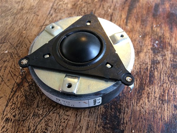

Hi all, I have a pair of beovox RL 60.2, and one of the tweeters is not working. The small red coil is not connected to both wires, looks broken. Does anyone have a spare one, preferably two to make sure they sound the same?
I am in the Netherlands. I am not sure if I need just the tweeter, or also the whole magnet part, making it of course much heavier for shipping.
Advice to repair the coil - of possible - is also welcome of course. Thanks in advance!

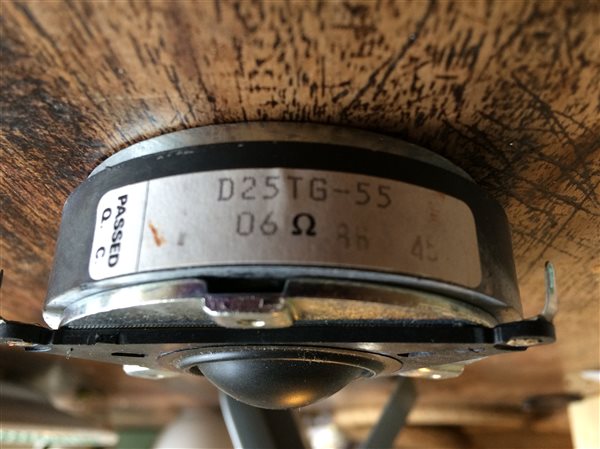

It does not really say, can you tell from the photos? I took off the outer ring to see what was going on inside.

That's a VIFA driver but not one I've seen before in RL60.2.Are you sure, these are RL60.2 ?Any signs of "bodging" ?
I don't think so, it looked like I was the first to open this one up. If you unscrew the top ring from the one on your beoparts site I am pretty sure you'd see the same, right? I will need to check the label, but the ribbon on the front says 60.2.
I think you're right.Being a 6 Ohm driver, I think the VIFA version would be the best match (The SEAS is 8 Ohms).
Dillen:I think the VIFA version would be the best match
