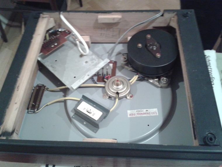

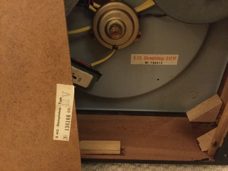

Opened it up this evening and found no preamplifier despite the label stating it is a VF model. But the mystery goes deeper as the serial number on the chassis does not match the one on the wooden lid so at some point, perhaps during a repair the panel must have been replaced!
What made this even more confusing was that it arrived in a box for a Beogram 1202!!

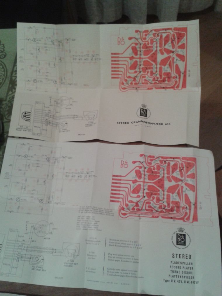

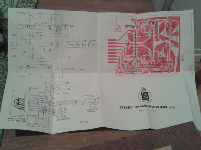

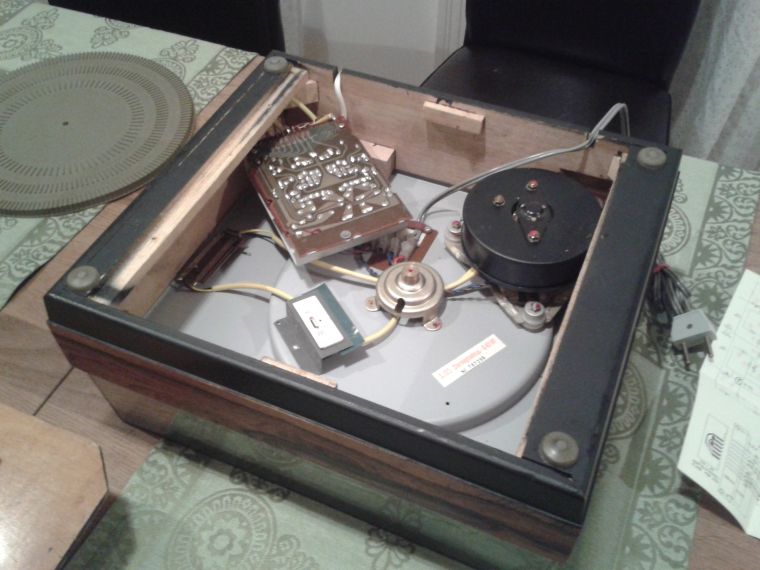

I can confirm this also on my 2 “42VF” turntables. The first one has 42VF at the round mark at the top, then 42VF sign at the bottom sticker and inside of case but inside of the envelope it has the schematic of “Stereo Grammofonvaerk 610”. It came with original user manual saying Beogram 610?!

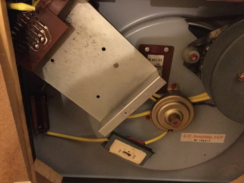

The second one is even more confusing saying 42VF at the top sign, 41VF at the bottom sticker and the same at the sticker inside of the case but with “right” schematic in the envelope, saying “Stereo Pladenspieller Type 41V, 42V, 41VF and 42VF”. This one has a normal (bigger) platter so it cannot be the 41 version. And it does not have the RIAA preamp (so it cannot be VF Version)!

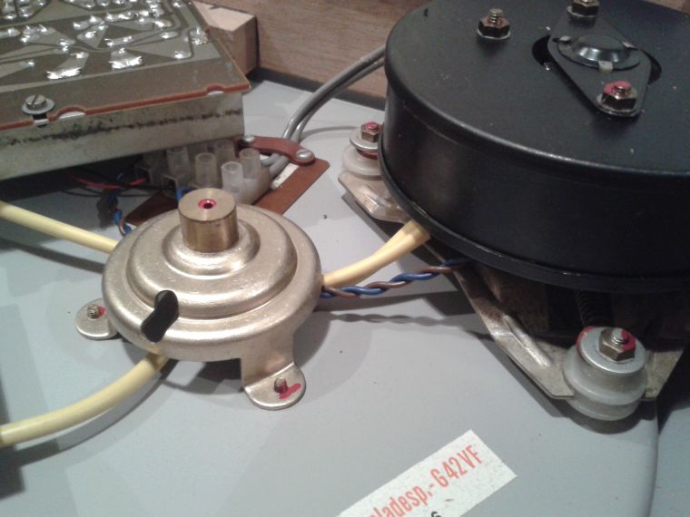

I have third 42VF in my storage waiting to be repaired but never looked to his bottom or inside of it. I am sure I would find new special version of it Smile
Here few pictures:
The first one...
And the second one:

Preamplifiers come and go. They unplug and plug back in easily to suit the given setup. I wouldn't trust anybody to add an F to the
stickers inside and at the bottom plate when installing a preamplifier. :-)
And I wouldn't be surprised to find schematics and the likes from another practically identical unit. B&O could have done it but it could
also have been mixed up in repairshops - bottom plates swapped and so.
An upgrade to a larger (better, smarter, modern) platter could easily have taken place as well.
