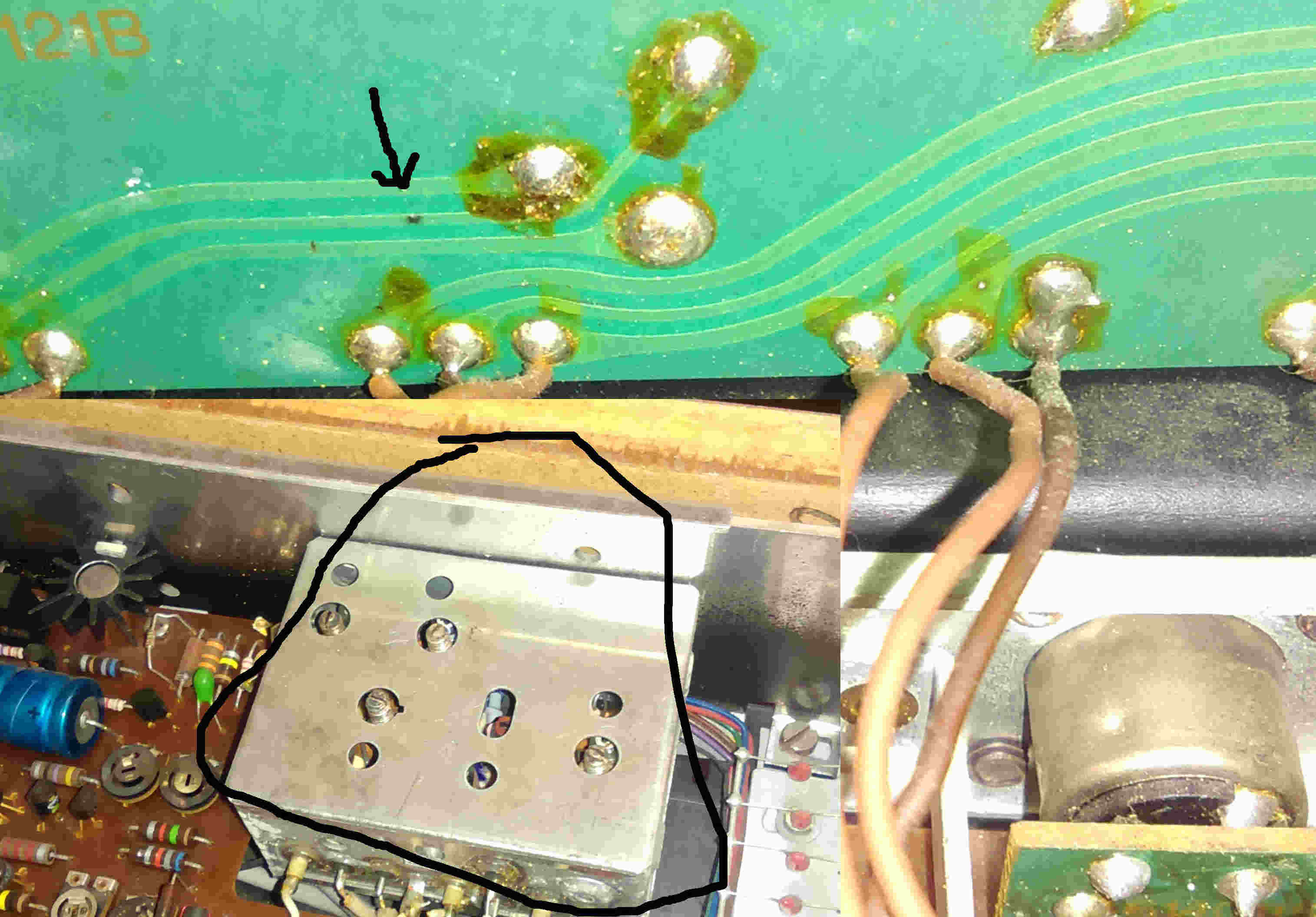

Hi,   this 3000-2 had an intermittent channel.  I found that if I pressed the PC board in the center of unit with many, neatly arranged caps on it , I'd get the channel back.   However,   while investigating this,  a bare piece of wire on the workbench touched the vertical circuit board near the back of the unit,  and grounded to a metal shelf.  Where that wire touched the vertical circuit board, I got a spark that left black spot on the trace, which I indicated in the picture with the black arrow.   That made it no longer possible to get that intermittent channel to work.    The unit was still playing the other channel, and I was moving knobs around,  when a flash, pop, and smoke occurred, coming from the silver box circled  in the picture inset.   Please click on photo to get full picture.
Do I even try to figure out which components I fried?   Is it worth trying to track down the bad components and fix the unit?    THanks
