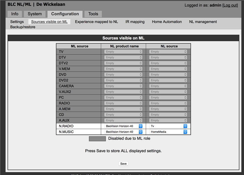

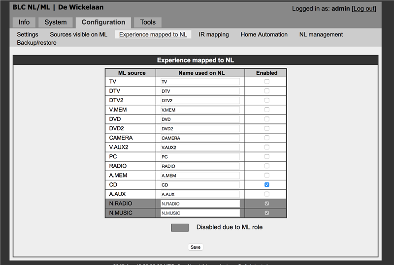

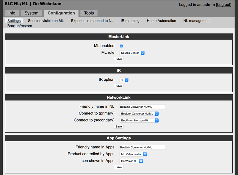

I have a BeoVision Horizon 40", with the latest firmware update, connected via NL to a BeoLink NL/ML converter to the rest of my ML network.
For my installation are 2 things important:
1. I want to distribute the sound of the Horizon to the audio master (BeoSound 5) both are in the same room
2. I want to distribute the sound of audio master (BeoSound 5), which are CD and Radio to the Horizon, again both are in the same room
I have tried many settings of the BLC NL/ML, but I can't get it to work, who can help me with the correct settings?
I have attached an image of my complete system and screen shots of the BLC settings menu's.
Your help will be appreciated very much.

Hi!
I am not an expert on BLC, but try with something like this:
App Settings:
  - Friendly name: BeoSound 5
  - Product icon: BeoSound 5
  - Product controlled by Apps: ML AudioMaster
MasterLink:
  - ML enabled: checked!
  - ML role: Video Master
Sources visible on ML:
  - You should use some VIDEO sources as "ML Source" and map them to your TV sources.
Experience mapped to NL:
  - You should be able to select CD and Radio after you changed the ML role.
Best.-

I`m also a newbie to BLC NL/ML. I just read the manual and got my first BLC a few days ago. But as I can see, a setting with a ML role as audio- or videomaster can`t work, because you have already a BV9 master and a BS5 master.
And there are some points, that I don`t understand with your setup.
- you have a BS5 in A.OPT 1 set to audiomaster, but no Beolabs connected...? can`t work - or did mean A.OPT 0?
- You have a full cinema setup in your livingroom and an additional BL passive in L.OPT 5?  may result in conflicts with ir commands...?
- Your ir setting is set to OPT 4 - why?
- are you using the BLC with an ir eye?
- Can you elobarate a bit more, what doesn`t work?
Stefan

There where a few minor errors in the picture of my setup, below you find the correct setup. In principle I have a perfectly working ML system. Just recently I added the BLC NL/ML converter with no speakers attached and the BeoVision Horizon.
All I want is distribute the sound of the Horizon to the BeoLab 4000's, which are connected to BeoSound 5 and both are in the same room.
Also I want to the sound of the BeoSound 5 distributed to the Horizon and if possible also the interface displayed on the screen of the Horizon. All these things were promised by B&O when the Horizon was introduced months ago.

That`s exactly what i think - create a linkstation for the kitchen - set BLC to A.Slave with BL4000s connected to BLC instead of BS5. Set BS5 to A.OPT 0, BLC to OPT 2. Now you should be able to control all ML devices with BL4000 sound in that zone, and you should be able to control the NL-BV connected to BLC again with sound on BL4000s (?).
NB: If you set your BS5 to A.OPT 0 , it will turn on the BV9 Beolabs, when you control BS5 directly.
BTW: BM5 has a second video output (DVI) for a BV. Did you try to connect it to the Horizon?
Stefan
