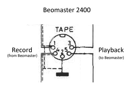

I believe the Beocord DIN plug (which is what the Beomaster 2400 supports) has this pin out
PIN 1 = Tape In Left
PIN 2 = Ground
PIN 3 = Tape Out Left
PIN 4 = Tape In Right
PIN 5 = Tape Out Right

Looking at the cable description again I realized they state their pin assignment is going clockwise PIN 1 through PIN 5. If that is really the case then their PIN 3 = DIN standard PIN 2 so the pin assignments would be correct. I wonder if that is really the case.
Here is the Beomaster 2400 Tape DIN jack
If your cable wiring matches the diagram then it should work.
