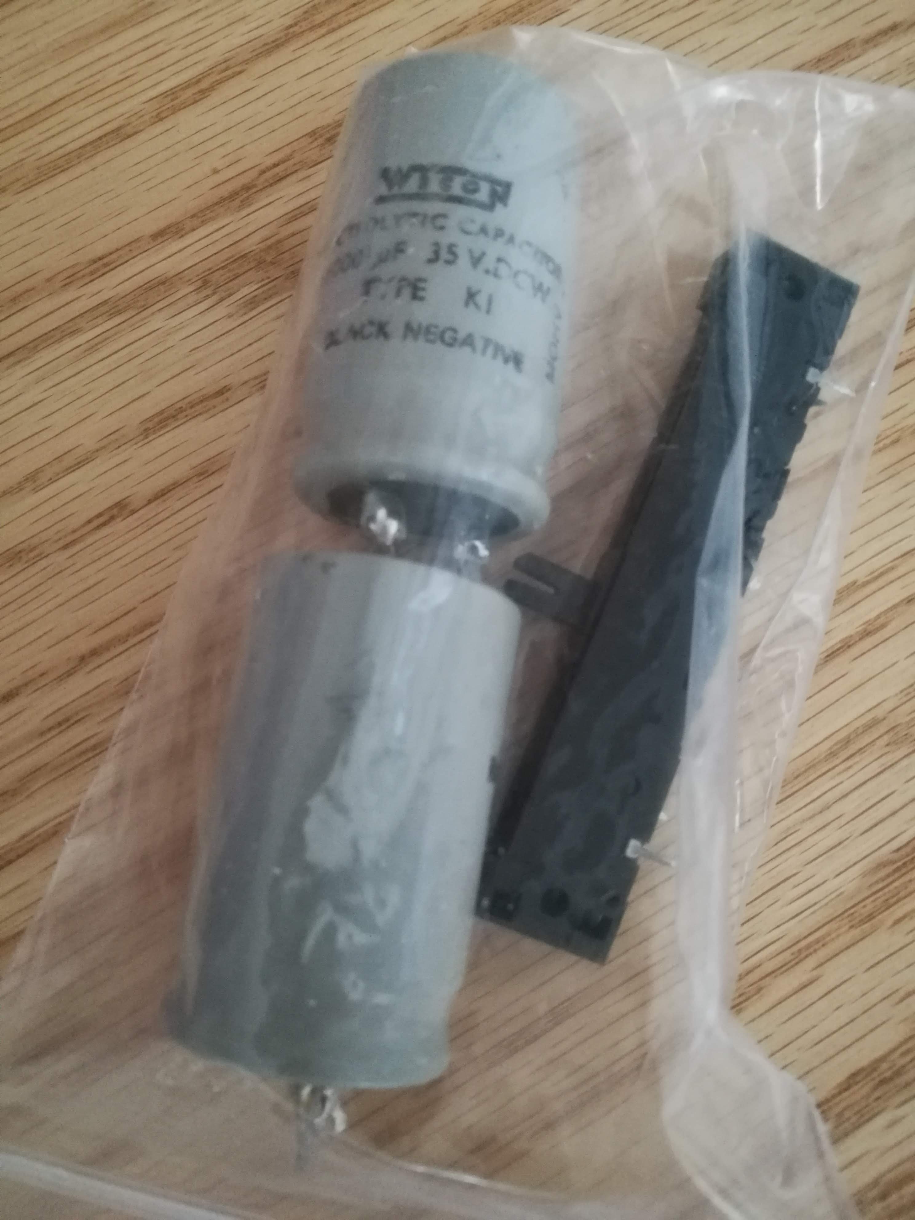

Just an update, even though it has been a while... Shortly after I wrote the above posts about the hum the front right channel went out, so I took the Beomaster back in for service. It just came back, it took six months (the vintage audio people around here seem to be overwhelmed with the amount of work they get). They replaced the balance potentiometer with the one I got from Martin and also changed the filter caps - they were the only capacitors that were not replaced the previous time.
Thanks to the new potentiometer channel #3 is back.
