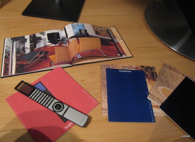

but the one in the pictures's not your new one, is it? I played around with mine a little today and found out that is only the one way version. What a shame! Can it be that the two way version doesn't have the Dolby Pro Logic? It reads like it in Beoworld... Since mine was the center of a surround environment, that could explain why it's only one way. In that case it wouldn't be meaningful to grab another two-way one.

Manbearpig:
No, it isn't, just wanted show you the manuals I have for the AV9000 system. The AV9000 I have now still has to be installed, other things have priorities now like Beovox S75 I got and has to be cleaned to make them as new again. Hopefully in the next few days I will finish my AV9000 setup including all accesories....Pictures will follow!
