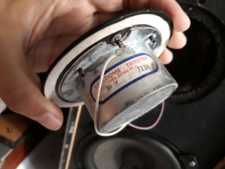

I have a single Beovox 2702 speaker with defective tweeter. Can this tweeter type be found in any other Beovox speakers?

To be more precise, my faulty Beovox 2702 is type 6232...

Two different tweeters were used in production of Beovox 2702,
see here:
https://beoparts.com//?s=tweeter+2702&search=Go

Thanks Martin for this information.
I will take out the tweeter to see which version I need.

It is a 3 Ohm version...
I hope you have it still Martin... E-Mail follows ...
