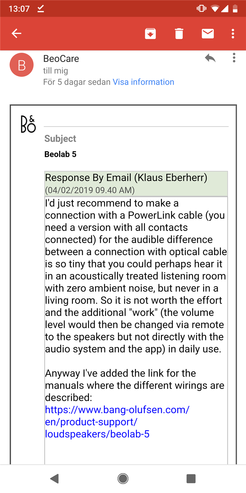

Actually, i had the same question.
Iam driving my bl5s through a premium dac in to aux on a bc2 and then i got curious to feed them directly with digital and at the same time use the powerlink all made possible by the beosound core.
So i had some questions about the setup and contacted B&O support.
And got this surprised answer...?
