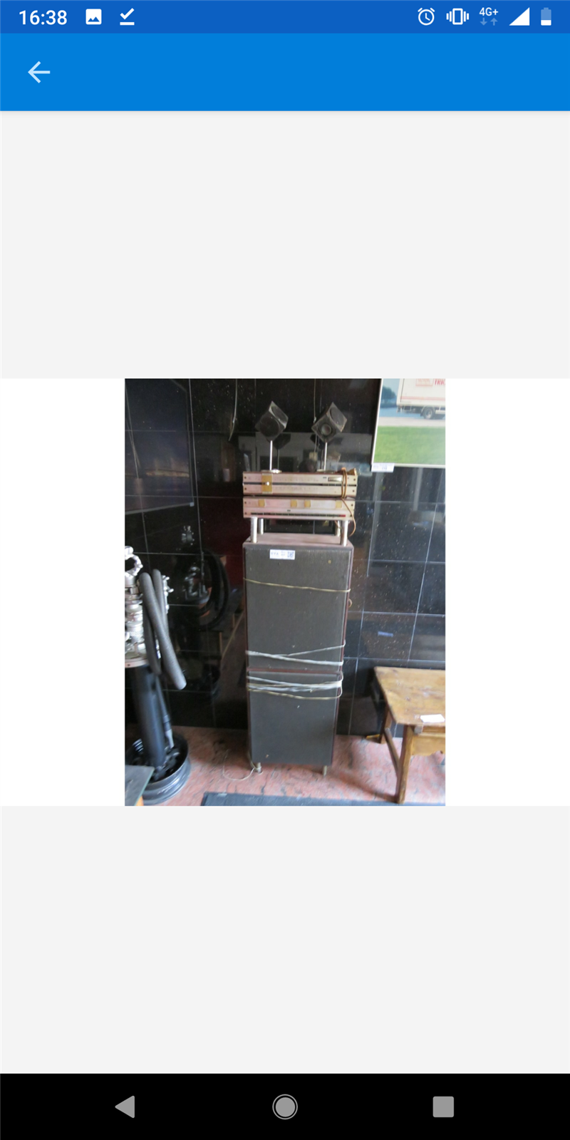

Searching on this auction site I stumbled upon a Beolab 5000 system including Beolab, Beomaster, a set of Beovox 2500 cubes and a set Beovox 5000's.
After a few days of keeping track of this item, still no-one had made a bid, so decided to make the lowest one possible, the auction still going for 5 more days.

This is what I can tell about the pictures on the aution site (I will probably upload them later).
The Beolab/Beomaster 5000 is not tested and looks like it has been in a very smokey room. (The sliding points and cable are orange/brown. Yes I will definitely buy these by Dillen or Classic :) )
The Beovox 2500 cubes misses a cover and they had some broken corners.
The Beovox 5000 seems to be turned yellow to overtime due to smoke (I don't know yet which type these are).

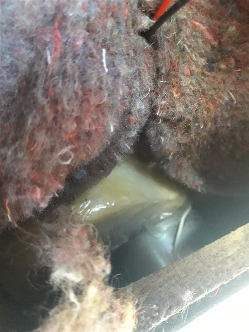

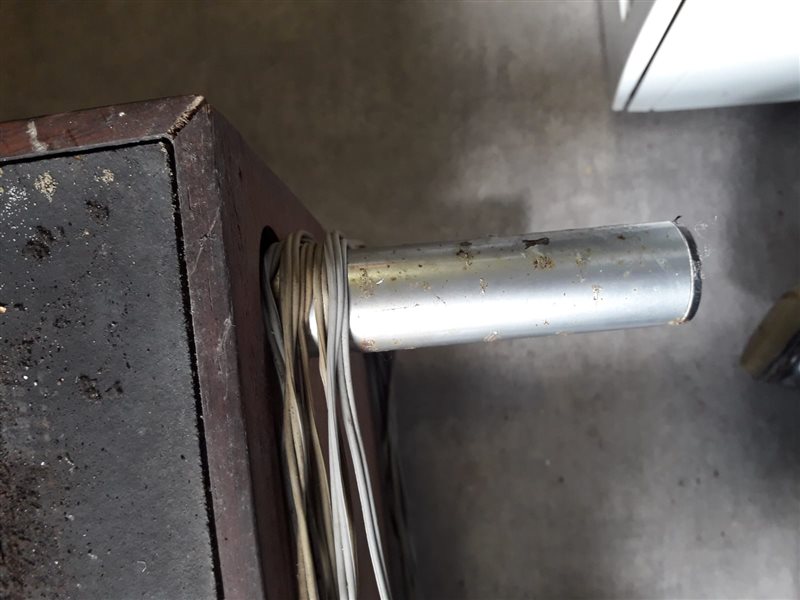

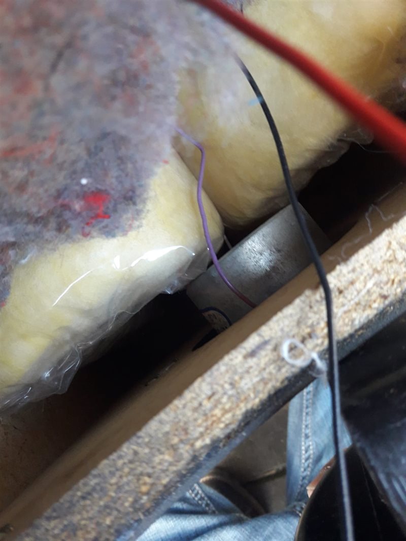

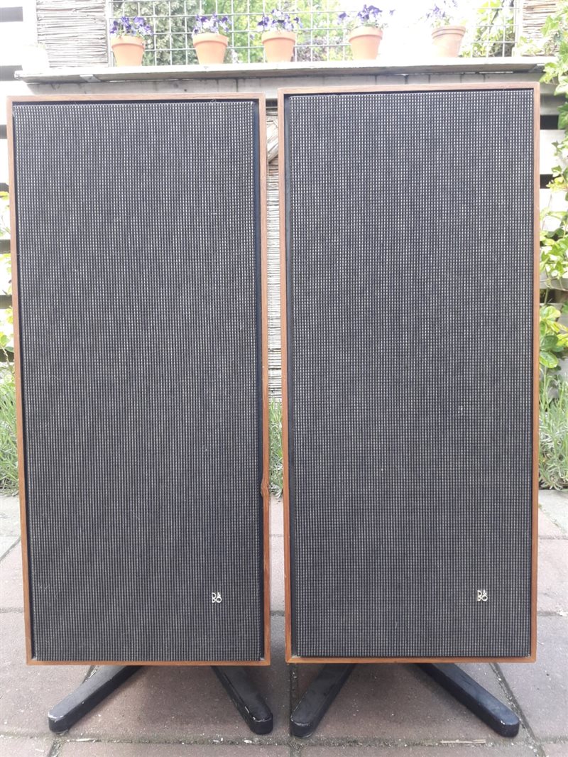

today I bought the Beovox 3000 speakers and I noticed a weight difference between the speakers of 0.7kg.
Could anyone explain this?
As I'm using only one as centerspeaker, I probably have the other one as spare. Can I make anyone happy on the forum?
Here's also the picture of the auction site

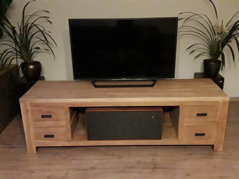

I'm already very happy with this result! The table is already sanded, I'm awaiting the Beovox 5000's so I can decide which color will suite best.
Any other suggestion than a rubber mat against vibrating? Maybe "locking" it by putting something between the top of the Beovox 3000 and the table? Or should I just put it in the floor?

congratulation to your new Beosystem 5000, it is very nice stuff. Beoworld is the best plate to discuss it here. I entrusted renovation of my BL5000 to Frede Cristensenm (Classicaudio), you can find his VERY high credibility over this forum. I can help you very little.
Yellow color of sliders is not because cigarette smoke, it is just because aging of plastics from 1968. Worth to replace.
Beovox 3000 was recomended as centre speaker for this system, but type 6238.

Sad to hear I drove 1000km for the wrong speakers, but we had fun. I know the 6220 doesn't have the midrange speaker. The pictures below are from the English user manual and they mention the 6210 as centerspeaker (these had midrange speakers too). Of course compared to the 6220, the 6238 is the closest to the 6210, but I'm curious how you get the information the 6238 was recommended for the Beolab 5000.

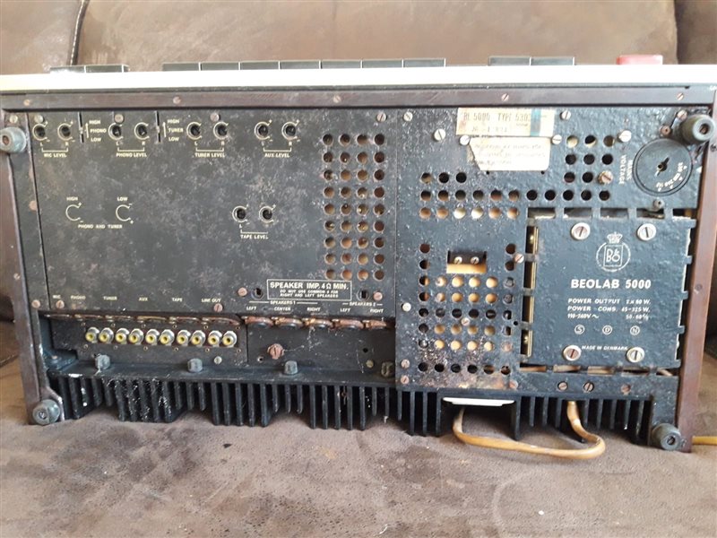

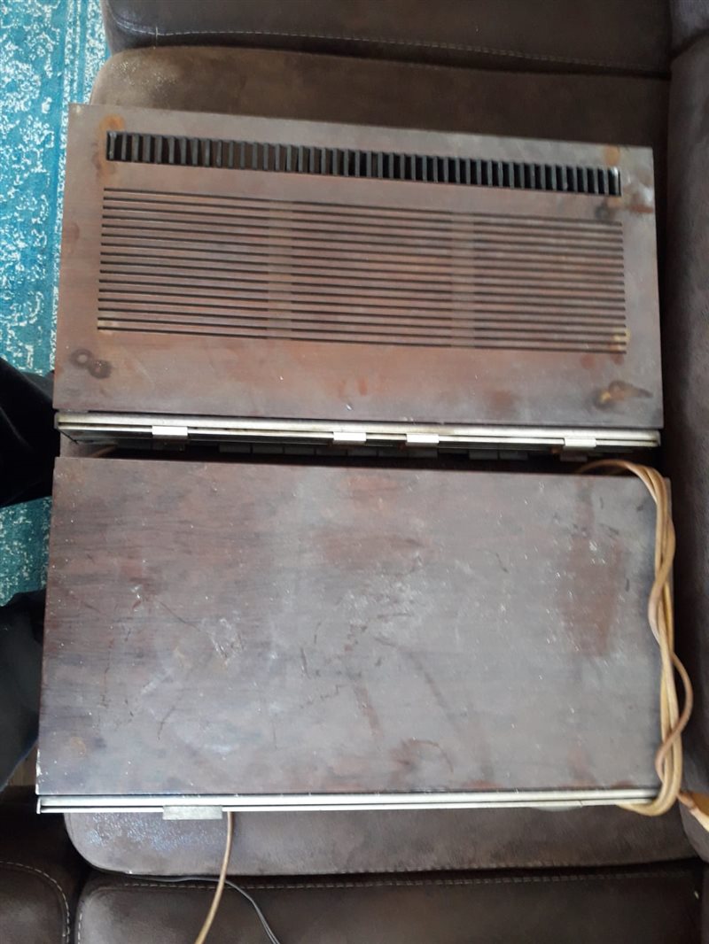

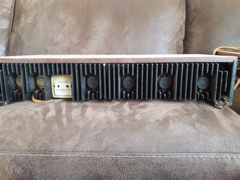

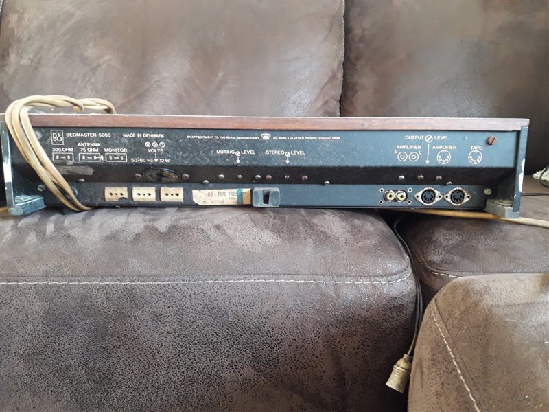

The package came today!

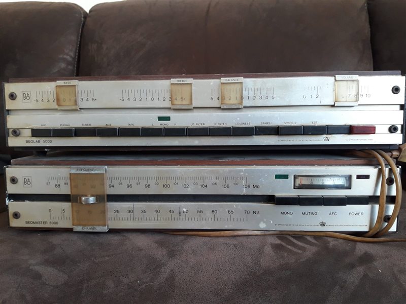

I will post the pictures from least worse to the worst. At least the receiver and amplifier (from 1967) seem to be in the best condition,  but don't know yet if I should open them. TheBeovox5000 MK1's are rusty and the rubber of the woofer seem to be affected by this rust.
The Beovox 2500 are in the worst condition. One is bend on its stand, theyhave both damaged tweeters and there are only 8 out of 12 dustcovers. I could simply refurbish the two into one good beovox 2500 and use it as tweeter for the centerspeaker I want to use in the future. I could search for replacement parts but will be very hard to. Or I could ask Classic Audio for the possibilities or maybe donate them.
Any opinions so far?
Kind regards,
Simon

Hmmmm…...they do require a little attention to bring them back to a respectable condition. It can be done with some panels from Frede and some new curser lens from Martin and a fair amount of work from yourself, but this work is well worth the effort.....good luck and keep us informed of your progress.
Regards Craig

priklep replied on Tue, May 28 2019 8:56 PM
Dear Simon,
I can imagine your frustration when looking to those rusty and dirty scrap. But you have wedding ahaed (good luck from me). Do not turn the system on.
BUT:
most of the stuff is very dirty, and it will look much better when you clean it from dirt, may be it smells also (keep it on fresh air)
front pannel on Beomaster and both wooden panels look very good, no buttons are missing
Write an email to Frede, he will guide you.

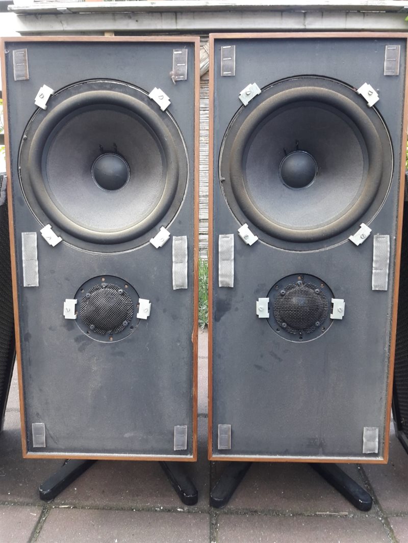

I won't turn them on, only checking the Beovox 5000's how they sound on my BM901 and they seem ok. Maybe too big for my place, but I will pick up a second Beovox 3000 in the near future.

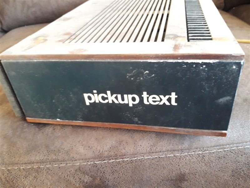

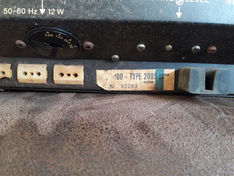

Is "pickup text" as shown on the previous pictures original? And why?

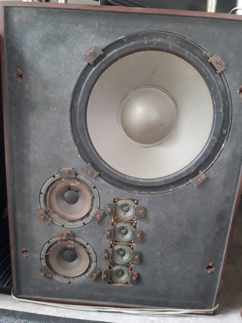

Hear are some pictures of the Beovox 5000. I noticed that there are no B&O logo's on the legs, as it should be on the MK1 according to ClassicAudio's website. The covers look good and have a goldplated logo.

Never seen the pickup text before - I don't think is B&O. Those speakers are not too bad - the brackets will clean up and the bass unit looks worth cleaning - the mid-rahges look a bit rougher - I think the tweeters are the same as in the 2500s.

Text on blask metal side plate is not original of course, hope it is only a sticker.
Regarding Beovox speakers: rust on clamps and screws is only a cosmetic issue, can be easily treated with steel brush and preservative matal cleaner in spray. You can find a lot about veneer treatment in beoworld forum, this was nicest part of DIY work for me. Leg polishing would be also easy, I hope.

I've cleaned the Beovox 5000 and the inside of the boxes did not have any sign of corrosion, plugged them into my Beomaster 901 and sound amazing.

Yes I've already started and have almost finished the Beovox 5000. I'm probably gonna get called names for sanding it to a much lighter colour than the original rosewood colour, but I think it looks amazing this way and will suit up better in my house.
I also treated myself with a Beogram 1600 which I found in a thriftstore and runs pretty good. I wonder what stories it could tell if it could talk. It's a 5713 which were sold in France, the main transformer is replaced by a 110V unit and the plug is from GB and it came with a "step up & down transformer" which means it was used probably in the Netherlands (why else would it be in a Dutch thriftstore?). There's also not a lot information about the 1600 in general, which make me wonder if these are rare or just uncommon.
As I typed this I was trying to upload the photo's of the Beogram and Beovox, but uploading seems to have some issues.
Kind regards,
Simon
priklep
Slovakia
Posts 103
priklep replied on Wed, Jul 10 2019 8:07 PM
Nice to hear, that you allready started with renovation.
Regarding wood work: veneere after sanding is allways lighter, after oil treatment IT will darken a bit.

Dear members,
I finally replaced all capacitors and most transistors, all thanks to Søren Mexico's orderlist from Mouser.
I've read on the forum that the transistors on the mainboard are best to maintain original. I've tested these transistors on the mainboard with a cheap semiconductor analyzer and need to be changed as expected, because they are very bad.
Now is my question which transistor is the best replacement?
SE8002 ~ BC141
SE7001 ~ ?
37740 ~ 2N5320
37741 ~ 2N5322
Hopefully someone can help me out here.
Kind regards,
Simon
