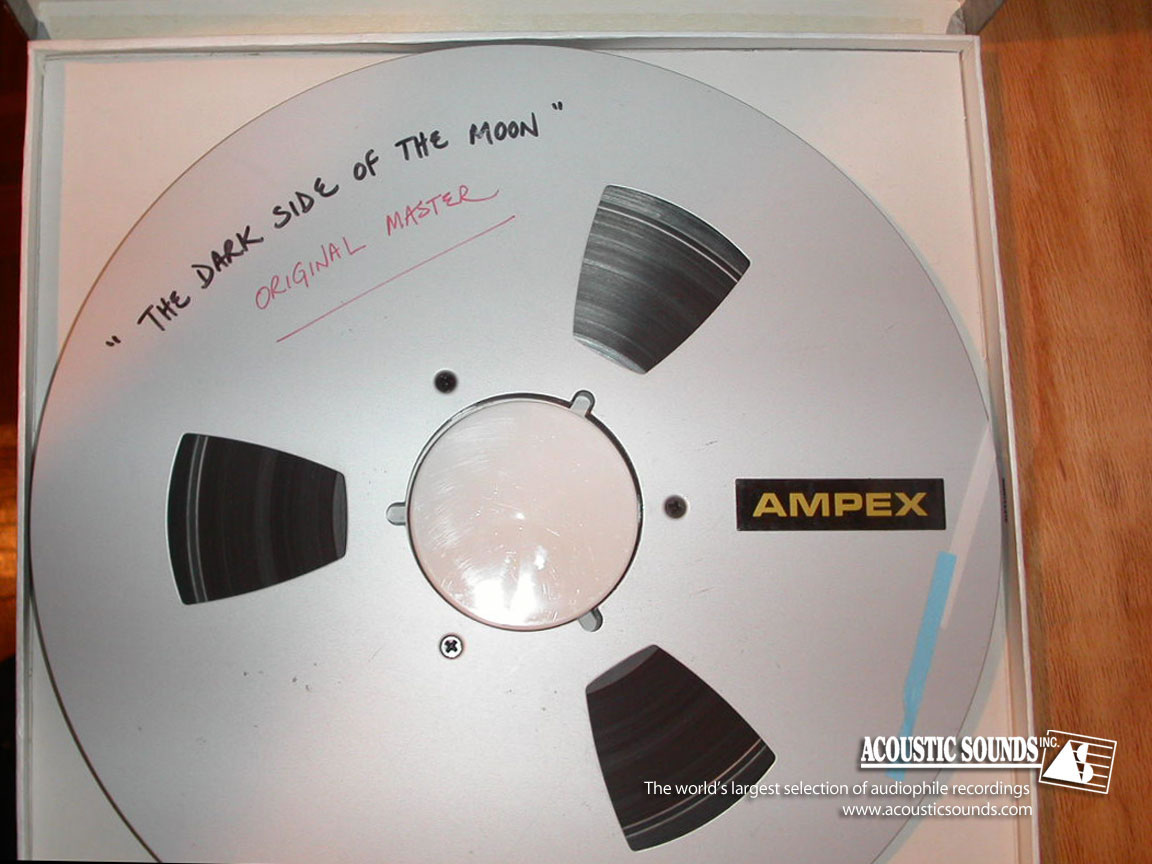

Words and terms are flying left and right...
This is what i consider the Master! (Jeff : "cutting lathe")  How does "digitalized" apply here?
Related image

In my opinion this is the MASTER, the tape from which te vinyl-negative is cut.
OR the file containing the digitalised (and processed) info of this MASTER tape

The original master tape is not the thing used to drive the final LP master cut. First it has to be tailored to the LP format, which means introducing RIAA equalization, summing the bass to mono below a certain frequency, etc. Some LP producers started doing that in the digital domain quite a while ago from what I have been told in order to apply the RIAA and other changes more accurately. But I freely admit I am not up on all the current incarnations of this particularly obsolescent technology.
