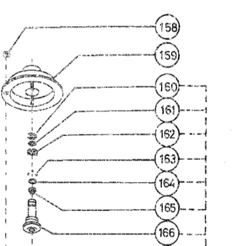

Now the excited part in me forgot to note the order in which these belong (lesson learned..). When I was looking at the service manual, I could not make out the order, as it also seems to mention a washer (#161), which seems to be absent in mine.

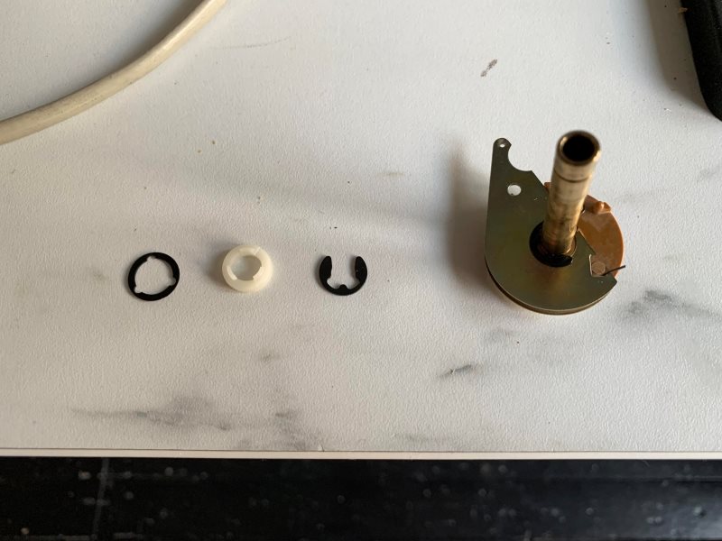

The parts that came out, except for the bearing balls, those are kept safe :
The player section:

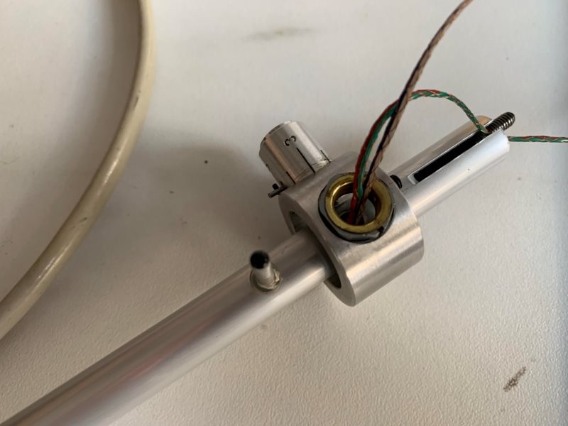

The arm (I know, it's dirty, cleaning it up is next ):

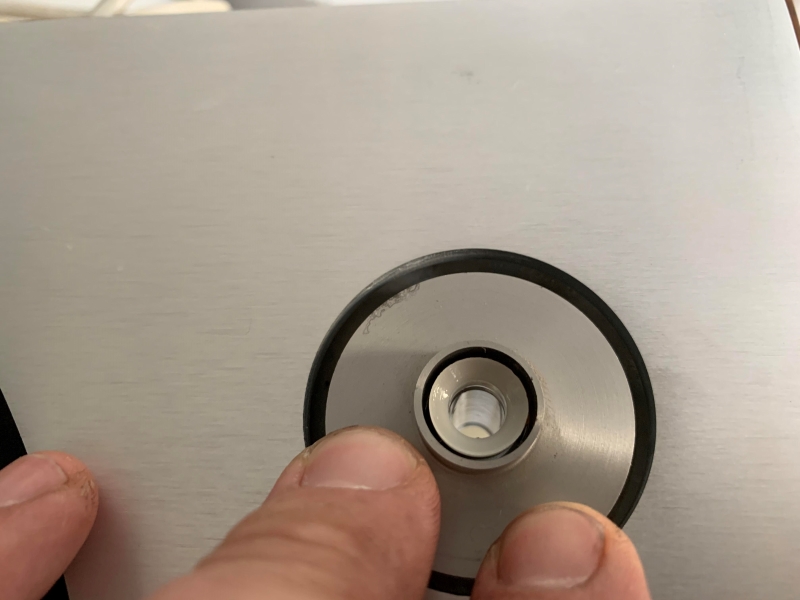

So, I actually managed to figure it out Was easier than I thought.
For future reference, should anyone need it:
After this my initial issue was still there, which was that the player was stuck in the same groove. Arm was balanced correctly. Fearing a broken element, since I bought it from eBay, I checked one last thing.
The word abused in my original post was not for nothing...
The return mechanism arm was bent upward, so the tone-arm actually had a very hard time moving. I carefully bent it back (after removing it of course),et voila... It tracked perfectly at 1.2 grams!
