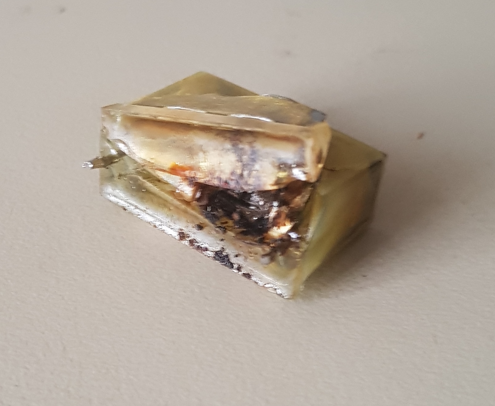

Now for the bad news...
I did a quick test hooking up an audio signal to tape 1 input RCAs to see if there would be any sound from the headphone output... nothing. When I checked the connectors on the preamp and tone control boards I noticed that a ground pin on P27 on PC4 had come loose. After reinserting that pin firmly in the connector housing and switching on the BM all of a sudden... magic smoke.
Not a big bang, just a puff of smoke around the starting up circuit board. I've narrowed it to the left bridge rectifier (one of the internal diodes has shorted).
Wondering if this is likely to be a normal part failure or could there be an underlying cause that I need to investigate? Any advice on a replacement part (or specs)? Thanks!
manfy
Posts 185
manfy replied on Wed, Mar 25 2020 11:06 AM
At first, congratulations to your success with the uProcessor board.
krais:
Smoke coming from electronics is never really a good thing! There must be a reason for it and that GND connection you re-attached to PC4 is the first thing I'd look at.
Without disconnecting any wires from the board I'd check all the supply rails that were served by that rectifier. Check if there's any short circuit with a multimeter.
Which rectifier blew up? 30D1 or 30D2?
The service manual shows "KB 62-B125/110-25" for both rectifiers but I couldn't find any datasheet on the net. Check the component marking on those bridge rectifiers. It will help to find a replacement.
PS: After some more googling it shows me a Diotec bridge rectifier 400V/25A, square metal case with 6.35mm connectors. If that's the one installed, then overcurrent is unlikely - that current would have blown the fuse and/or some other components on its way to heaven. That supports your random component failure idea. Nevertheless, I'd also do the short circuit checks described above just for peace of mind.

krais replied on Wed, Mar 25 2020 11:18 AM
Thanks Manfy
manfy:
Sorry I wasn't clear, I think this is a signal ground pin (P27-3).
manfy:
The left rectifier when looking from the front of the BM, so 30D1
manfy
Posts 185
manfy replied on Wed, Mar 25 2020 11:52 AM
I just edited my previous post; please check.
The circuit diagram shows that 30D1 only supplies the +/-55V to the left output amplifier. Random component failure is possible, but I'd still check very carefully for any potential short circuit that could have caused this to the rectifier.
If you're certain that everything is fine you should replace the rectifier and verify the power supply voltages with all other boards disconnected before starting to reconnect the boards and testing further.
krais
The Netherlands
Posts 136
Silver Member
Apologies Manfy for wasting your time, I may have jumped to a wrong conclusion earlier. Did some more measuring out of circuit and the bridge rectifier seems intact after all (0.48V one way voltage drop across the diodes).
It's all rather confusing. I'm quite sure I saw smoke on the left side of the power up circuit board but there are hardly any components on that side of the board. The 2 fuses haven't blown and resistors R1 and R2 are within spec (5.6 ohm).

sonavor replied on Wed, Mar 25 2020 11:53 PM
krais:
Hi,
If you think you saw some smoke then you probably did. Something could be shorted somewhere and resulted in too much current through a component. There are two power relays on the component side of that BM8000 Start Up PCB.
You can open that Start Up board some more so you can watch what happens on the next power up attempt.
Before that though, re-check all of the BM8000 wires. Because you rebuilt the output amplifiers and tested them already they should be good. Did you make sure the black ground wires are attached on the backside of the Microcomputer board?
P27-3 is a ground connection between the Filter Control panel and the Preamp board. If connecting it completed a connection that exposed a problem in the Beomaster then it could involve 15 VDC power. How that affects the Start Up circuit I can't guess right now. 7RL1 and 7RL2 must both engage to apply the ±55 VDC rail voltages. The rails must also have +15 VDC for the output amplifiers to turn on. I am not seeing the ground - Start Up circuit - smoke correlation but I believe there is some indirect thing going on there.
If you don't find any wiring issues I would try the variac and dim bulb tester again as a precaution. I recently blew out a couple of TIP 146 transistors on a Beomaster 4400 because I didn't trust my dim bulb tester. Voltage was applied and measured fine at first but then started to drop. I took the dim bulb out of the power path and the two good Darlingtons were gone. I should have seen the dropping voltage as a sign that there was something wrong.
Smoke is another sign :-). Hopefully it wasn't fatal for some poor component. Check power on the BM8000 with the dim bulb protection and re-check what voltages come on (both in Standby and with an audio source selected).  With something like Tape 1 or 2 selected all of the power should come on and you should here the relays click on the Start Up board.  Check the +5 VDC regulator and the ±15 VDC regulators next to it.
One other thing...Double-check the Power Supply Board (PCB6) that 6P50 and 6P51 connectors are correct. Those two connectors have the same physical keying so they could accidentally get swapped. They also both play a role in the Start Up circuit.
-sonavor

krais replied on Thu, Mar 26 2020 7:52 AM
Thanks for the help Sonavor!
I'll do some more thorough checking/testing this weekend, making sure to use the dim bulb tester for the voltage checks (I don't have a variac at this time).
One other theory that came to mind: maybe the smoke was not coming from the startup circuit board but from the tone control board instead. The smoke could have been funneled upward between the pcb and the control panel and exited near the reservoir caps (making it look like it was coming from the startup circuit board).
I'll do a visual inspection of PC4 first before starting with the voltage checks.

krais replied on Thu, Mar 26 2020 6:52 PM
sonavor:
If the fault was on the tone control board then did you hear the two relays (7RL1 and 7RL2) engage when you tried to turn the Beomaster on?
The relays engaged when turning the Beomaster on but immediately the magic smoke appeared. Can't remember if the relays disengaged but the display stayed on.

sonavor replied on Thu, Mar 26 2020 8:04 PM
Okay, well when you fixed the wire in the connector that allowed a missing ground to make its connection on the Tone & Filter board so it sounds like there is just some problem localized on that board. Hopefully that will be easy to diagnose and fix.
-sonavor

I took a closer look at the left side of PC7 and did find a very dry solder joint on the AC trace (no burn marks, still continuity). Could that have produced enough heat to cause a small amount of smoke? It cannot possibly be that easy, right?

sonavor replied on Thu, Mar 26 2020 11:25 PM
What device does that lead go to?  That is the type of thing you need to look for when going over this Beomaster though.  Even if it isn't the source of your immediate problem it could become one in the future.

manfy replied on Thu, Mar 26 2020 11:46 PM
No, I'm afraid not.
A cold solder joint cannot create smoke -- unless there is arcing, in which case you'd see burn marks and you could smell a dinstinctive "electrical" smell.
It's more likely that the smoke came from R1 and R2 because of heating up rapidly, but that would imply that there was a high current drawn on the output side of the transformer. Those resistors are 5.6 ohms/5W and the trafo fuse is 4A slow-blow. So if the input current was 3A the fuse wouldn't blow but the resistors would have to dissipate good 50W. Now, that can cause smoke.
Normally, relay RL1 would switch off those "soft start" resistors after 1 or 2 seconds and such a short overload shouldn't create smoke - heat yes, but not smoke.
Just re-solder that solder joint and since you're at it, check that RL1 makes proper contact. It should be well below 1 ohm when the contact is closed.
Relays do have a limited lifetime and if those contacts have deteriorated, this inrush current limiter is not completely switched off in normal operation.

krais replied on Fri, Mar 27 2020 11:23 AM
manfy:
Hmm I assumed that the interval between the two relays engaging would be much shorter. So what I thought was a double click was probably just RL2 engaging all along, not RL1. I'll investigate RL1 to see if that component is working and makes proper contact. When testing the relay out of circuit what voltage should I apply to switch on?
Also, what I noticed is that if the Beomaster is turned on, switching to standby will cause a relay click, but when subsequently unplugging from AC there is another relay click. Assuming that a relay cannot switch off twice, would this also indicate a problem?

Dillen replied on Fri, Mar 27 2020 11:42 AM
There should be apprx. 1/4 of a second between the two relays activating.
Close to a “double click”.

manfy replied on Fri, Mar 27 2020 12:15 PM
I agree with Martin.
I don't have hands-on experience with the BM8000, but all the other high-end high-power amplifiers I've seen have a distinct double-click (usually in a 1 second range).
Looking at the circuit diagram I see that RL1, which disables the inrush current limiter, is driven by 40VAC via D21. So that's a half-way rectifier with an output voltage of approx. 18VDC. But you can check the printing on the relay; it almost always shows the nominal voltage there.
After the diode there's the RC circuit R27 + C20 and I calculated an RC time constant of 0.63sec. Without analyzing the switch-on circuitry with TR21 and TR22 in detail, I'd say that TR22 would probably switch the relay on after 0.5 to 1sec.
At power-off RL1 should open immediately because the smoothing cap C21 with 22uF shouldn't be able to supply the relay current for more than a few line cycles, i.e. 100msec maybe.
The main relay RL2 is controlled by the uProcessor and it switches on the power trafo that supplis the output amps and this RL1 circuitry. I didn't see any other relay in the diagram - but to be honest, I didn't scan every little bit of it!
If there are really only these 2 relays in the BM8000 then it would be very strange to hear another relay click after putting the unit into standby (aside from RL1 and RL2, which should switch off simultaneously when the uP signals standby)!!
Oops! I may have to take my last statement back!
I just noticed that the main relay RL2 is driven by -24V from the standby transformer. So, this voltage is available as long as the unit is plugged in.
RL2 is switched off by a High signal from the uP. So if this signal drops to 0V, which should happen immediately after unplugging, there might be time before the -24V decay to 0V. In this case the relay RL2 may switch on for a short moment (until the relay current bled this -24V supply to below holding current. This would probably happen in an instant and it may sound like a single click.)
This scenario is thinkable but it needs to be confirmed by insiders!
Hmm, on second thought, I see that the standby signal is also swithing that supply circuitry via TR5!?? I'm not sure. Let's wait for Martin or other guys with BM8000 experience.
Dillen
Copenhagen / Denmark
Posts 13,191
Dillen replied on Fri, Mar 27 2020 2:58 PM
There should be no click when mains is connected.
When mains is disconnected while the Beomaster is in standby it's not unusual to hear a relay click on/off.
Perhaps because the supply to the processor falls down faster than the supply to the relay driver etc. and a low signal from the processor is then "interpreted".
I never dug any deeper into this.

sonavor replied on Fri, Mar 27 2020 3:12 PM
krais:
When the Beomaster 8000 is in Standby and you press a music source you will hear two relays click on very close together like a "tick-tock".  Pressing Standby when a music source is selected will dis-engage both relays but they will almost be in unison. So it won't be "tick-tock" but you can still hear two relays. Unplugging the Beomaster 8000 when it is in Standby will result in the relays cycling. It will be the "tick-tock" sound.

Hi
Maybe you have a closer Look to the big AC Mains Capacitator wich is located  on the Relay PCB.
My BM 8000 was playing music, suddenly I heard a crackling and sparkling Noise of the Amp with a lot of bad smelling Snoke comming out of Direction of the Right Amp Board...but the BM was still playing Music and after shutting down and opening the BM I could´nt realy find anything burned.
Checked some Voltages, No Load Current and Offset, everything fine.
So I put back to AC and starteted the BM and he was still working proper.
Final Investigations sortet out that the AC Mains Cap was totaly kind of "exploded"
Mounted a new one and everything is fine aggain.
Best Regards

krais replied on Fri, Mar 27 2020 8:16 PM
Spassmaker:
Thanks Christian, I already had proactively replaced the Rifa safety cap as these are infamous for catastrophic failures due to old age.

Update: I figured out why RL1 would not engage. Another loose connector pin, this time P51-3 on the power supply board that controls the relay.
So this would have caused a continuous current through R1, R2 potentially causing the smoke to appear. But as that happened immediately after switching on the Beomaster, in this scenario there could still a fault somewhere that is causing a high current to flow through the resistors as Manfy indicated.
So some more troubleshooting left to do...

sonavor replied on Fri, Mar 27 2020 9:32 PM
With your Beomaster 8000's recent history of connector problems I would check every connector again. ;-)
