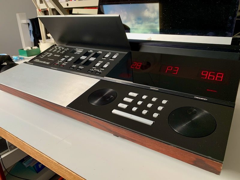

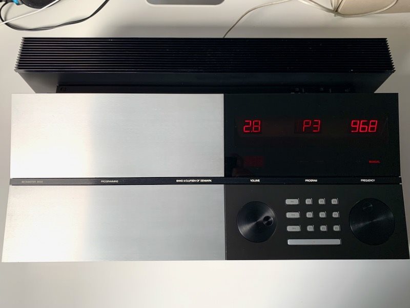

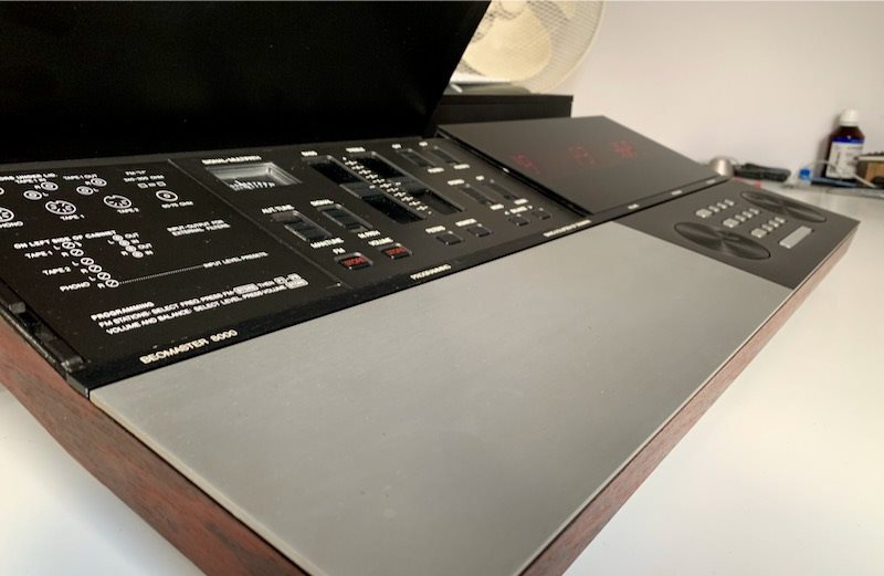

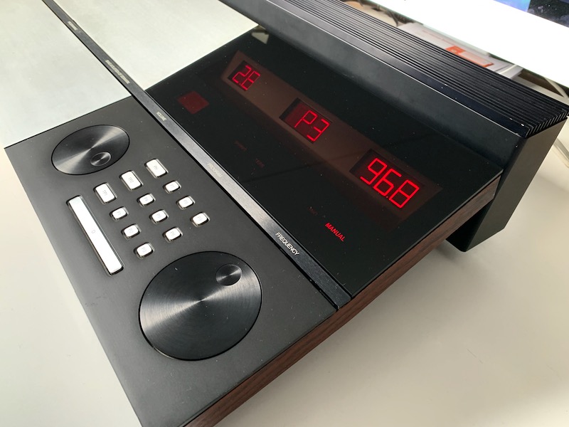

Finally it's time to wrap this one up. I did some additional tests but concluded that heat dissipation is probably fine. Frequency response, power output and listening tests did not show any additional problems (in fact it sounds amazing). Here is the the Beomaster in its full glory after reassembly.
Many thanks to Sonavor, Martin, Manfy and others for all the incredibly helpful advice and tips. When I started this project I knew I was in for a challenge given my limited domain knowledge and experience. I faced quite a few problems and setbacks (some due to my own fault) but with your help I managed to get the BM8000 restored and learned a great deal along the way. Thank you!
