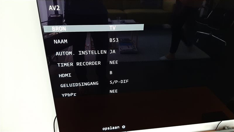

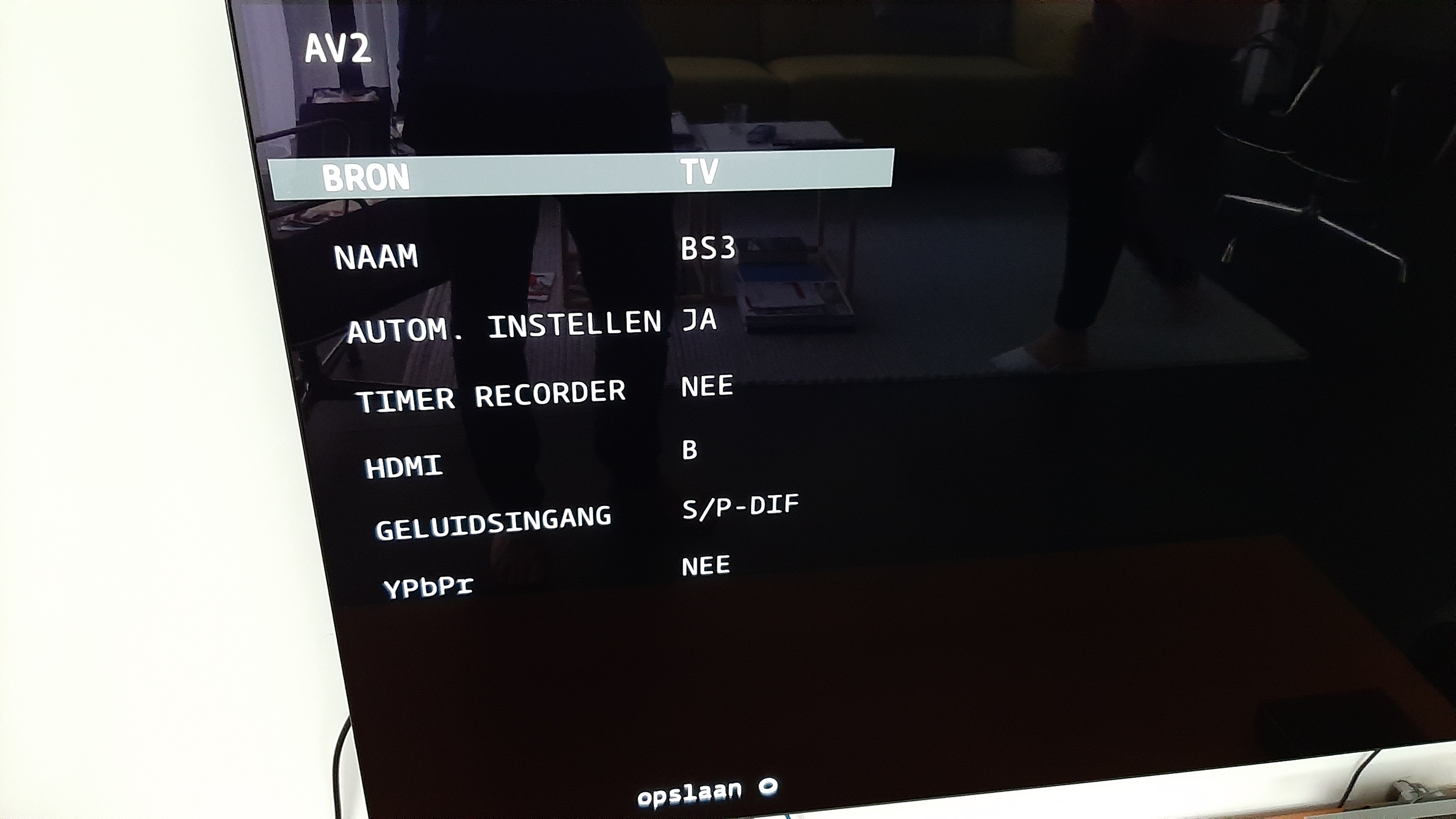

I have a Toslink to SPDIF converter and I have connected it to the TV and set Optical/HDMI ARC out. I have set the Beosystem 3 to AV2 sound input SPDIF.

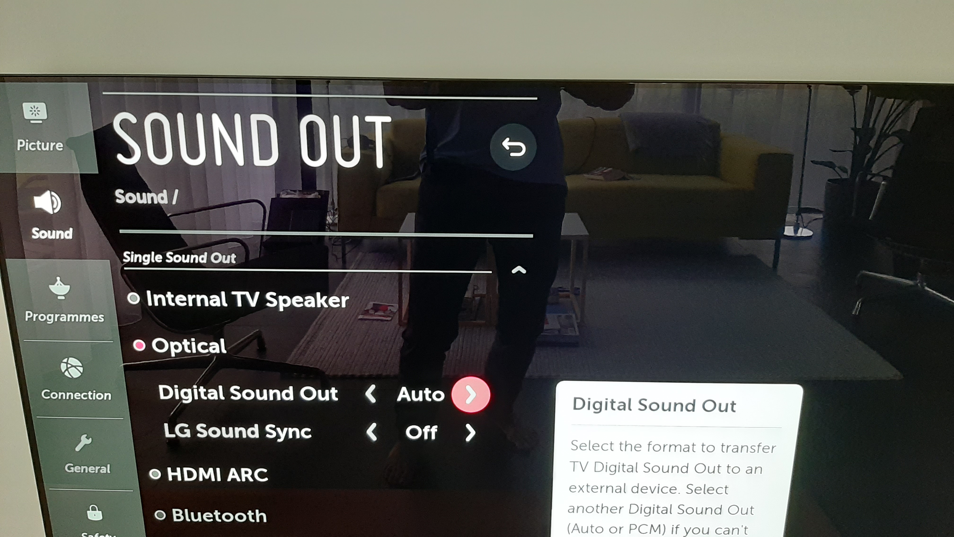

This is how I set the TV (55C9) and it works fine with an optical to coax converter. Optical only and Auto Digital Sound Out.

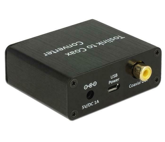

That's a pity Stoobie. Maybe a faulty converter indeed. Mine is this one:
There is no indicator light even, so I was crossing fingers too when I set it up lately! I powered it with a USB cable and I did buy a specific coax sp/dif cable as I assumed a normal rca/cinch cable would not work.
Hope you will get it working soon!

That's weird Stoobie. Let me know if you think I can help you with photographs of any menu setting. Happy to change the menu language into English Smile, and send photographs of connections when you are in doubt.
