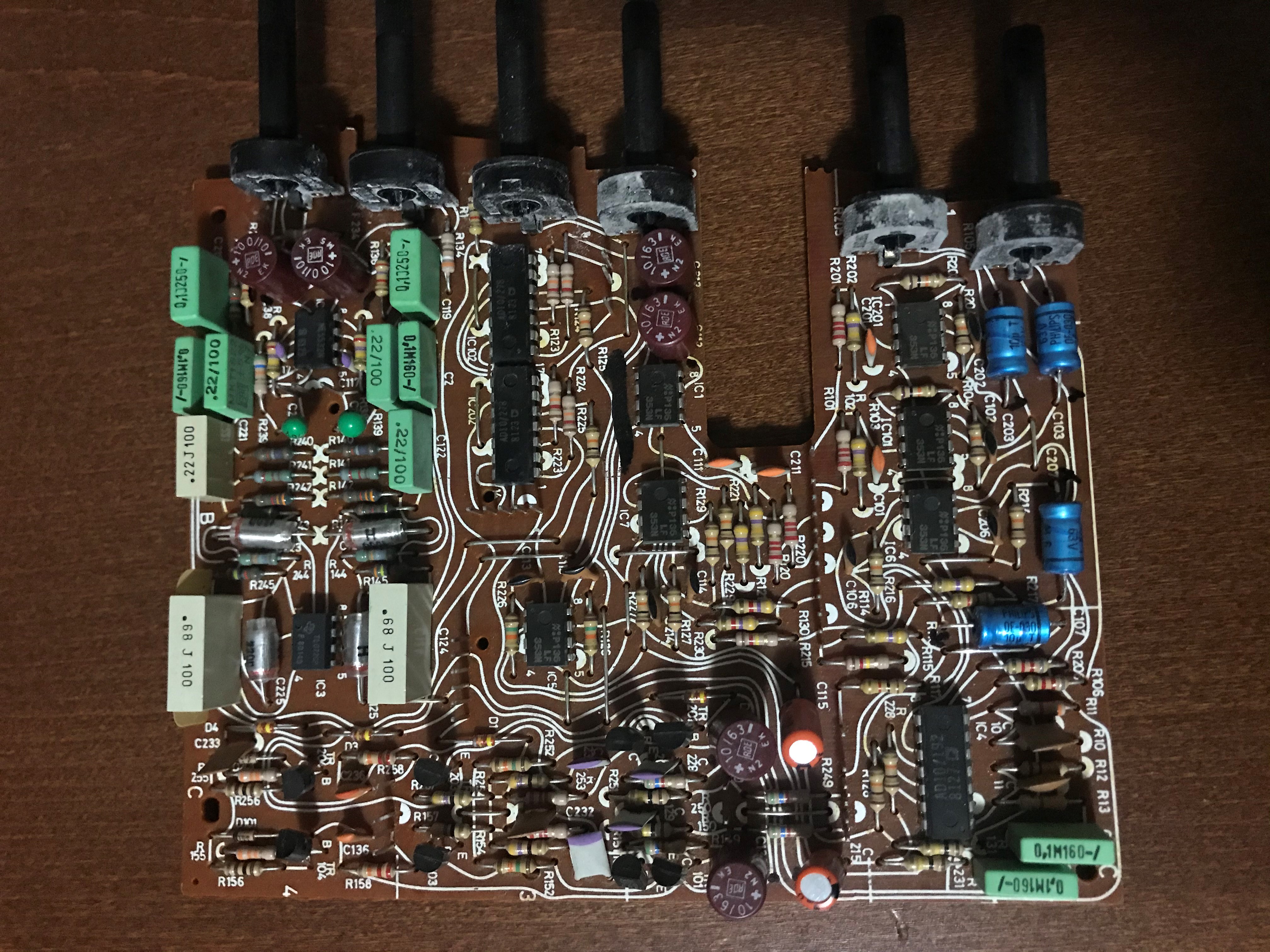

I started with the filter and tone control pcb. Removed the PCB and first step was to replace the missing buttons that Martin had provided. When I removed the PCB which the buttons press on, I found my three missing buttons - they had come out of their slots and were stuck between the PCB and front panel). The reason they had come out was because the PCB itself had curved. So the three buttons in the middle came out. (I have seen Beomaster 8000 for parts and also panels on ebay that have those buttons missing and used to think the seller tried to fix and failed and lost the buttons - This misconception is now fixed).
So the question is how do I fix the curve ? Without this the buttons wont work and will disappear again.

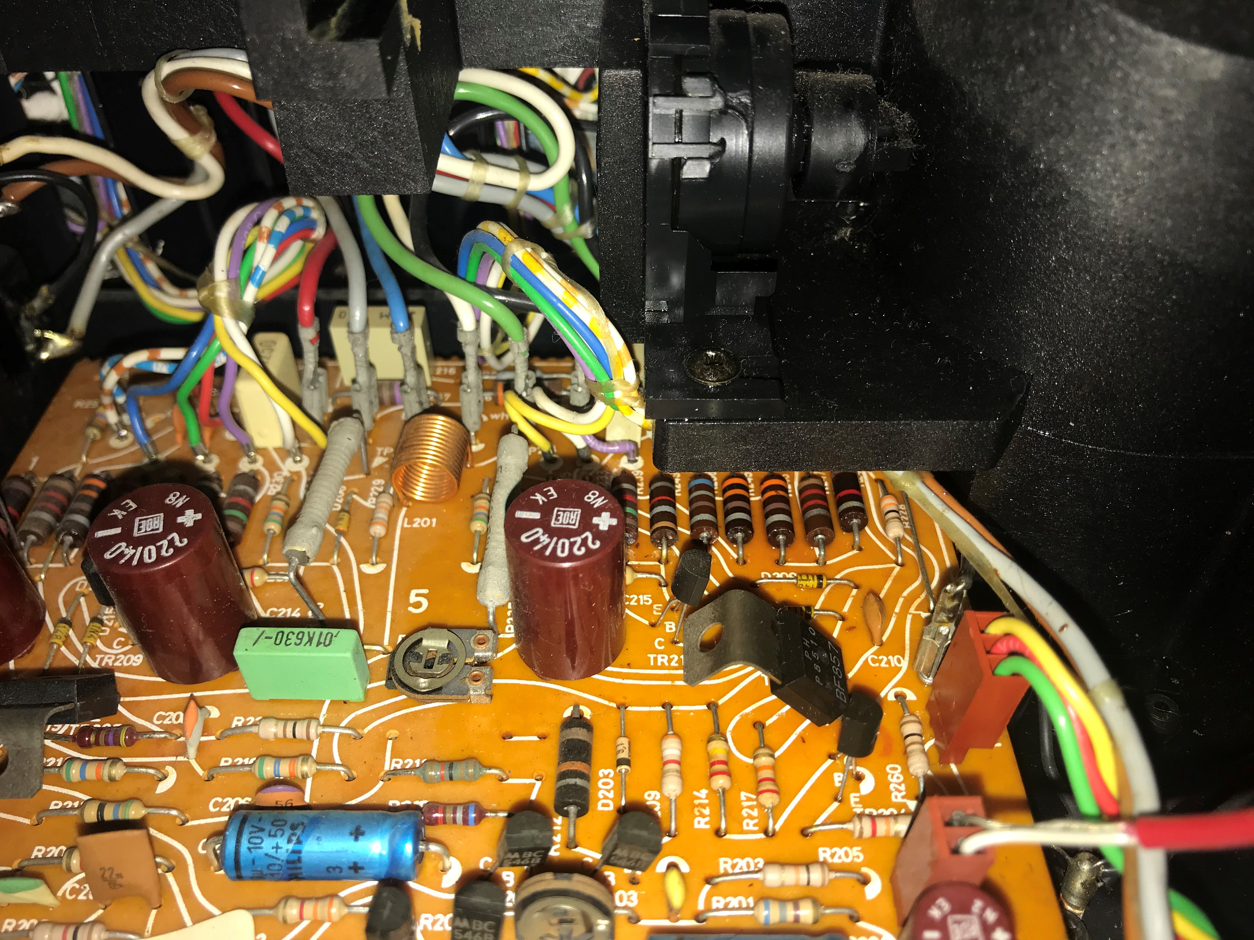

Next I started with the Preamplifier PCB. I found two capacitors (C115/C215 - orange) whose value does not match with the manual. As per the manual they should be 10uf/63v but on the board they are 10uf/25v. I don't think the system has been repaired. Which one should I replace with ?

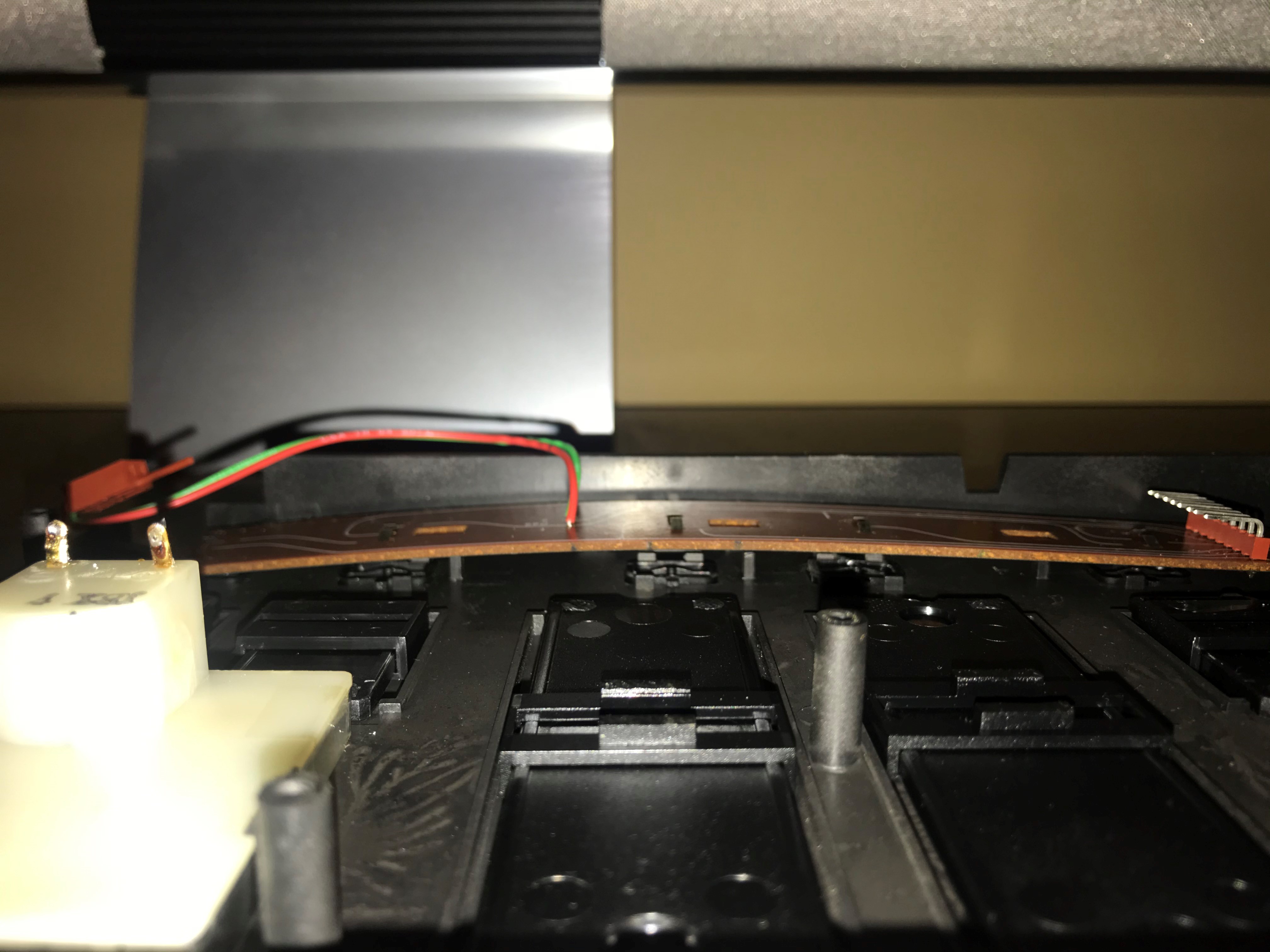

I also noticed that some kind of lubricant has leaked from the damping system. (or someone tried to add it from the top or side). It is all over the left side. It's on the output pcb 5.
Notice the dust on the red connector on bottom right, there is no dust on the resistors below the damping system.(top right). It's all wet and shiny. Could this be the reason that system is not coming out of standby ? Fault-protection mode is activated ?
Any suggestions on cleanup process ?

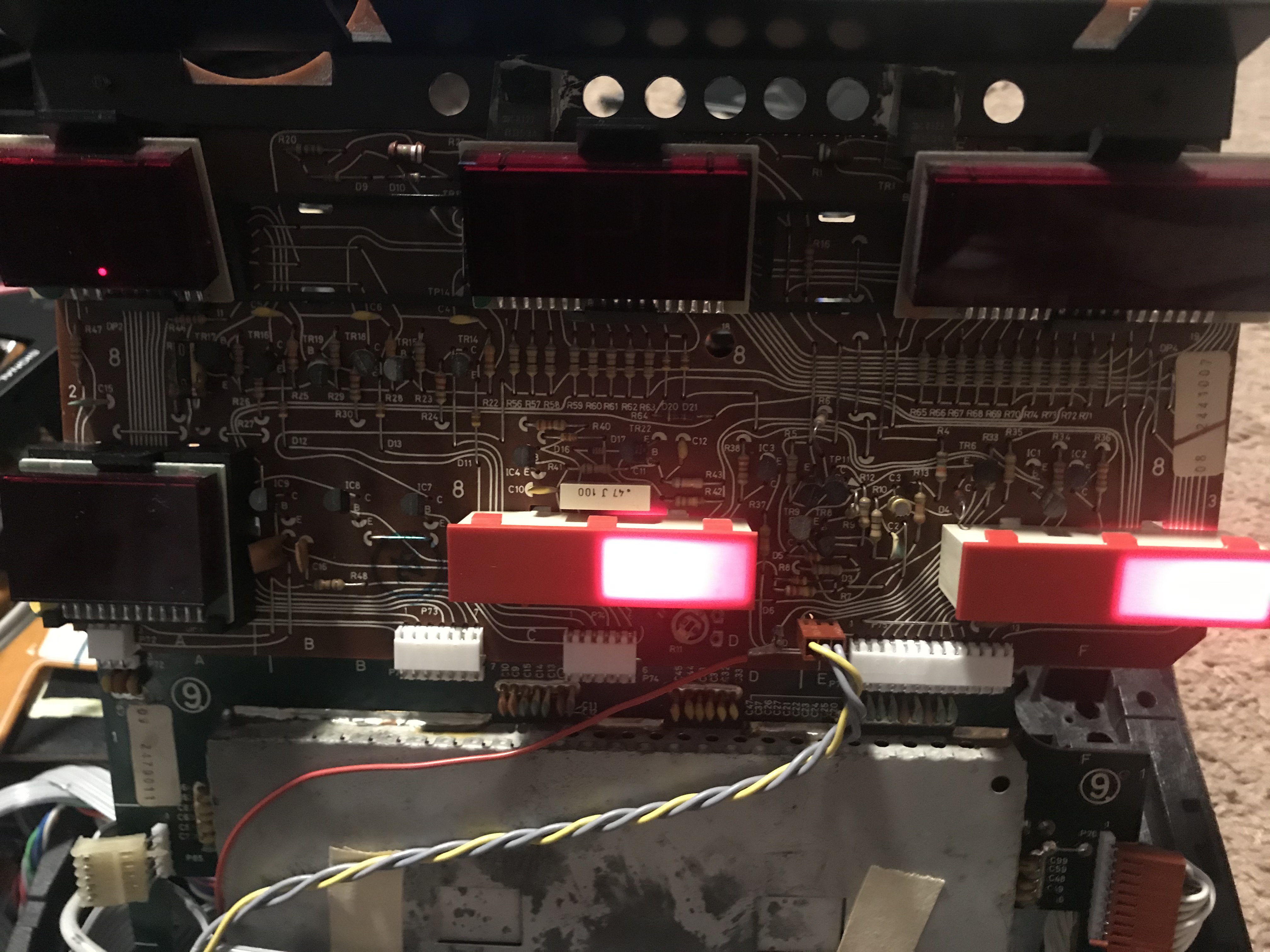

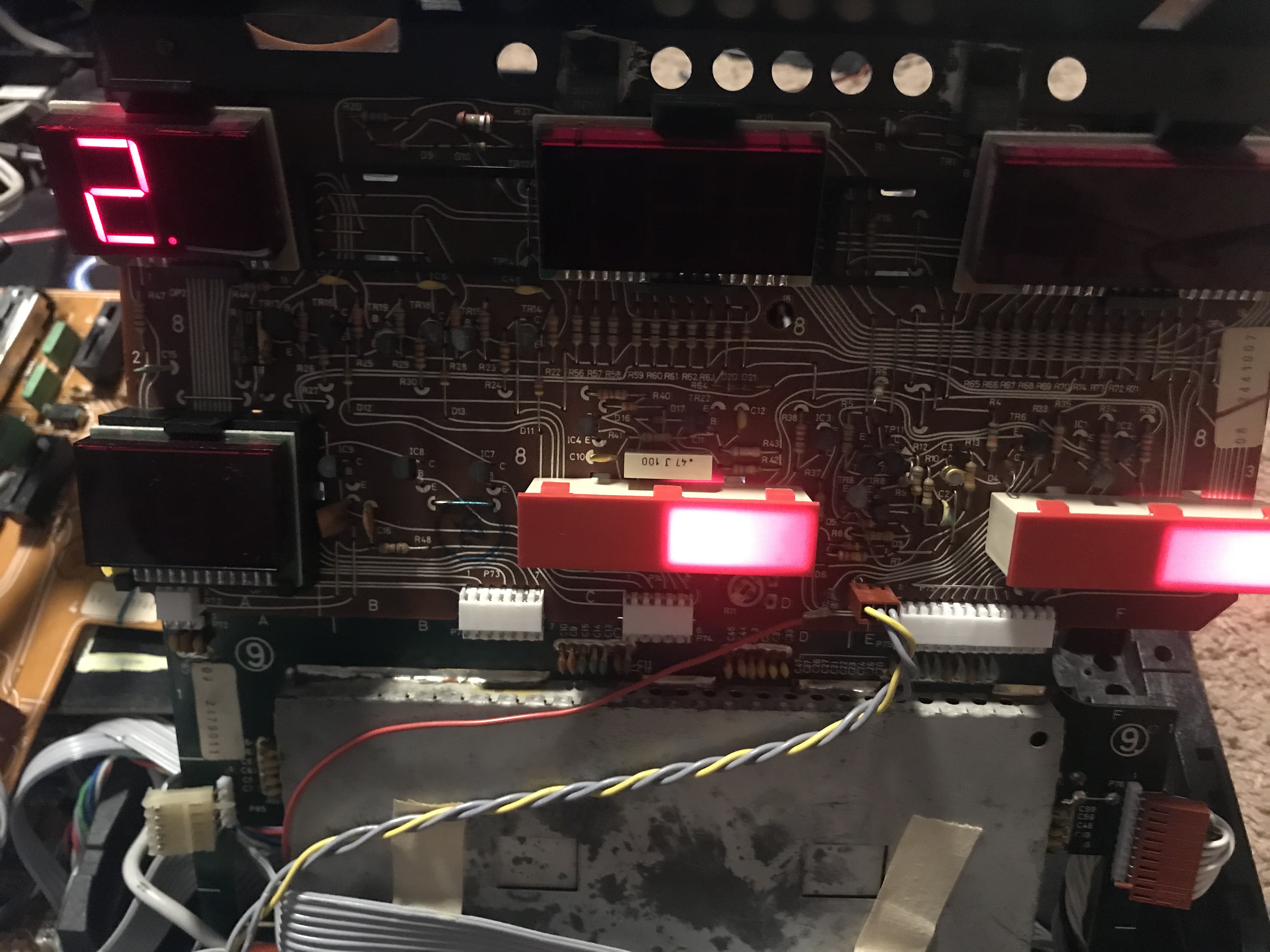

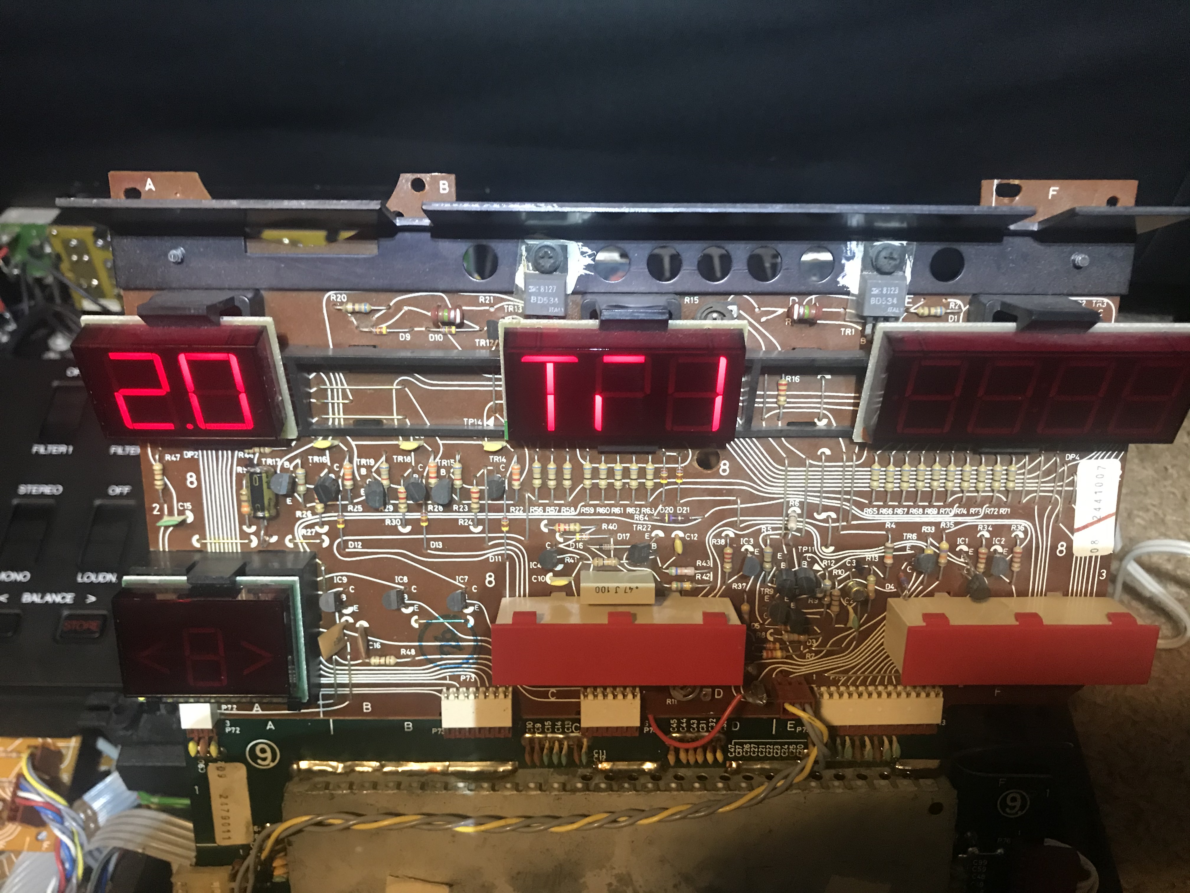

Some progress.
Good news is that the system now comes alive when input source is selected. Also, some segments on the source display are dead but others seem to be ok so not too bad I guess.

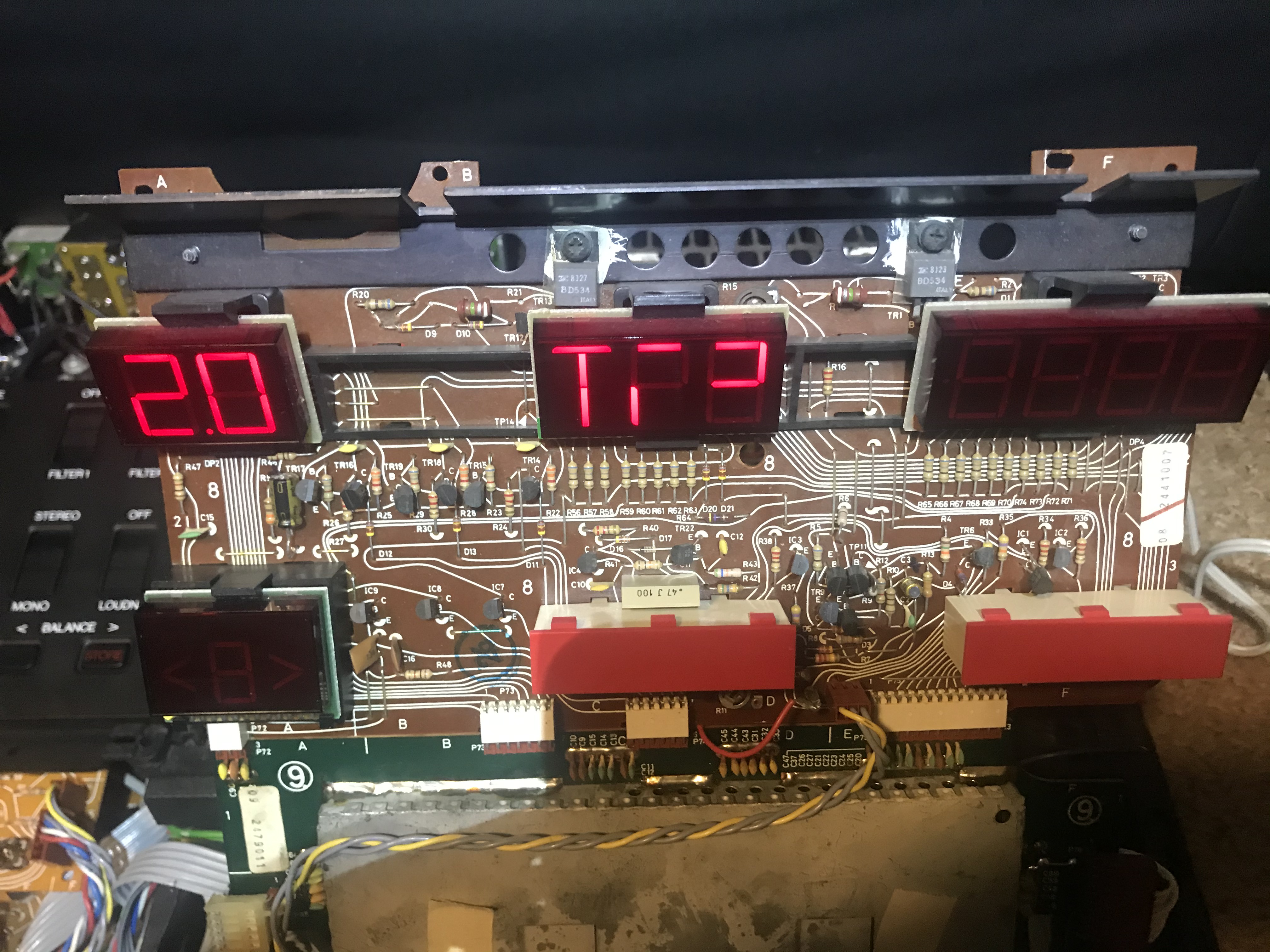

New challenge - The keys stop responding after a minute or so. see picture with vol 2 and fm freq indicator at 10. After this I have to pull out power and connect again and keys start responding again but again for sometime only. Haven't connected external source/speakers as yet.
Any guidance on what to look for ?
Thanks !!

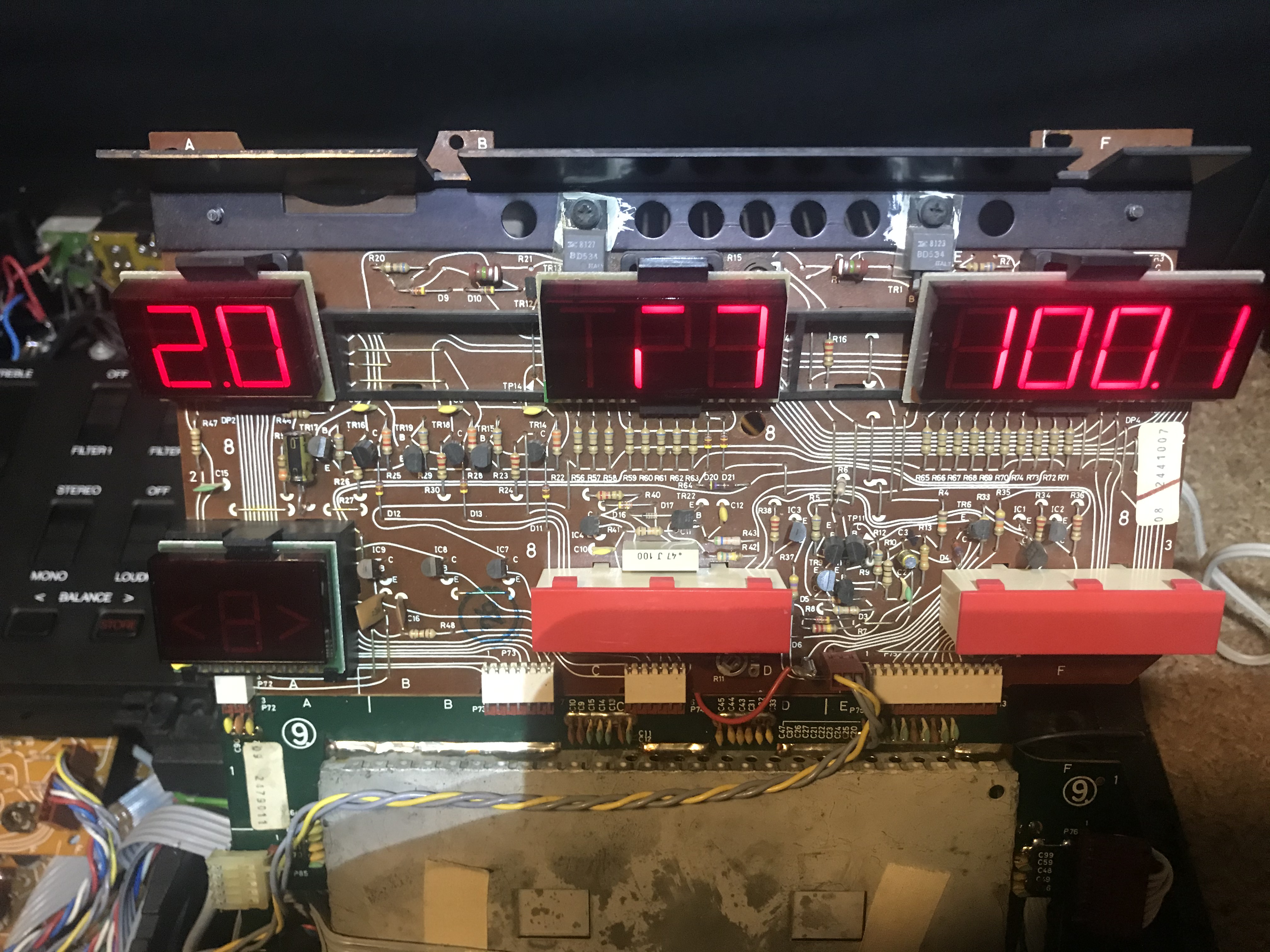

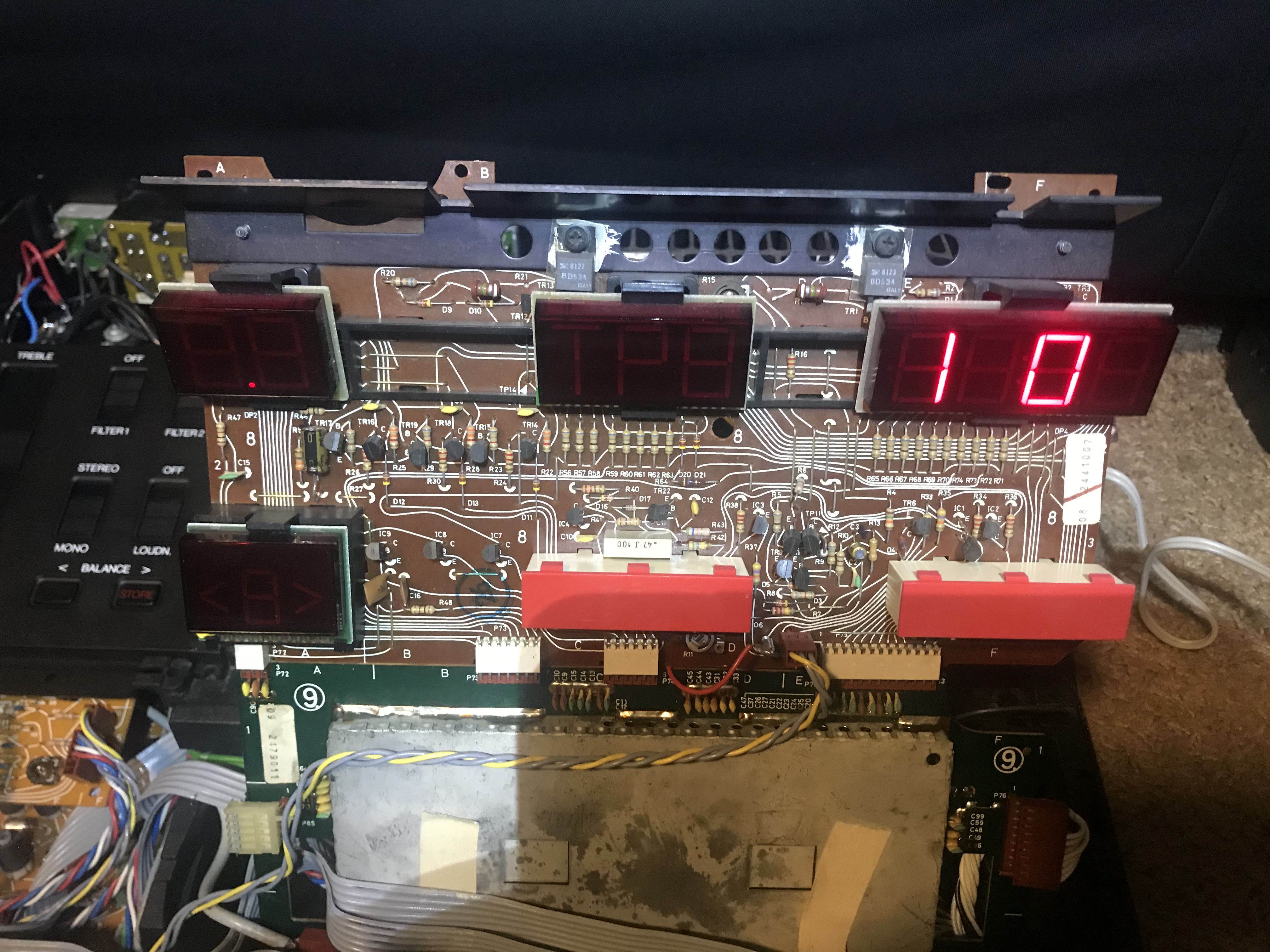

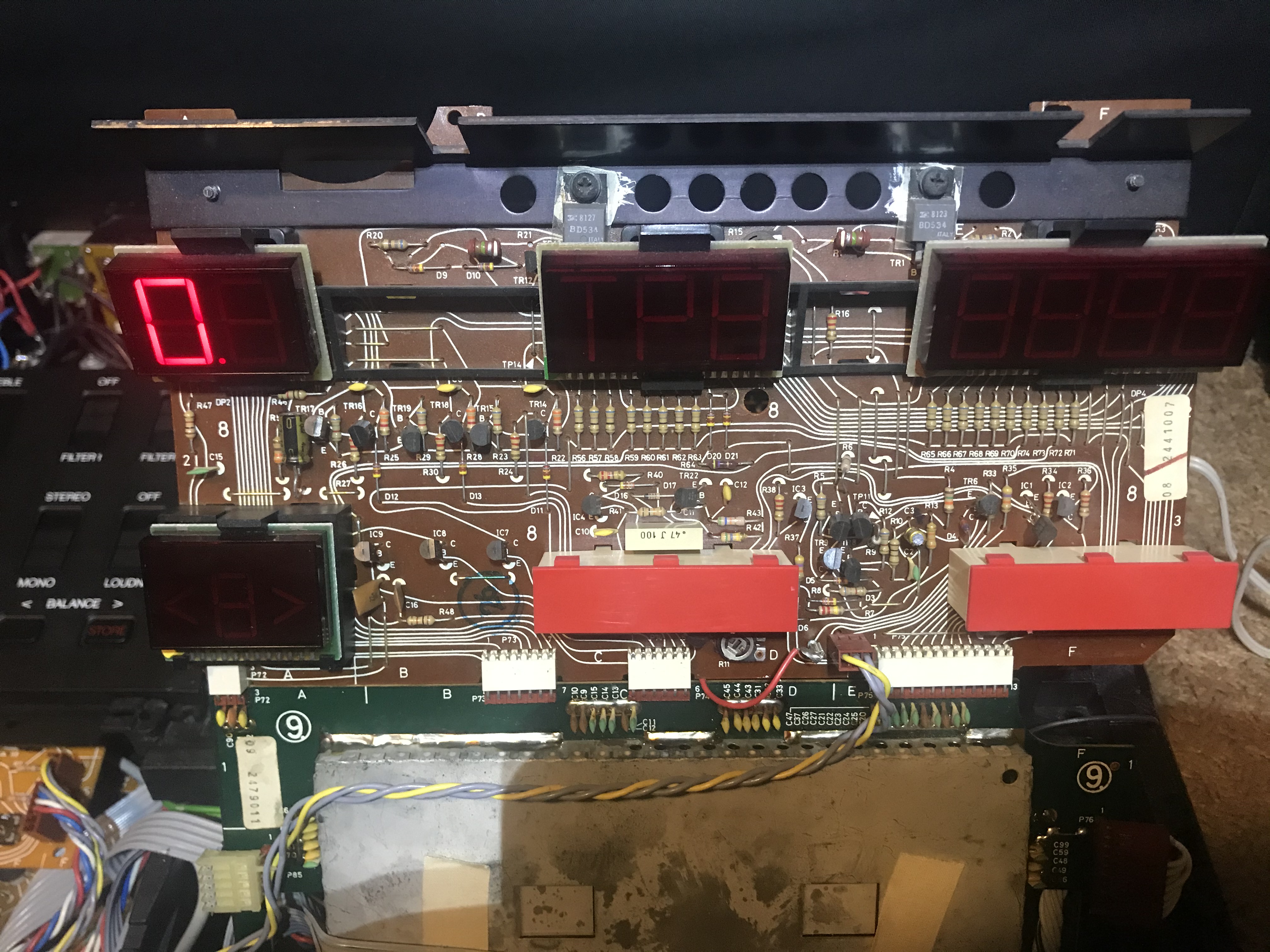

dahiyas replied on Tue, Oct 20 2020 4:07 AM
Couldn't stay away from the project Smile

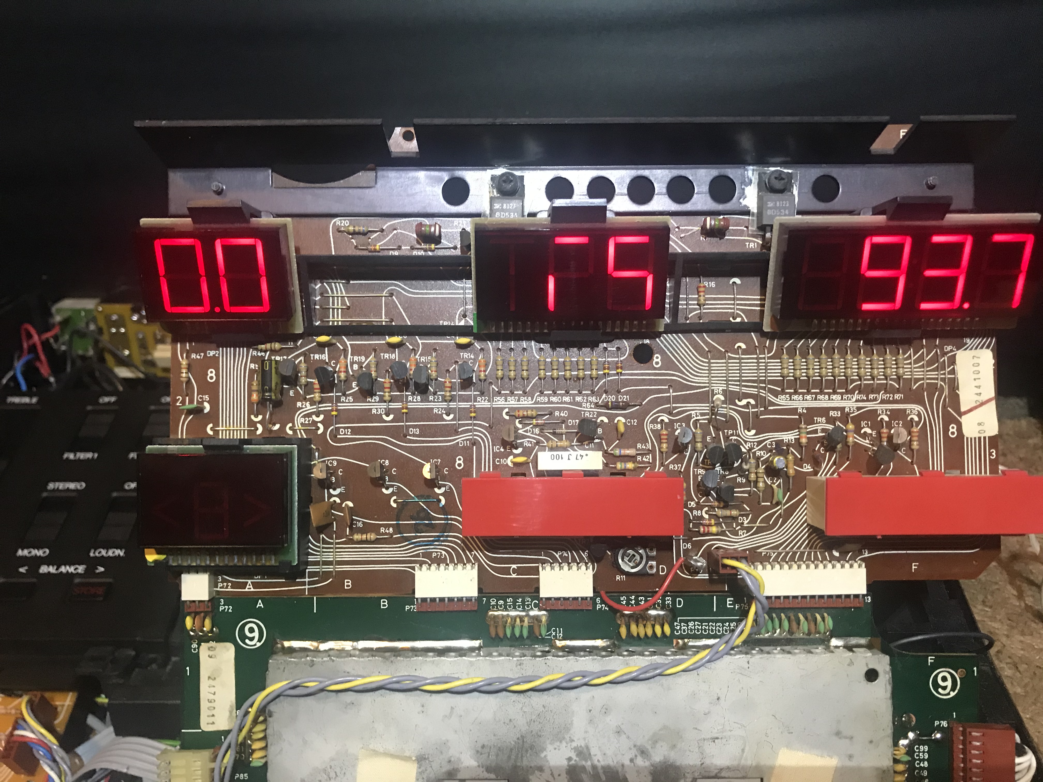

I pulled out the MP/Display board. Reseated all the cables again. Switched on and the system has been on for about 2 hrs. Keys are still responsive. Looks like loose connections but still doesn't explain the hang after couple of seconds.
So I was brave and connected external input and my headphones..and I heard music. so that's good news.
I found couple of new issues -
1. When I increase/decrease the volume, there is a clicking sound coming through with the audio..is that normal ?
2. The frequency tuning dial is not working. Turning it does not change the fm frequency. Could be the rotary sensors issue ?
3. The display with the red covers (Clipping/Filters and Manual/Mono) indicators do not light up. I assume bad bulbs (6v/80mA) ?
Any inputs will be highly appreciated.

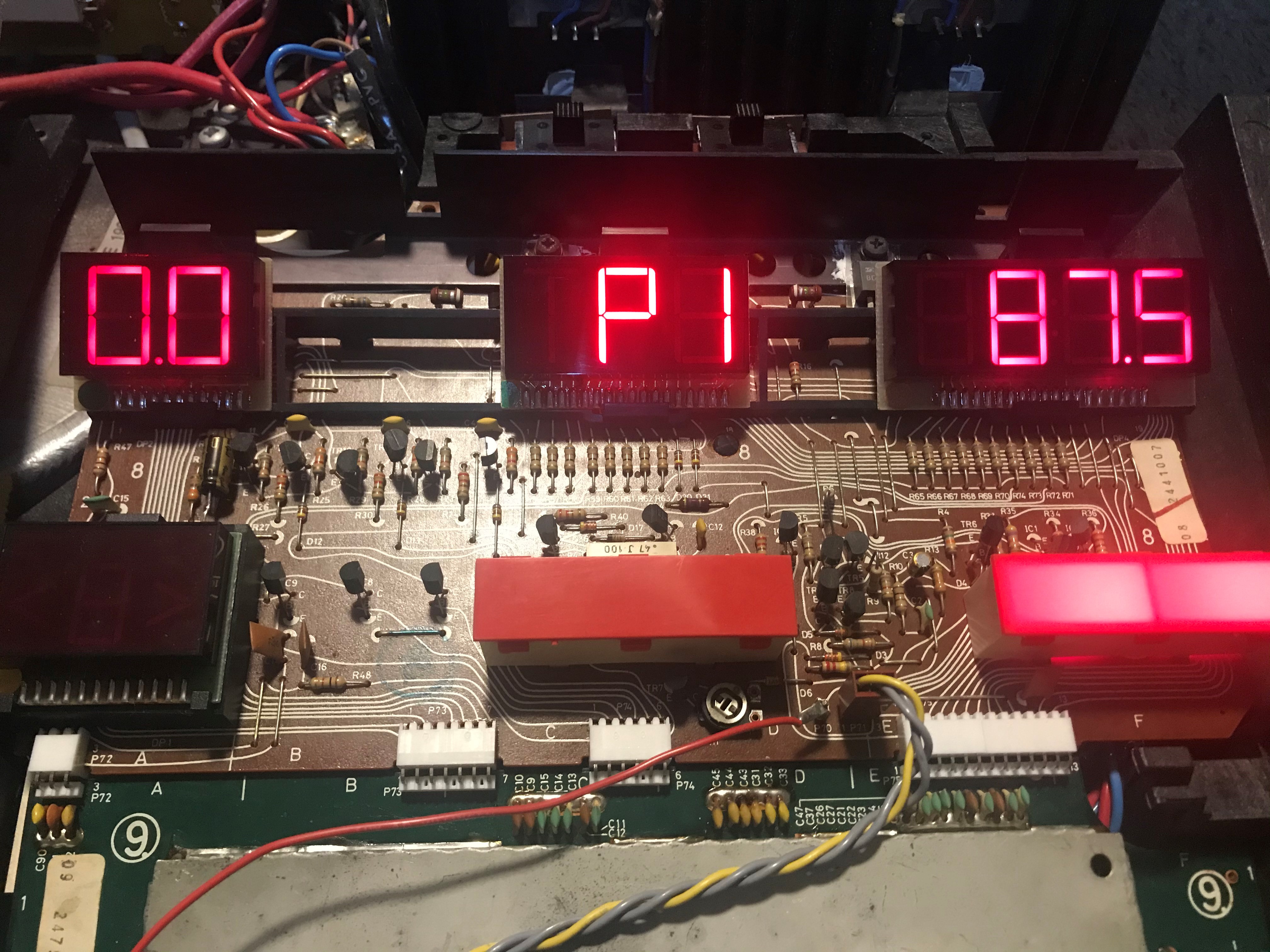

dahiyas replied on Sat, Nov 21 2020 11:23 PM
Finally got some time to restart the project.
Source display is restored (finally). Replacing the SMD LEDs requires a lot of patience. Ended up buying a cheap digital microscope and that really helped the process. I am not going to touch the other displays right now and come back to them at a later date.

dahiyas replied on Tue, Nov 24 2020 6:45 AM
I looked at the PCB carefully and I think one of the legs of a 200uf capacitor was not soldered properly. (Lesson to others - please listen to the experts who recommend pulling out the PCB for recap.).
Can that explain the volume fading in and out ?

dahiyas replied on Tue, Nov 24 2020 11:02 PM
I de-soldered and checked all transistors and diodes. everything checks out ok.
Did the loose capacitor cause the volume and heating issue ? I was able to set the trimmers to the right specs.

dahiyas replied on Wed, Nov 25 2020 12:07 AM
Yes Sonavor, the trimmer settings were done prior to me pulling out the board and transistors. 18mV and 0mV. After performing the settings, I figured that the right channel was not ok.
Yes, all of the components tested ok on the component tester.
Only thing I can think of is the bad solder joint. I had done the recap without pulling out the boards on a vertical board. Soldered all the caps again also checked the polarity again. But not sure if that would lead to the BF857 heating up so quickly.
I don't have much of a choice but to put the board back. Don't have any external power supplies (as yet) to test the board outside the system.

dahiyas replied on Wed, Nov 25 2020 5:04 AM
Yesss !! It works. Looks like it was the capacitor. So now the sound does not fade in and out. No distortion.
BUT
1. I felt the BF858s were really hot. But Krais also mentions the same and Martin/you confirmed that its normal.
2. I also noticed that D5 on the power PCB is also hot. Is it because of the proximity to the voltage regulators ?
3. I checked the trimmers again. The idle current keeps increasing in small increments after setting to 18mV. Similarly, the offset output keep on going higher. Anyways after getting closest to 18mv and 0V, I tried playing music for 30 secs and I switched off the system.
Any guidance on pt. 3 ?

While the Beomaster 8000 is warming up the idle current can drift. It should settle in though. The DC offset should stay withing the service manual tolerances.
You are measuring the idle current with the speakers not connected and the volume level at zero right?
Monitor it for a while and see that it stays around the 18mv across the emitter resistors.
Those BF858 transistors do get up around 160°F.  That's why I use 105°C rated capacitors.

After I switch on the system and play music..the displays either switch off completely or partially. The music continues playing. The keyboard becomes unresponsive. unplug the system and plug again and same behavior is repeated.
sonavor
Top 25 Contributor
Texas, United States
Posts 3,732
sonavor replied on Fri, Nov 27 2020 1:05 AM
I have never tested a Beomaster 8000 in that condition. I always have to load resistors or speakers connected.
With two speakers connected and music playing the balance control works just as other amps. It removes sound from one channel down to where it is silent. The volume level of the remaining channel doesn't change.
On your new problem it is difficult to diagnose.
Have you checked the voltage adjustment on the Display board? Make sure it is set properly and not interfering with stability on the Microcomputer board. Just something to check.
-sonavor
