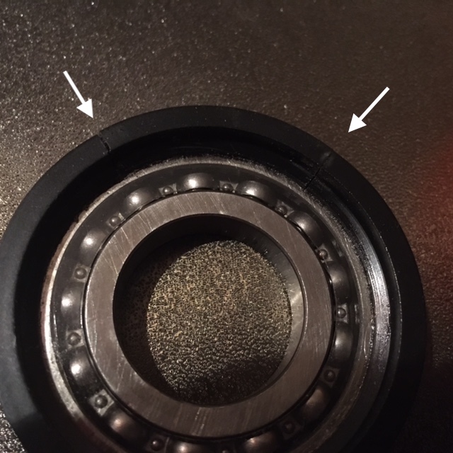

On my example, everything possible was wrong with the knob. The plastic knob itself is cracked, the 16005 ball bearing on which the knob rotates was clogged with dirt and would not rotate and the reflective optical sensor, a Siemens SFH900-2 no longer functioned. At least the printed black and white strip didn't fall off, and was the only thing holding the knob together.

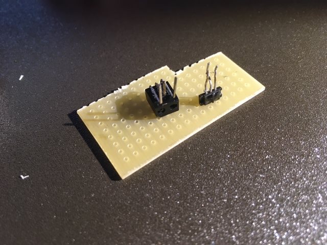

First thing was to restore function to the optical sensor. The Siemens SFH900 is no longer available, but is merely an infrared LED and a phototransistor combined into one compact part with the LED's cathode and the phototransistor's emitter tied together to a common pin.
Many modern generic reflective optical senors are available. I chose a generic RPR-220  as the width is about correct and the leads are laid out so that if the cathode and emitter are joined together on one side, the anode and collector are available on the other side. A little creative bending of leads and it fits in place of the SFH900-2.  At first it refused to work, but positioning it 1mm further away from the knob coaxed it to life.

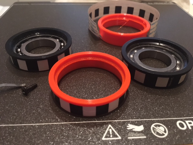

Next, removing and cleaning the 16005 bearing made it useable once more. I also obtained a spare bearing, having glued the original knob to the original bearing.
Next, out with some calipers and Fusion 360.  A few minutes later, I designed a new knob and 3D printed it. After a few tries I got a good one.  Then I arranged a series of black 9mm x 8mm rectangles into a strip and printed it onto a DYMO adhesive label, and attached it to the new knob.

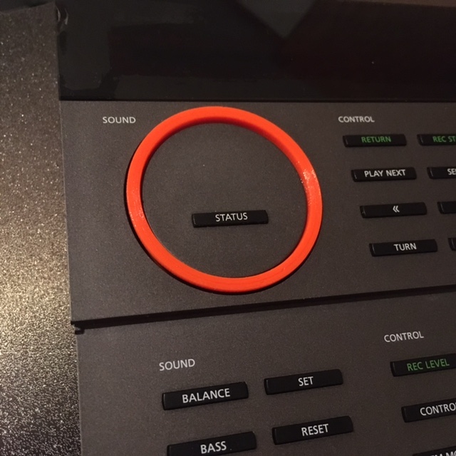

Nice job, though the red ring looks out of place in my opinion.
I take it, you will be fitting a black one?

I have a black knob fitted now, but am altering the dimensions slightly to make the printing process more consistent.
 I am experimenting with different plastics and colors... so far my favorite is black PETG and the pictured
Prusa orange PETG .  I think PETG is the best choice so far. Maybe I’ll try clear next. I also have ABS and Polycarbonate in white, black and yellow.
