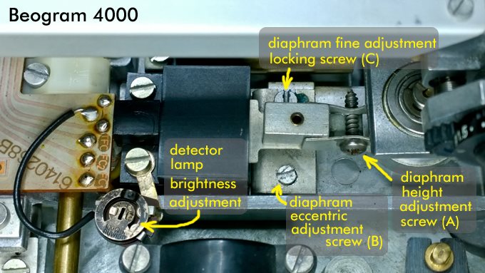

Yeah, I don't believe we have shown that procedure on the Beolover Blog before. Probably because it requires both hands and is so tedious. It also isn't a procedure that you should commonly have to do. Sometimes though, as in your case, the mechanics seem to have gotten too far out of adjustment.
Here is a photo I made a while back that shows all of the components relative to the tonearm balancing.
Normally the tracking force knob setting is fine and the counter weight is only slightly out of adjustment.
As I noted before, there is limited room for adjustment of the counter weight.
Too close in and the tonearm cannot pivot up an down.
Too far out and bracket that connects to the arm lowering lever will not work correctly.
With the tracking force knob removed as shown in the photo there should be no force at all since the spring loaded gear that applies the force is unloaded.
You can start at that point and zero balance the arm. That should result in a good setting of the counter weight.
Then you can attach the adjustment knob, set it to 1 gram and see what you read.
That is where you can get into a few iterations of setting the position of the knob.
If you cannot get 1 gram set with the adjustment knob then you will have to make a small movement of the counter weight.

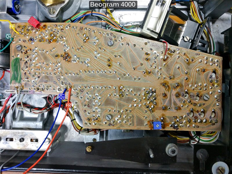

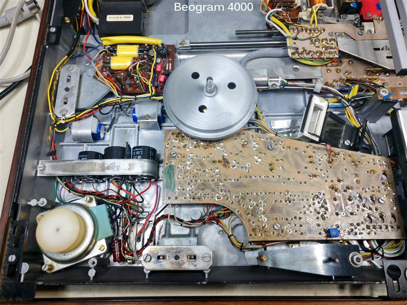

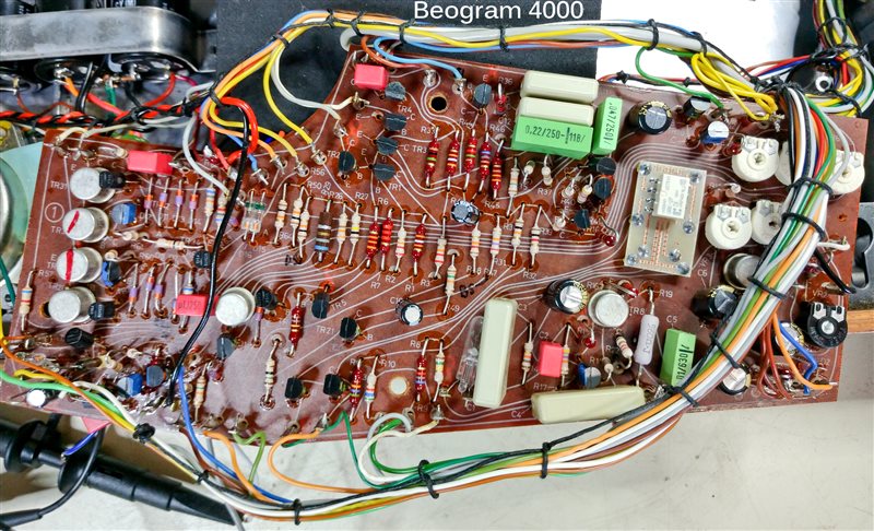

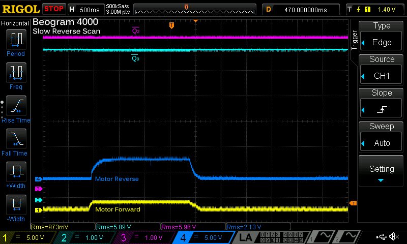

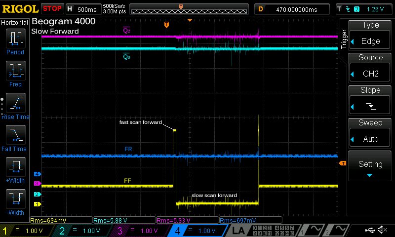

I connected up the Beogram 4000 turntable I have in my workshop to an oscilloscope and took some measurements of key signals involved with the servo motor. I looked at six signals:  FF, /Q0, FR, /Q2, the forward servo motor node and the reverse servo motor node.
My oscilloscope can measure four signals at a time so I divided my measurements up.
I exercised the Beogram while looking at the four control signals (FF, /Q0, FR, /Q2) and while looking at the motor nodes plus two control signals (/Q0, /Q2).
Here is my test setup.
I opened the Beogram and removed the platter.
Then I soldered on some test leads to the six nodes I wanted to measure. I connected a clip from the probe grounds to the Beogram gound.
Now to look at the measurements.

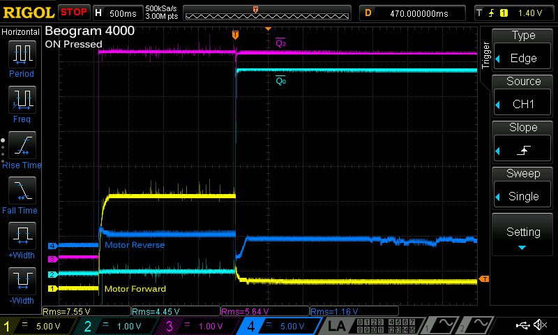

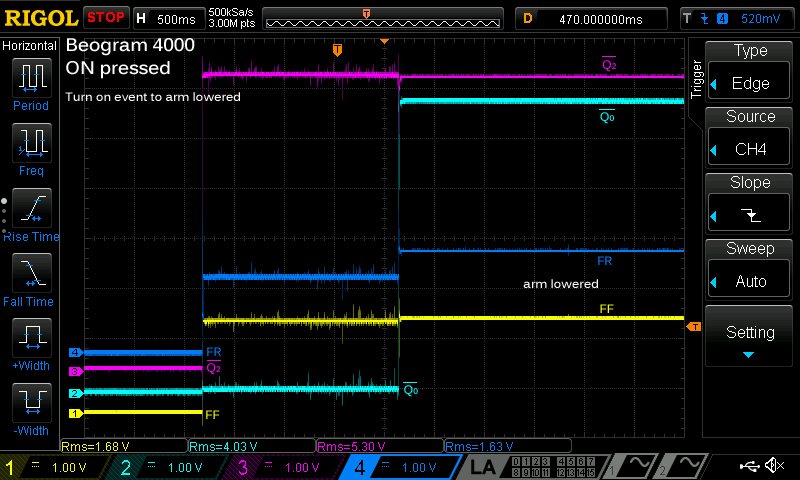

sonavor replied on Sun, Jan 10 2021 12:40 AM

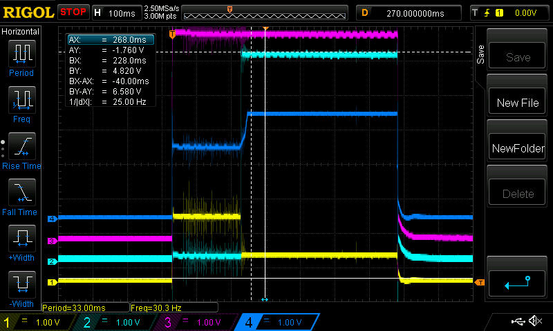

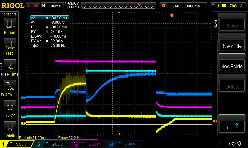

The first Beogram 4000 servo signal measurement is of the "ON" event.
Here are the four control signals during "ON"
Here is the "ON" event showing what is going on with the servo motor nodes

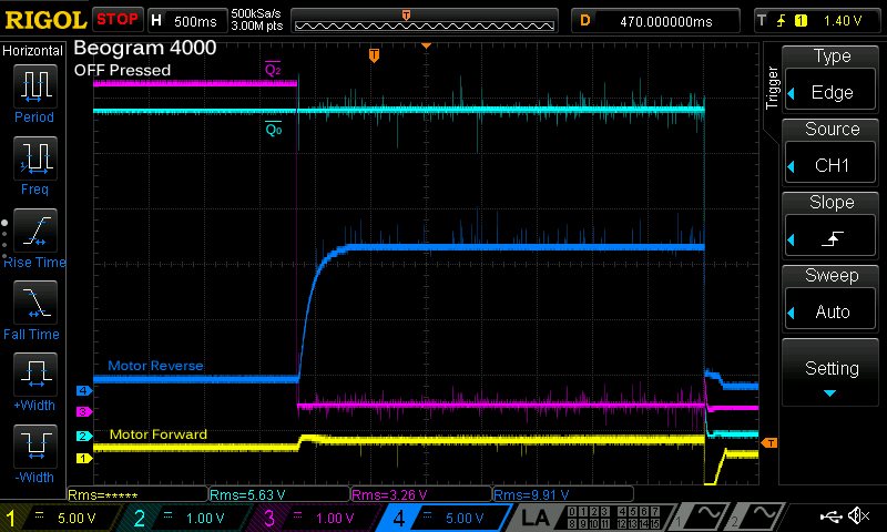

Here are the motor signals for the "OFF" event

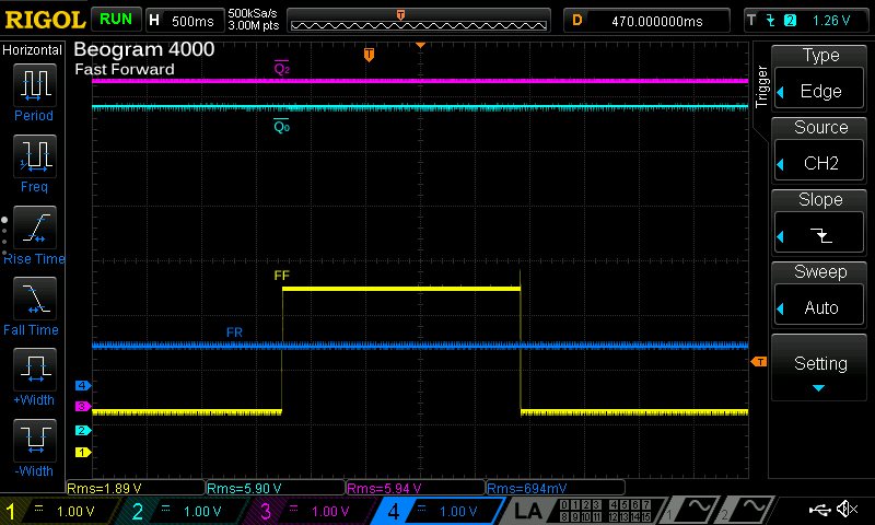

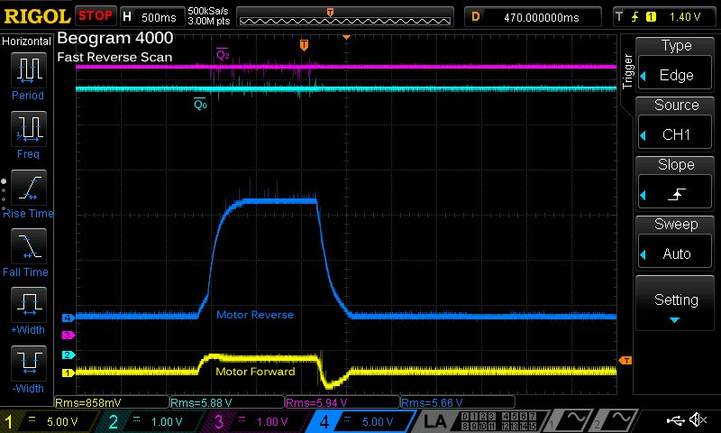

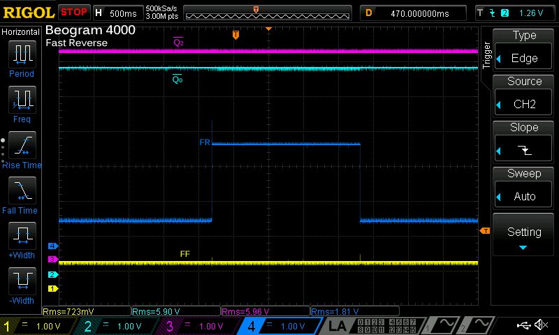

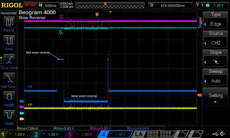

sonavor replied on Sun, Jan 10 2021 12:49 AM
On the Beogram 4000 servo motor during forward/reverse scanning here are what the control signals are doing.

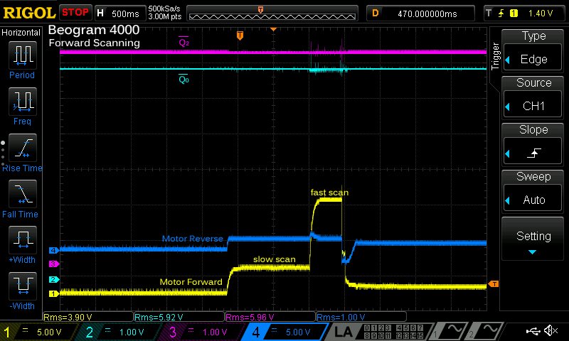

sonavor replied on Sun, Jan 10 2021 1:11 AM
Here are the servo motor nodes during tonearm scanning.

Hi Per,
Those Beogram 4000 waveform measurements for the servo motor are from a properly working Beogram.
From what you have described on your BG4000 and shown from your oscilloscope, I believe your issue is still what a control signal.
You always get a reverse servo motor command.  Even when you manually advance your tonearm, then plug the Beogram in (if I remember correctly).
On my BG4000, I can advance the tonearm out to the middle of a record, unplug the Beogram...When I plug the Beogram back in it remains off until I press "ON" again.
If we assume that your Beogram 4000 was working perfectly when you bought it then the current problems are due to the shipping damage. Something is out of place related to the BG4000 servo commands.
Otherwise we decide that this Beogram 4000 was faulty to begin with and the problem could be something electrical internally that has to be found and fixed.
The first scenario seems more likely.
My suggestion is to connect the scope to control signals and verify what state they are in for the "ON" event.
I will leave my Beogram 4000 and with the test wires soldered on in case we need to compare some other signals.
-sonavor

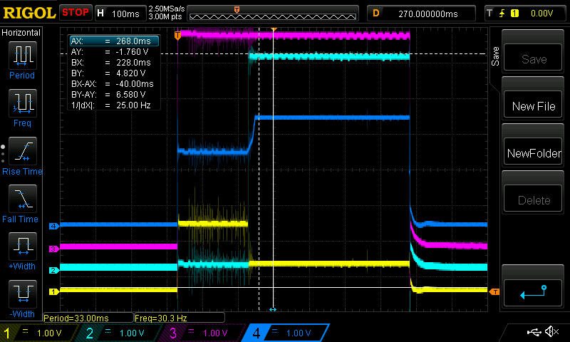

T4000 replied on Mon, Jan 18 2021 4:59 PM
Hi sonavor,
I tried to configure the oscilloscope the same way you did, and here are the results during Error #5*
Config at first pic (same voltage range as your oscilloscope)
Ch1: FF
CH2: /Q0
CH3: /Q2
CH4: FR
Config at second pic (slightly different voltage range to fit the image better)
CH1: Motor Forward
CH2: /Q0
CH3: /Q2
CH4: Motor Reverse
I hope my input make scene.
/Per
*Error #5: At ON, Slide moves ~1 cm to the left, then returning home again (https://youtu.be/HG-VJ3dCZc0).

Hi Per,
On your Beogram 4000 "ON" event you can see that your FF control signal only lasts for about 200msec before it stops and the FR control signal takes over. We know that the "FF" signal begins with your pressing of the ON button. The "FR" signal on the other hand is not coming from your actions so something else is causing that.
We need to investigate where that is coming from.
I think I would take apart the button panel where the leaf contacts are. Remove the contacts enough where you can see that the contacts are making contact and not making contact.  The same exercise might need to be done with the rest of the control switch mechanisms.
In that mode you would have to manually engage the contacts for the various control signals.
It may sound extreme but you don't want to keep looking at the result of the problem. It will take some digging to find the root of the problem.
-sonavor

T4000 replied on Tue, Jan 19 2021 2:53 PM
Hi sonavor,
Bingo!Thumbs Up
So, I first noticed that the error (#5, listed below) disappeared when I opened up the control panel. Same as last time (a month ago, if you recall). I now measured all switches again (at the wire pins). First with the oscilloscope, where I found a strange result at FR. As it should be grounded per default, I tried to short FR to ground. Then the error disappeared. Checked the switch with DMM, and it intermittently rests on the ground knob/pin. Not always. What bugs me the most is that I carefully tested this switch last time, and at the time, it was all OK. I will now try to clean the FR pin again, then I hope this error is gone for good.
Now the question is what to focus on next. The counterweight issue, I will look into soon. It's not stopping the function right now, but I know I have to fix it.
Current error status:

sonavor replied on Wed, Jan 20 2021 3:14 PM
Hi Per,
Yes, my method is to re-center the tracking sensor control where it is as close to the ideal position and all of the adjustment screws are at their centered positions (so they have room for adjusting).
Here is an old thread of mine on the Beoworld Workbench Forum that shows the components involved. A repost of one of the photos is here (please excuse that I mispelled "diaphragm" in the picture :-) ).
I begin these adjustments with the platter removed.
A first thing to try is to just see how much out of position the tracking sensor is.
You might get lucky and all it needs is a quick adjustment of diaphragm eccentric adjustment screw (B).
First loosen the locking screw (C). Then see if you can turn screw (B) such that the arm does not advance by itself when lowered.
Screw (B) has limited range so if you rotate it to where it stops (DO NOT OVER TORQUE IT) and the tonearm tracking still advances the arm by itself then you will have to move to a more in depth resetting of the tracking sensor assembly.
Hopefully your Beogram only needs a little adjustment of screw (B). Perhaps screw (C) had come loose.
If the quick adjustment of screw (B) could not solve the problem then it is likely that your Beogram shipping incident caused the diaphragm to shift where it mounts onto the tonearm base. That means you will have to reset the diaphragm position on the base first.
My method for this case is to loosen the diaphragm height adjustment screw (A). The height of the diaphragm is shown in the service manual but there is also a left and right rotation of the diaphragm that defines where slit in the diaphragm rests over the tracking sensor (inside the black box).
In addition to screw (A) I loosen locking screw (C) then rotate the eccentric adjustment screw (B) where it is centered...meaning I can rotate it left or right if I need to later.
With those initial adjustments made I slowly and carefully try to adjust the diaphragm by pivoting it until I have the tracking sensitivity almost where it needs to be (per the service manual). Note that pivoting (rotating) the diaphragm means that you also need to be aware that the diaphragm height doesn't get off where it needs to be.
So the process is with the Beogram 4000 platter removed, make an adjustment, press the ON button and let the arm move and lower...check to see how sensitive the tracking is. I consider the initial position good when the arm lowers, the arm does not advance on its own but I can get it to move with a light nudge to the side of the tonearm. When that point is reached I gently tighten screw (A) being careful that the diaphram position does not change as I tighten the screw.
Now the tracking should be at the starting position I like it to be for the final tracking adjustment as spelled out in the service manual.
That is where you put the platter back on the Beogram but do not install the platter belt.
You are going to rotate the platter by hand.
A record is placed on the platter (the service manual calls for a B&O test record that I have never been able to find).
The Beogram is turned on and you scan the tonearm forward to the middle area of the record.
When the arm lowers onto the record it will just sit in the selected groove.
Manually rotate the platter and observe how many revolutions of the platter before the Beogram servo motor begins to advance the arm.
It should being within two revolutions then advance the arm every revolution after that.
If the servo does not advance then this is where you begin to use the diaphragm eccentric adjustment screw (B) to fine tune tracking sensitivity.
Screw (B) has a limited range of adjustment left and right. That is why it is important to have screw (B) in a centered starting position so you have room to make the fine adjustment.
Once the tracking sensitivity is correct you gently tighten the adjustment locking screw (C). Later you can apply a dab of removable glue to screw (C) so it can't easily come loose. However, I recommend you not do that until you have tested record playing on the Beogram for a while.
As on the other adjustments, be patient and take your time.
-sonavor

T4000 replied on Wed, Jan 20 2021 8:04 PM
Hi sonavor, Jacques and Heath Robinson,
The adjustment of the Diaphragm is now done. Screw A was needed. I would assume that fixed both error #3 and #4, right?
That would give the updated error status:
  • Error #1: Tone arm lowering even if no record is present. (Permanent error)
  • Error #2: Slide reaching end position, but servo motor continues to push the Slide to the center. (Intermittent error)
  • Error #3: Slide stops at 12" position, then slowly moving towards the center, then returning back home. Occurs with and without record. (Permanent error)
  • Error #4: When playing a record, the arm lowers, but after 1s the servomotor starts and the arm scratch across the record for about 0.5-1cm. (Have not been able to play any records in a very long time, so I don't know about this error)
  • Error #5: At ON, Slide moves ~1 cm to the left, then returning home again

sonavor replied on Wed, Jan 20 2021 9:06 PM
Yes, it should.
Error 1 is either due to any of the following:
- Fixed arm lamp is burned out
- Fixed arm sensor is not transmitting a good signal.  This could be due to the position of the fixed arm lamp not being positioned correctly.
- Problem with the circuitry that supports the fixed arm sensor.
I would suspect the lamp or positioning of the lamp as the most likely sources of the problem.  Especially when you said your problems occurred after the shipping incident.
Error 2 sounds like the end stop switch not always making good contact.
