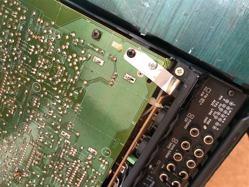

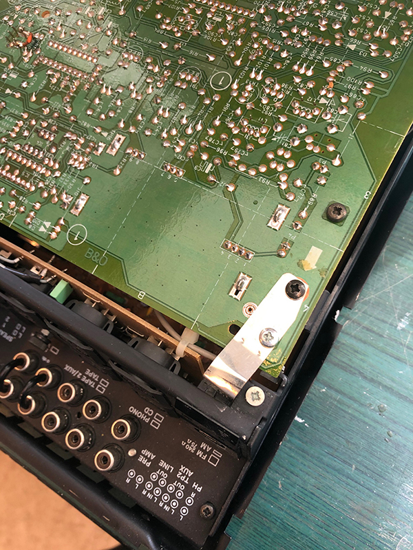

Problem solved
It turned out that I accidental bent down the clip in foto (right corner of the unit when looking from the backside). It is supposed to touch the lid for grounding. After bending it upwards no more clicks!
So don't touch that clip if you open up a Beomaster 5500 and probably also 5000, 6500 and 7000.
