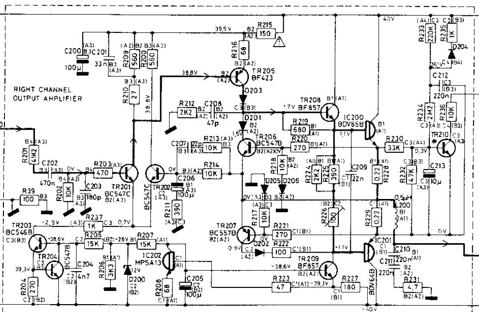

I have been struggling trying to get one working Beomaster 5000 working out of 3 non-working receivers.
Two of them had failures in the PC board in the same trace leaving the rectifier.  Must have been a design flaw in the PC board.
After repairing these, and finding what I thought were 4 good BF857 (TR108/208 and TR109/209) and four good Darlingtons (BDV64B and BDV65B) I had a spectacular failure which blew the lid off of the BDV65B on the right channel along with a nice puff of smoke.
I removed all 4 Darlingtons and am focusing on getting all the DC voltages correct before trying some new parts.  I put some test wires in the base of each of these transistors.
Currently moving left to right, I'm measuring -40.6V, -40.8V, -40.8V and -40.8V on the base of the 4 Darlington transistors.
I also measured the collectors of the 4 BF857 and come up with 40.6V, -40.8V, 40.7V and -40.9V.
The only measurements that make sense are the 40V measurements on two of the BF857s as they have collectors wired directly to the 40V power rail.  The others should measure -1.1V (same as the base of the BDV64Bs).
So the base voltage for all 4 darlingtons is about -40V when it should be around -1.1V.  In other words, way off.
Does anyone have a suggestion of where to look for this?  Both channels seem to behave the same way.

Dillen replied on Wed, Nov 24 2021 6:30 AM
You cannot measure voltages without the components installed.
When you powered it up, did you monitor the idle current(s)?

Yes, I did adjust the idle trimmers when I started out.  And more recently, I replaced them both because they were original.  The fact that the right channel BDV65B just exploded last time I had it all put together has me nervous about trying it again so I'm going slow.  Can a bad transistor result in this kind of excitement or is it more likely a voltage condition going into a formerly good transistor?
These darlington transistors are a bit strange since it looks like they have a resistor path between the base and emitter so I'm not 100% confident have have a set of 4 good ones to put in!

Well a few evenings finally paid off and I have a working Beomaster 5000.  There were several problems, many of which I assume are common with these.
I had two places on the board where previous excitement had burned traces.  One was right off one of the rectifiers and the second one was on the trace that works its way up the right side of board 2.
Some of the foils around the BF857 transistors were broken, presumably from the transistors wiggling back and forth.
I took out all 4 BF857s.  One of them had a short it in and I replaced all 4.  Looking at the PC board, several of the foils around these transistors had lifted because I think this part of the board gets warm in normal operation.  More short wire repairs to double-check all 12 connections and continuity testing to make sure they were in the right place.
Now I installed 4 new darlingtons and set the no-load current to 11mV with new trimmers I had installed.  It powered up, and the left channel worked.  Right was dead.  I traced the signal path and found that TR204 was shorted so TR203 wasn't firing the signal.  In addition, TR201 was not passing on proper voltages so I removed it.  It tested as a functional transistor, but the HFE reading was way less than its partner TR202.  So I replaced the pair.  Now I had a signal all the way through and the right channel was fixed. Woo hoo!
I recapped the amplifier board since I now had it working and replaced the relays on the pre-amp board and the amp board.
Sadly, the remote didn't work and I couldn't find 34 volt on the IR board.  This fault was traced back to an open 100 Ohm resistor in the rectifier circuit (R6) on the amp board.  When I replaced this I had the proper voltage and my remote worked as it should with one exception - the mute key doesn't seem to work.
I tried the mute function on the front panel and that doesn't work either.  Pushing the Mute side of the front panel and holding it does shut the receiver off. Plugging in the headphones does trip the mute relay and shuts of the main pair of speakers.
Digging into the mute circuit now to try to figure it out.  Or, I may just put it back together and call it "99.5% good"!
