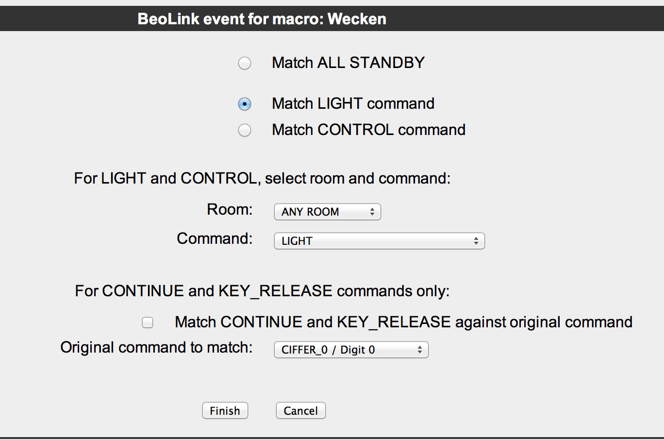

On MLGW, please have a look at the following image -->
You set Beotime to send LIGHT - 1 and trigger in MLGW to LIGHT - 0.
Can't work...
Set trigger to LIGHT - 1 too.

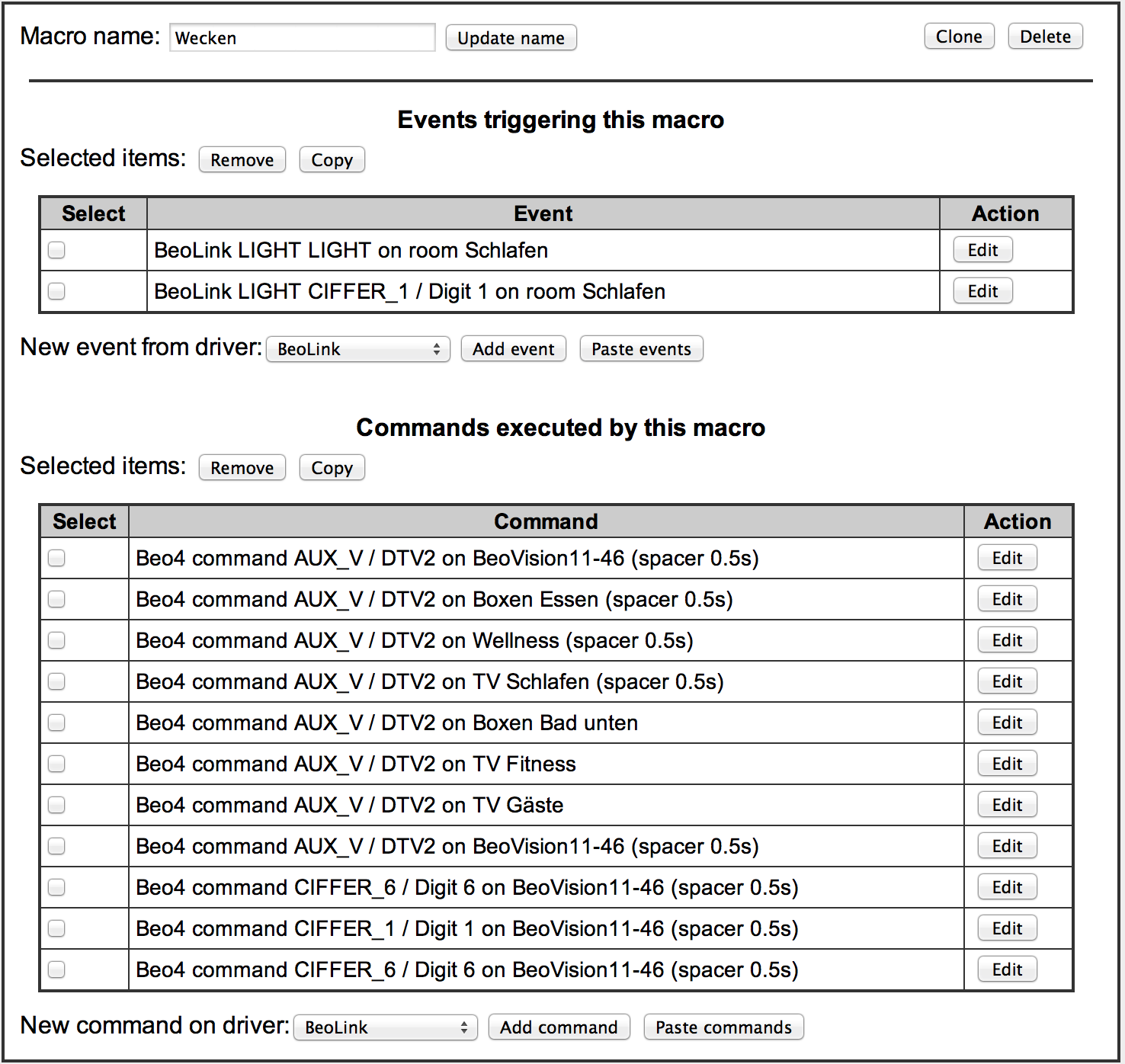

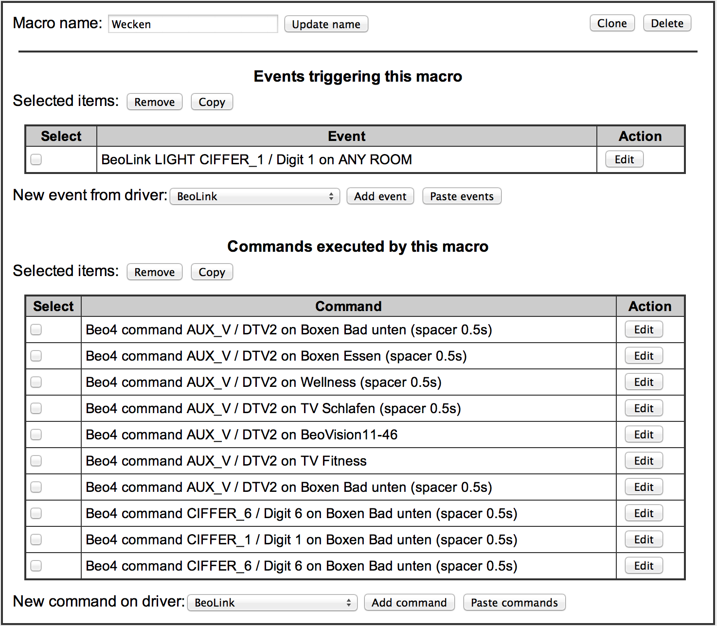

Something I make wrong. Please look at the image below, this is my configuration. The same I made also with a virtual button, this works fine and turns on all devices like i want it.
Try to delete the first command light - light. Second row Light - 1 should work...

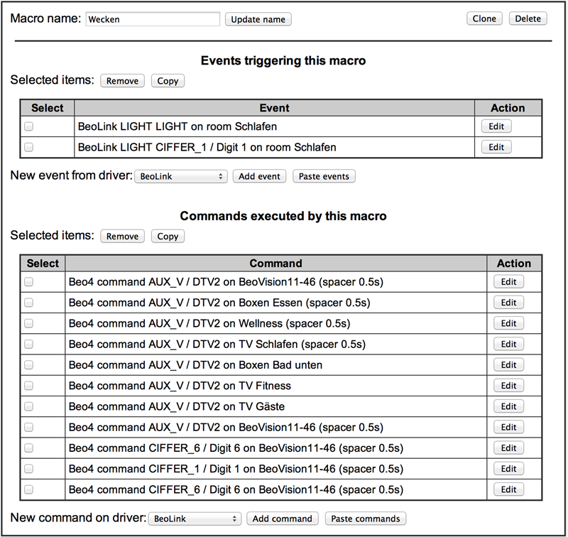

I changed the settings, please have a look on image below. It doesn't work. What do you mean, could it be, that my option configurations are wrong, so that the light commands can't received through the devices? With the actual option settings all works fine, but not light commands - is there a mistake?

you said this macro works with virtual button, but i can't see a virtual button event triggering this macro...?
Hermann_5F00_:I changed the settings, please have a look on image below. It doesn't work. What do you mean, could it be, that my option configurations are wrong, so that the light commands can't received through the devices? With the actual option settings all works fine, but not light commands - is there a mistake? Some of my devices are old and they could possibly not receive light commands. But the BV11 should do it, i have the newest software on it. When I look in the web-monitor tool on mlgw, then i can't see something when I push on beo4 light and chiffre 1. Also when i try it with BeoTime (alarm light and chiffre 1). When I use a virtual button, then i can see informations on web-monitor - is this monitor behavior correct?
