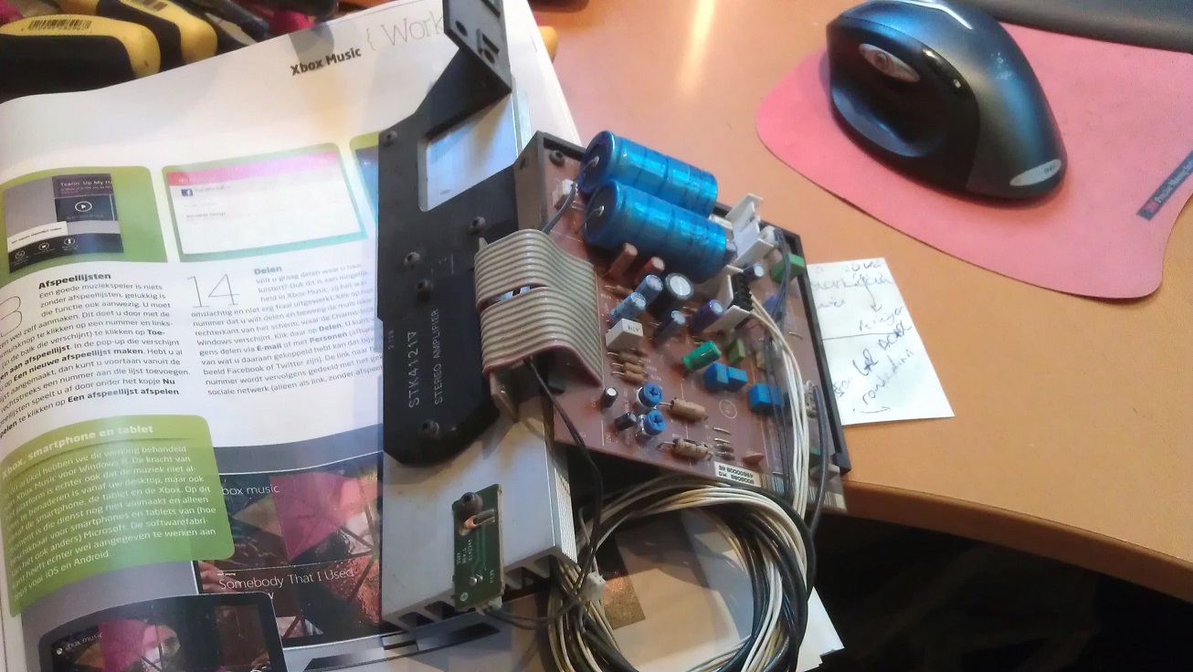

These are the ones to look for.
Check voltages, audiosignal, soldering etcetera.
