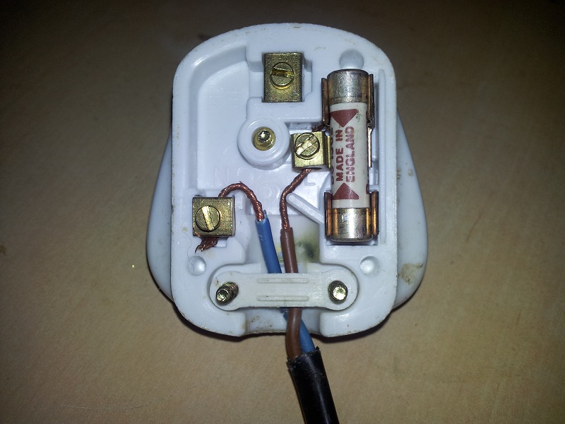

This plug was fitted to a Beomaster 7000 that I picked up a couple of days ago as part of a complete 7000 system. The CD and the Beogram plugs were not much better, I wonder what the Beocord will be like??
It was in use, in the sellers home.

My god. But it has a fuse! Smile

Yes, the wrong value. That was a 13 amp fuse!

Big SmileThere already looks to be electrical "flash" marks, just above the cord clamp............................ not as big a one as this would have made when it went up mind!Laughing

Good one, you can drive a 3 Kw motor with 240V/13 A

Joey - I have 3 amp fuses in all my 5005 and 5500 separates, except the BM 5005 and BM 5500 which have 5 amp fuses, is that what they came with originally do you think ?

The truth is that they probably came with a 2 pin Euro plug which is not fused at all. B&O supplied a 4 way extension lead which accepted the Euro plugs and the extension was fitted with a UK 3 pin plug with a 13amp fuse.
The fuses that you are using are about right.

What is wrong with that ??? it will live to it's brand's name(BANG)Stick out tongue.

The plug fitted to the Beocord had no cable grip at all!!!
My main reason for this post was to demonstrate the poor quality of the fitting of this UK 3 pin plug rather than the size of the fuse.
There are so other more important things wrong with the fitting, the size of the fuse is largely irrelevant.
I am afraid that there is a strange habit in the UK of cutting the 2 pin plug off and fitting a standard UK 3 pin plug. This, instead of buying a low cost adapter which is simple to fit and much safer.
Much of the equipment that I sell has been butchered in this way and it would seem that the majority of people are incapable of performing the simple task of fitting the plug properly!
