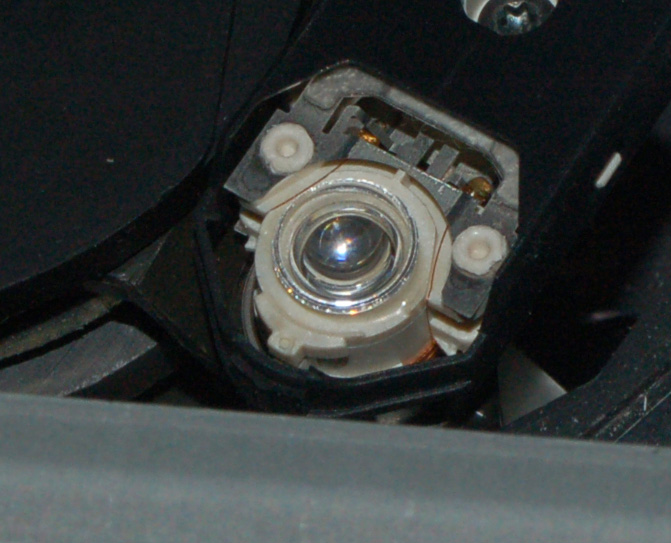

It looks to me like there is a clear plastic cover over the CD lens. Is this removed in order to clean the lens behind it. If so, how is it removed? Or is it cleaned another way. Also I notice that the CD rotates on a wobbly axis. The central axis has a ball joint type thing I notice. Could this be relevant?

chartz replied on Mon, Sep 16 2013 6:26 PM
Oh, could it be that a new laser was fitted and they forgot to remove a protection cap? Any photos please?
The wobbly CD holder thing (not the CD itself mind you) is normal. Stupid and ill-designed, but normal!

CD laser photo added - I tried to wipe it with IPA but the cover just rotates with the cotton bud
The CD rotates on a wobbly axis - is that right?

How do I clean it, I notice there is what appears to be a clear plastic cover over the laser, which rotates with the circular motion of a cotton bud. This doesn't look like the lens of the laser.
