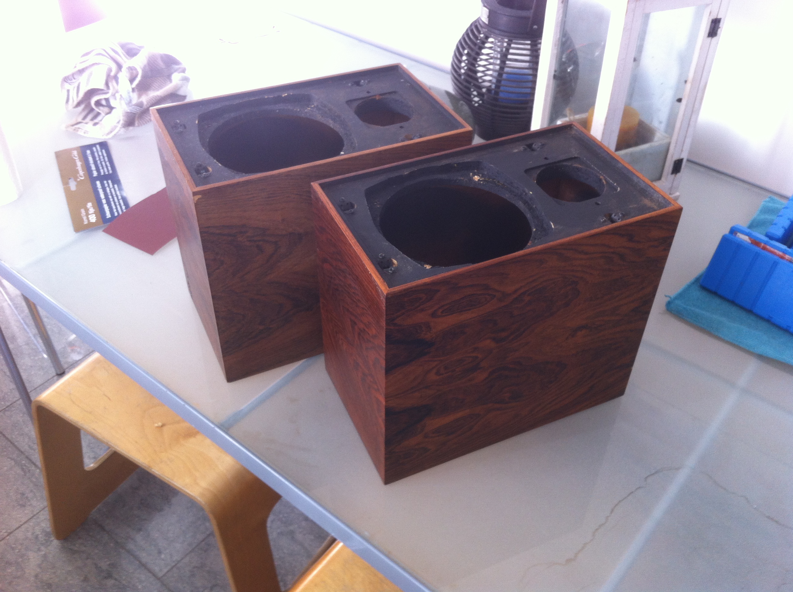

If you want to get the wood like new, clean with paint thinner or acetone, sand with 200 grain, until the wood has an even color and all smaller marks and nicks are gone, then sand with 400 grain. Clean off dust, apply teak or boiled linseed oil, let soak, wipe off excess, let dry 12-24 hours, sand light with 400 grain, apply oil, let soak, wipe off excess. let dry 12-24 hours. Polish with lint free rag.
For lubricating the BG, use sewing machine oil or Liquid Bearings.

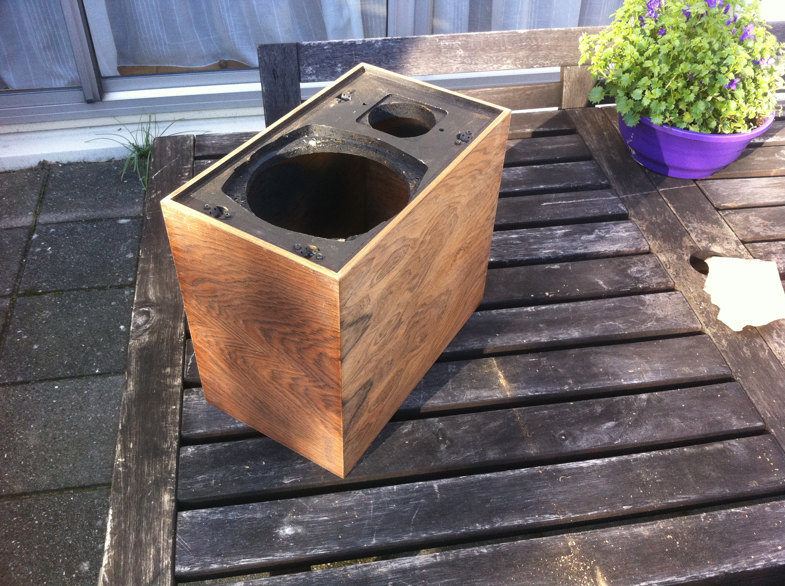

Thank you Søren! I tried it first with my beovox 1500's, and after the first sanding and oiling they look a lot better than before! Tomorrow round two.

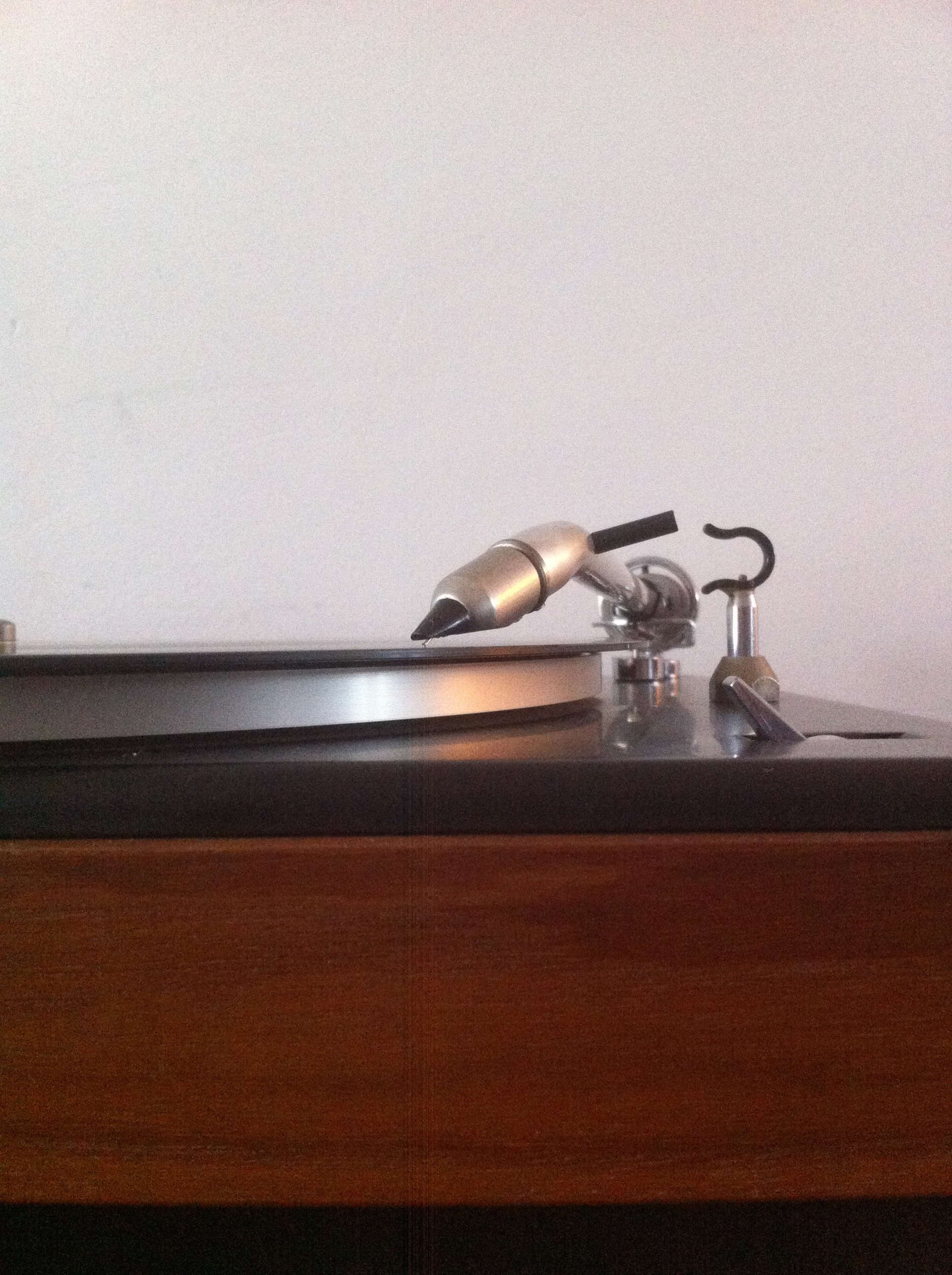

The Beovox 1500's look al lot better now. Next will be the beomaster.
But first: the beogram 1000. It wasn't working when I got it, and after cleaning and lubricating it, it still did not work... Now I disassembled it completely, and I think that it should work when put back together. When apart, the damage and nasty spots on the metal became visible, and as they might be hard to spot when it is in the radiogram, I want it to look perfect. However, I'm not certain what colour... Maybe silver/grey again, or black, or maybe green, like this beogram 3000!

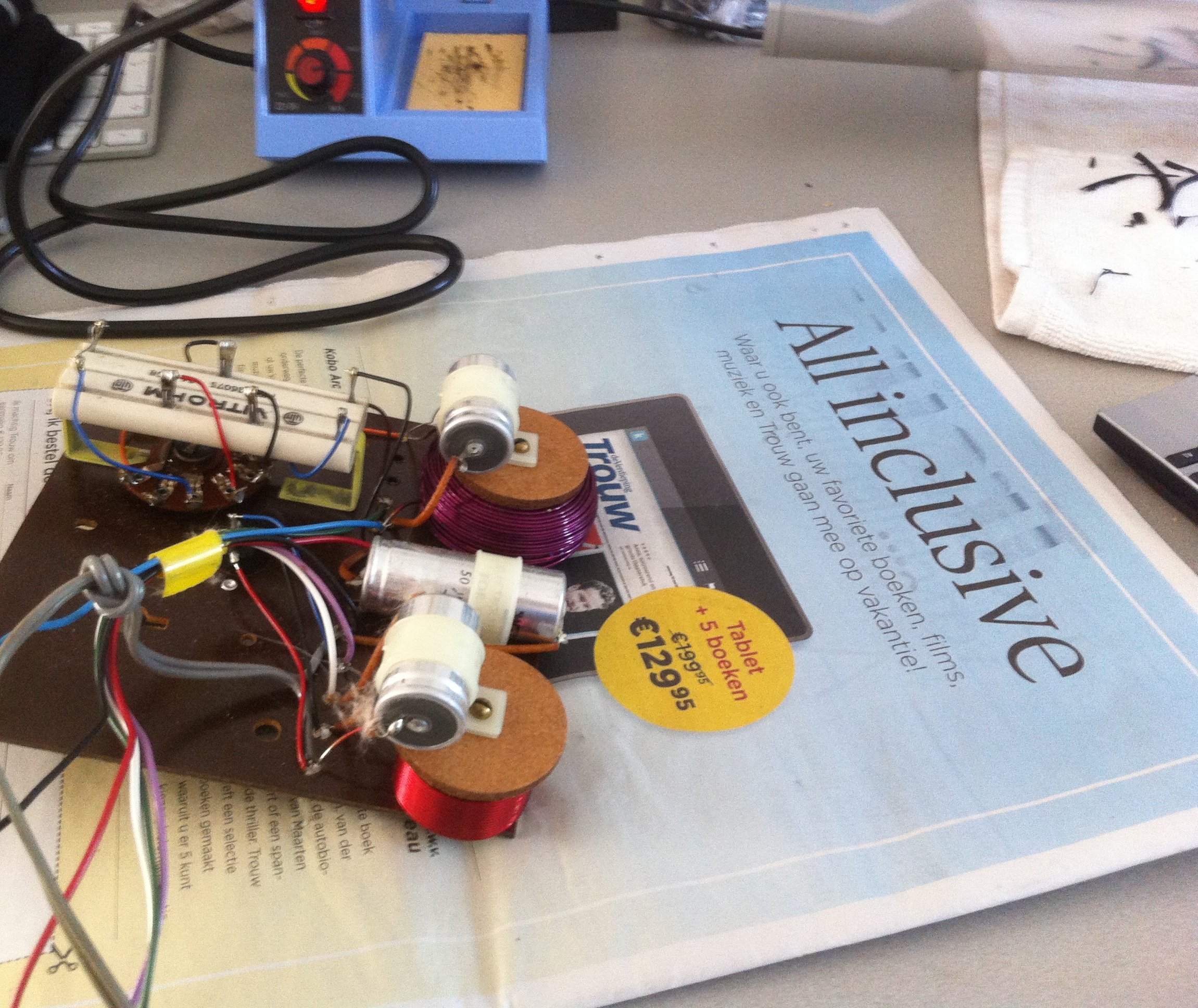

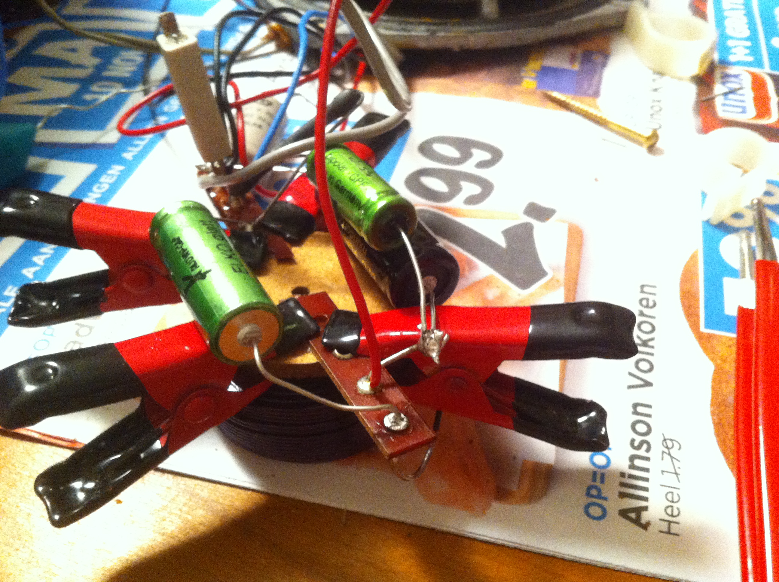

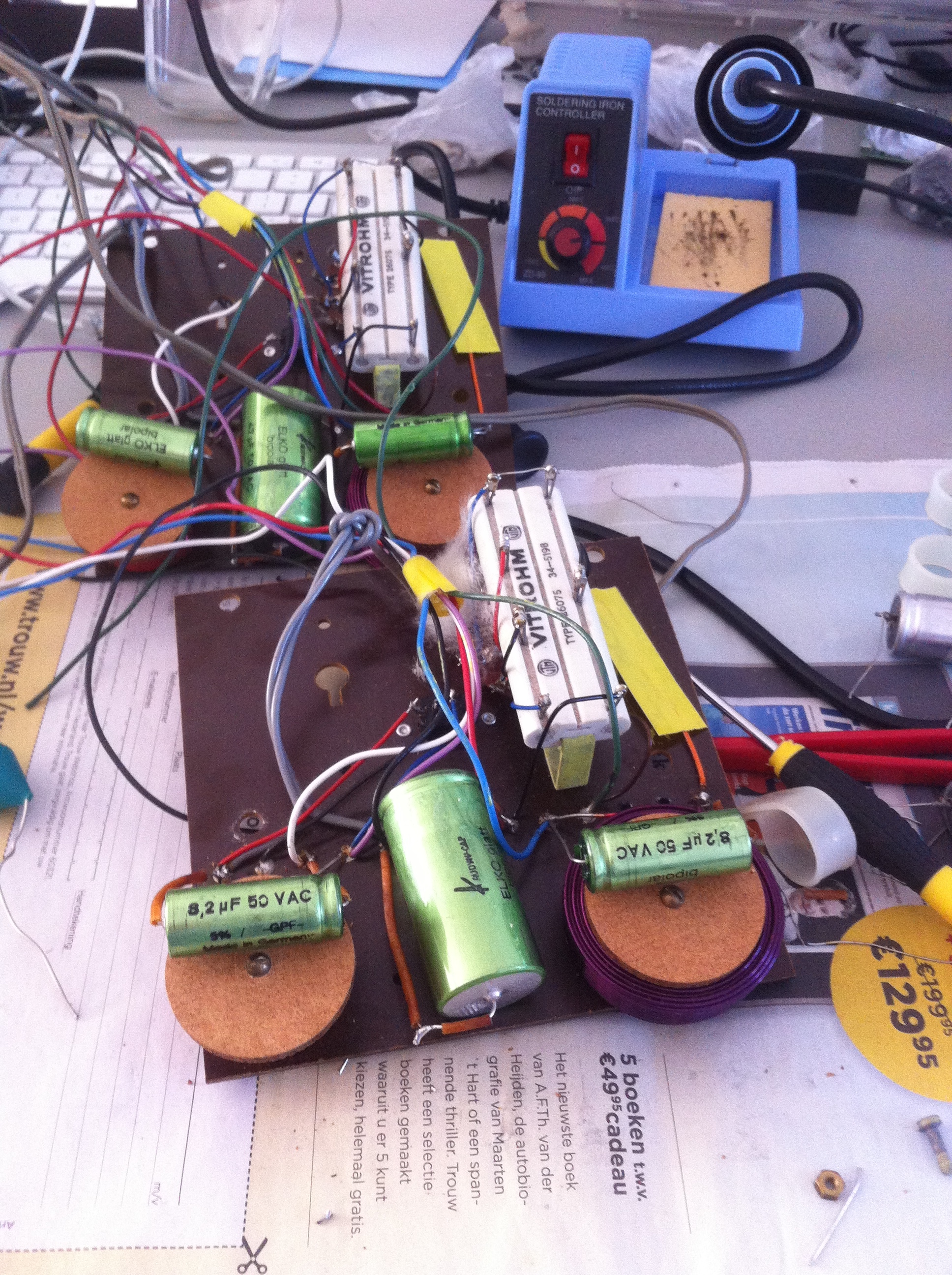

I've been working on my beovox 1500's today. after a lot of sanding and oiling, they look a lot better now! Still need some veneer, glue, a steady hand, patience and some more sanding and oiling to get them perfect, but for now they look good. Pictures will follow.
Recapping the crossover boards: Before - After

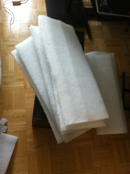

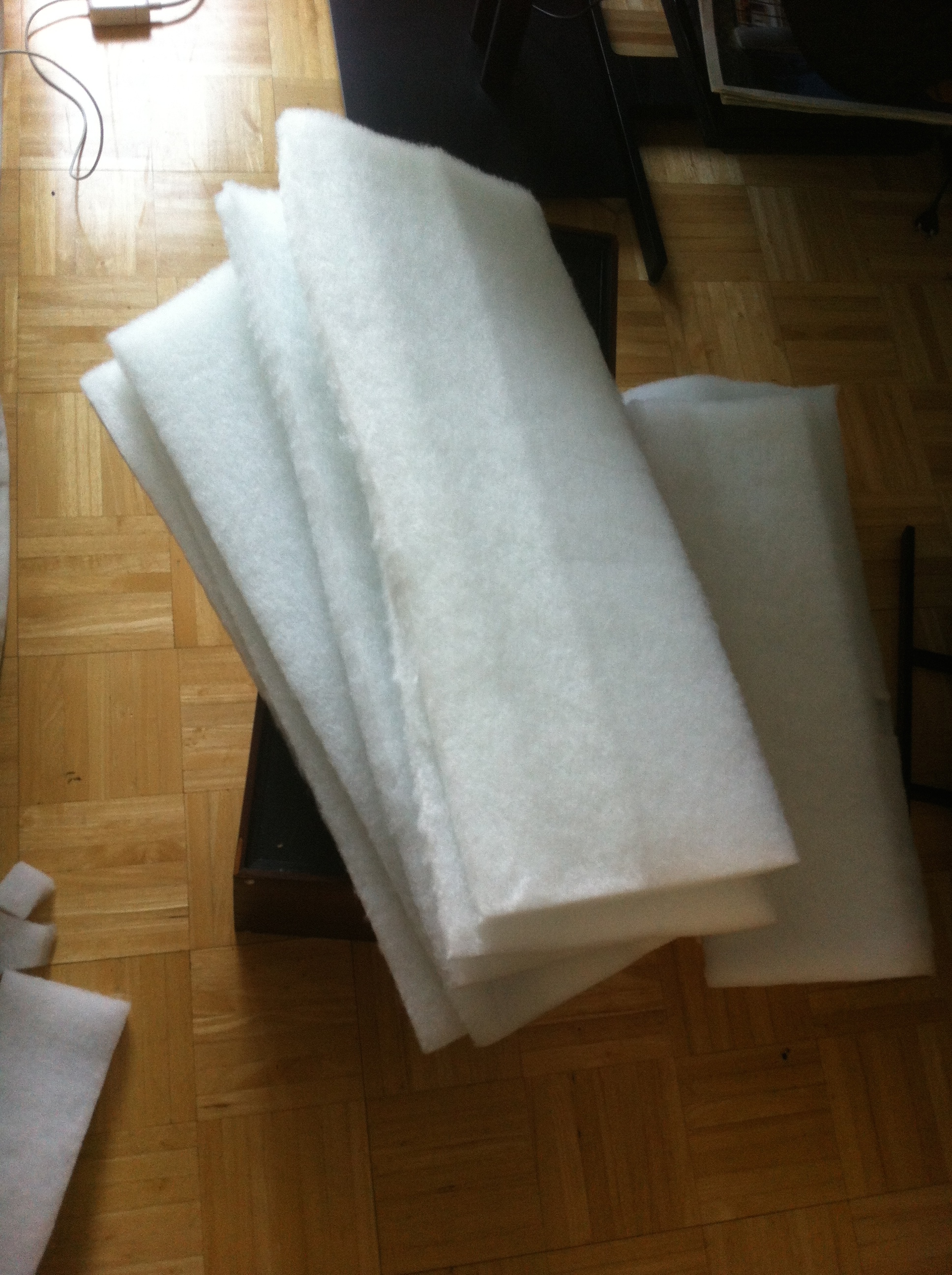

New, more healthy and better sounding (IMHO) damping material. Cutting it the right size:
Filling them up
And preventing more damage
Hopefully I will have some time tomorrow to attach new, longer speaker cables to the crossovers and reassemble them. Will post an interesting picture of the crossover board as well! :-)

Looks good, but if you cant use the caps fasteners, at least glue the caps with silicone.
Wouter
Netherlands
Posts 302
Wouter replied on Fri, Jul 11 2014 12:15 AM
Søren Mexico:
Good point Søren! I actually used some wood glue to glue them to the wooden plates on top of the coils, works quite good!
Still, Yes - thumbs up

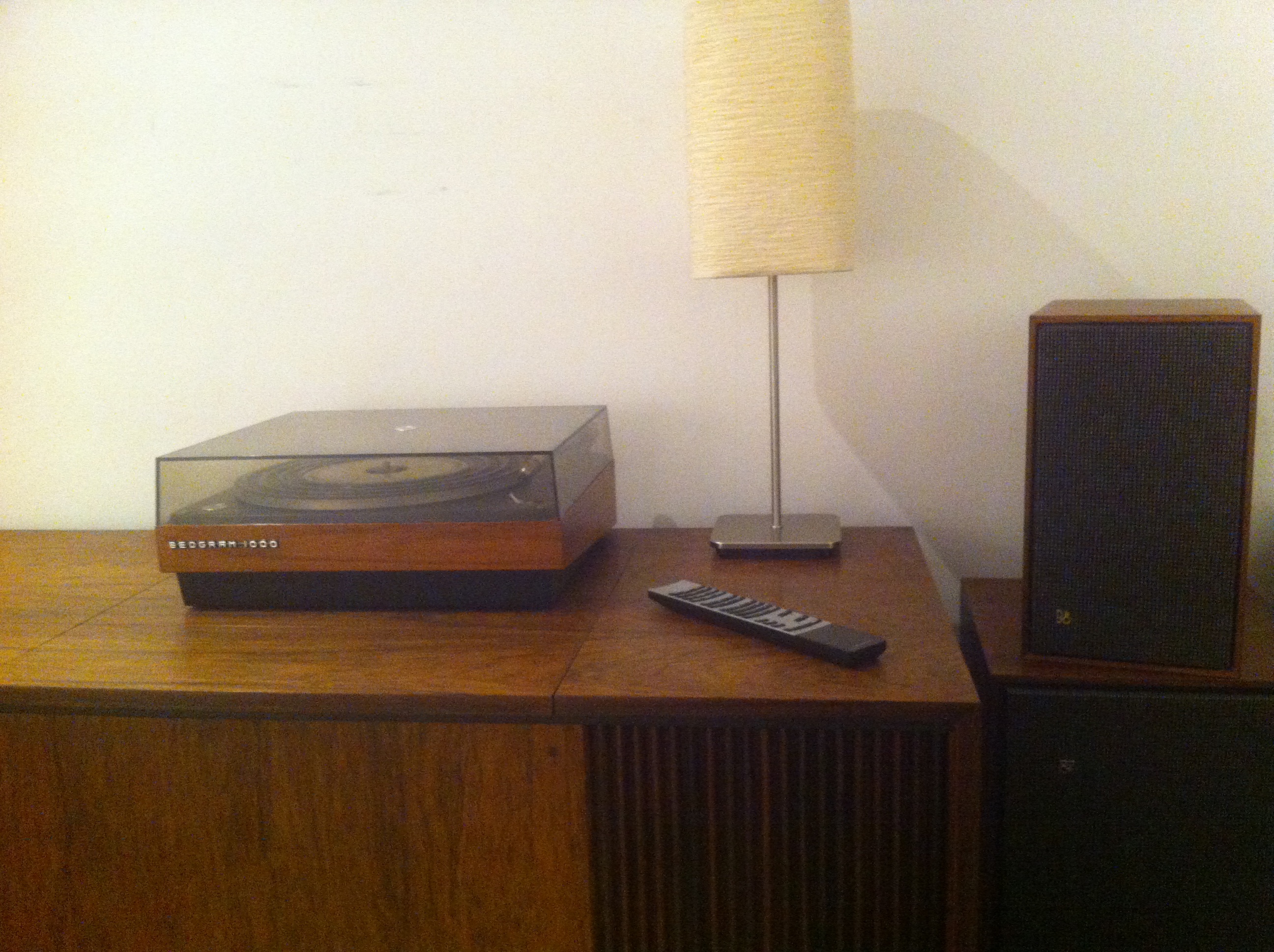

Leslie
Top 25 Contributor
the Netherlands City
Posts 5,423
Silver Member
Leslie replied on Sat, Jul 12 2014 8:40 PM
Is this yours Dave? Perfect match!

Wouter
Netherlands
Posts 302
Wouter replied on Sun, Jul 13 2014 7:27 PM
Thanks for the pictures! They all look good, but I think I'll just stick to original which is more close to silver than grey. I really like my black beogram 1000, but I think it will look too dark inside the cabinet. When I get my hands on another beogram 1000, I'll definitely paint it racing green like the one above!

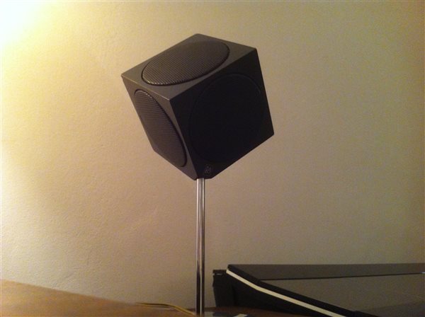

Concerning the cubes: I found the first one!
At least, the biggest part of it! Wondering where the other one is... It should be somewhere!

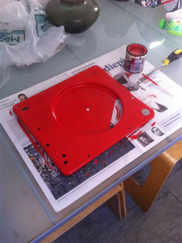

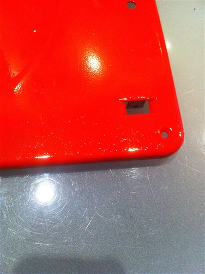

Okay, don't know whether or not it will turn out nice, but this will be the colour! Tomorrow the next layer!
Picture does not show the colour very well, Ferrari red it is!
Wouter
Wouter
Netherlands
Posts 302
Wouter replied on Tue, Aug 5 2014 7:01 PM
Third layer:

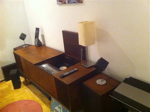

Last weekend I replaced my "modern" (90's) setup with the golden era equipment. The last days I've only been listening to the vintage equipment and it is great. Sometimes I grab my beolink 1000 to turn down the volume, but that isn't going to work...
The Cx's are connected to my bc9500, but will have to make room for a pair of cubes someday.

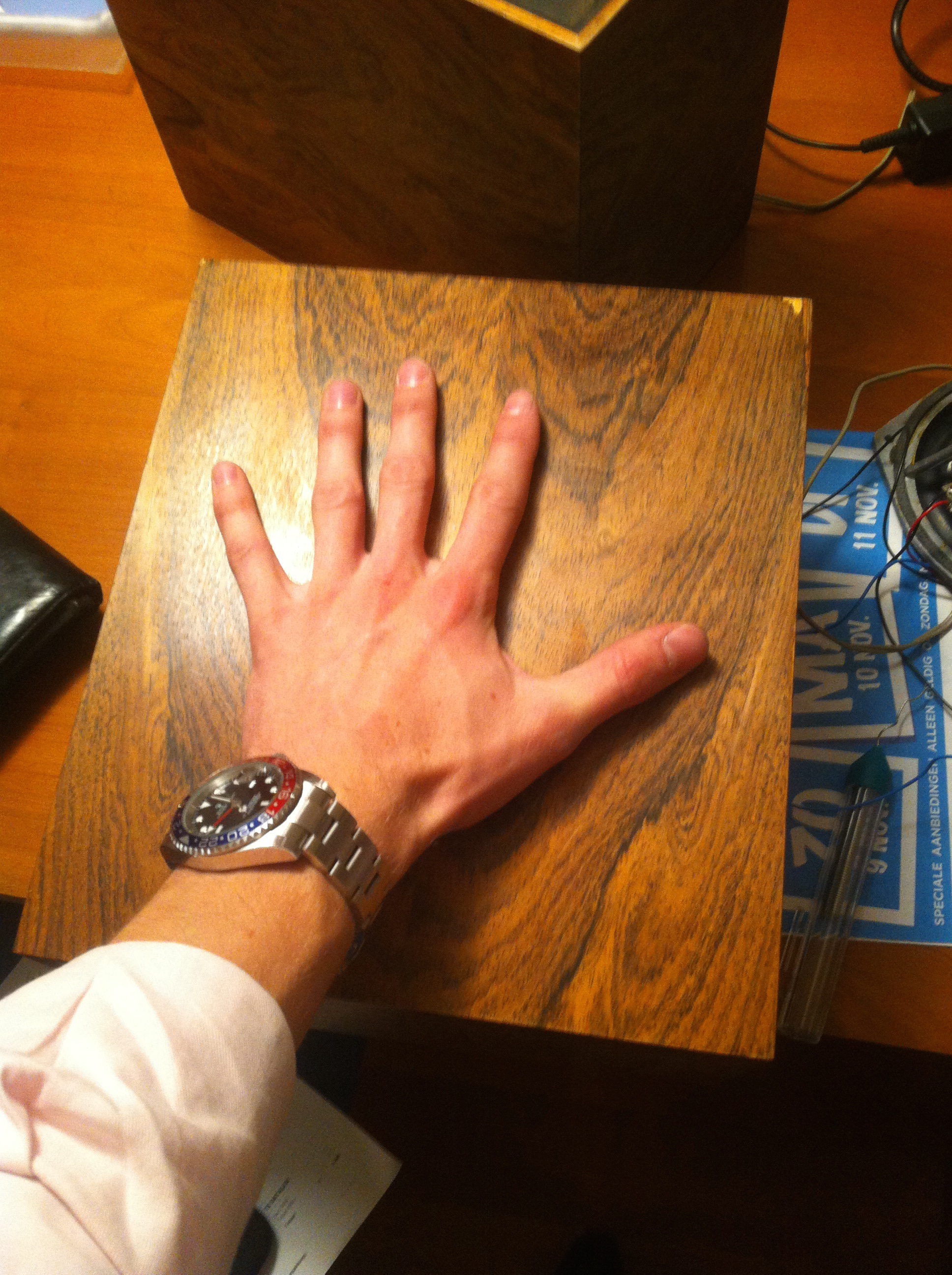

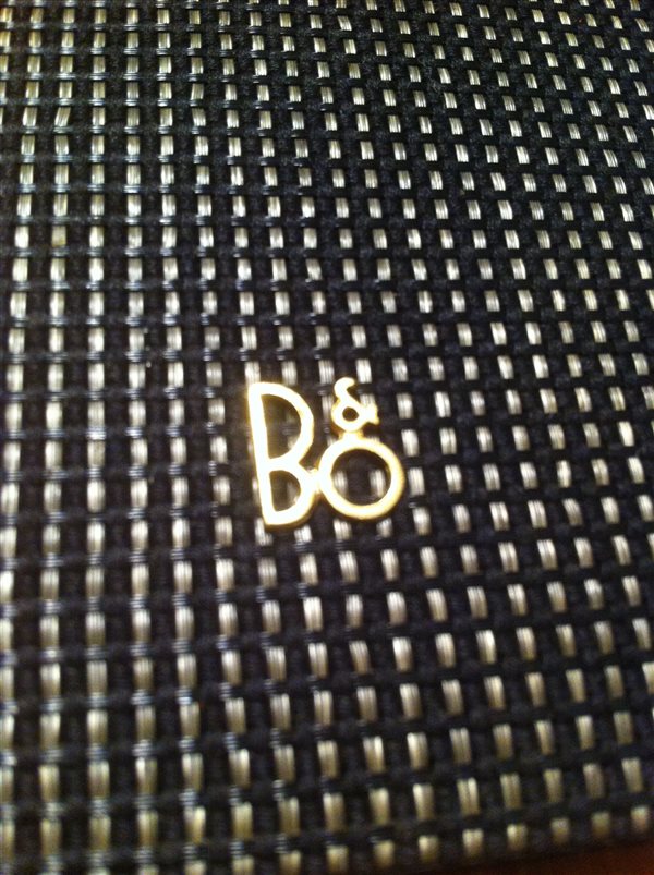

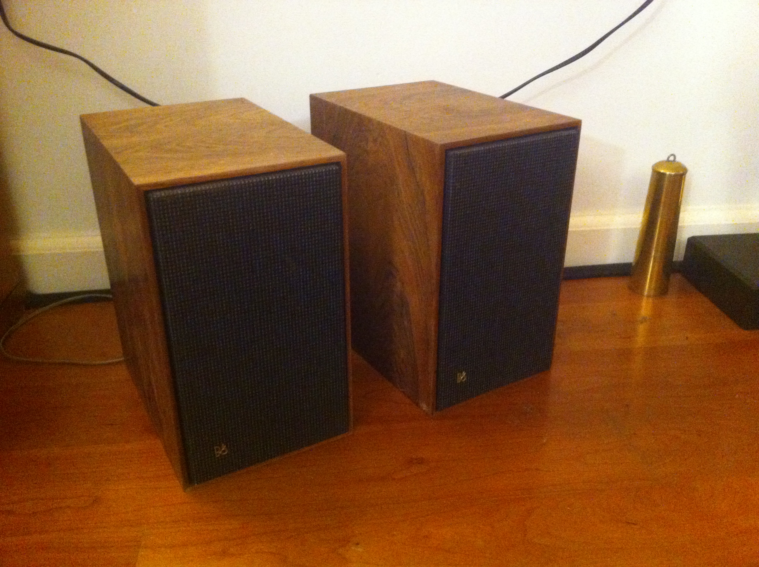

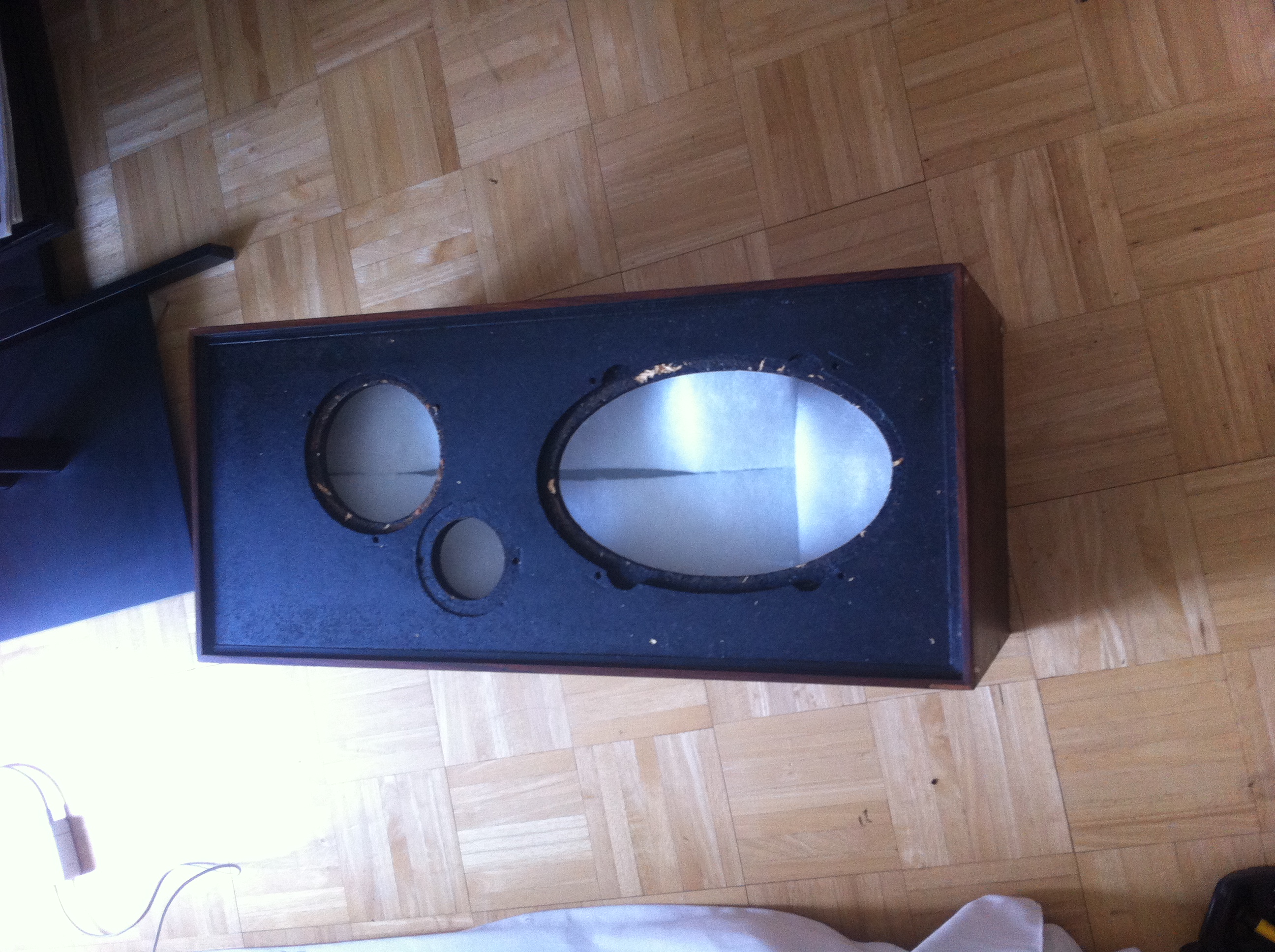

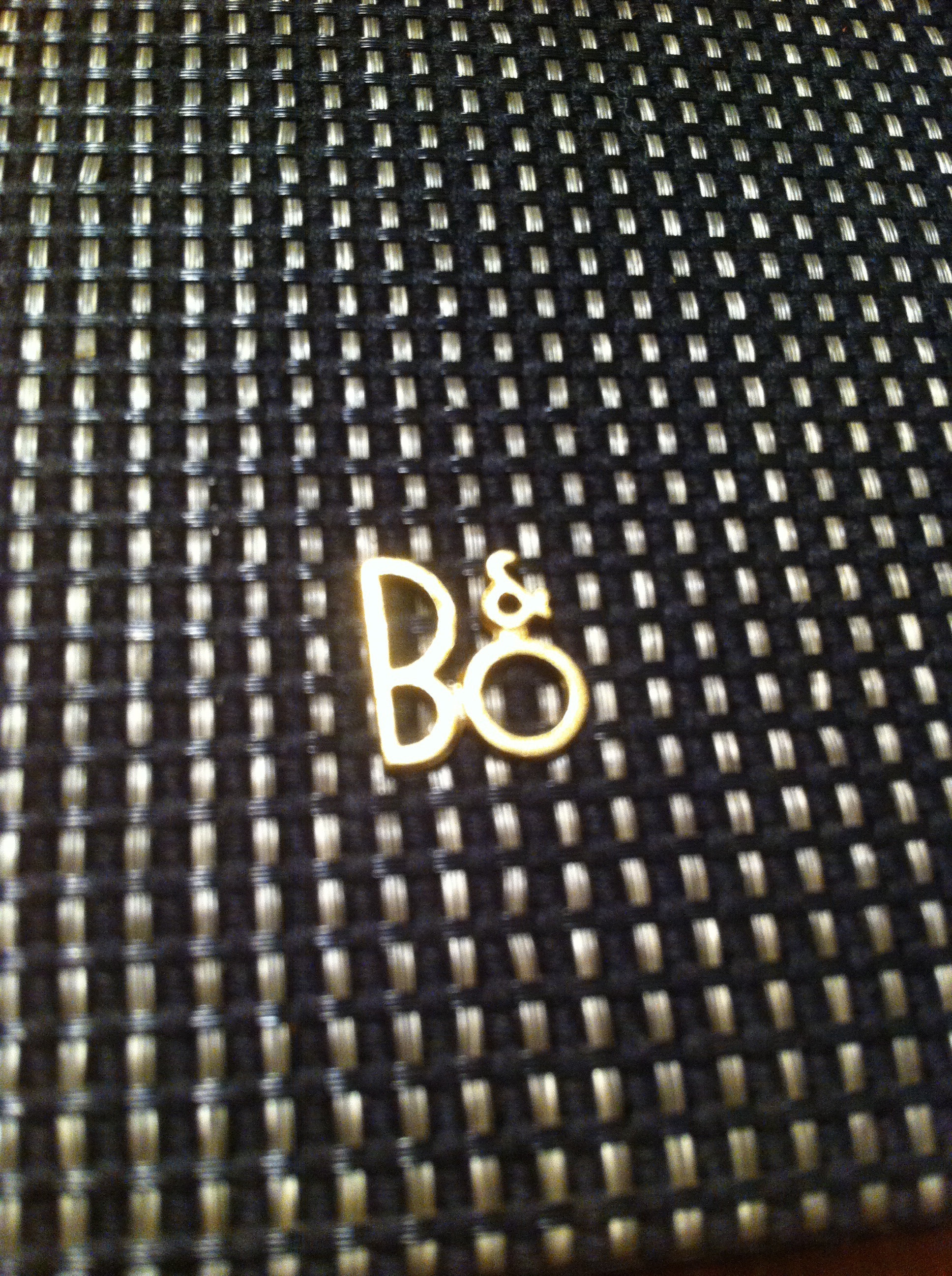

This weekend I purchased another pair of loudspeakers. A pair of beovox 2200. One of the woofers is not working, but it is fixable so no problem! The wood is in excellent condition, with only two marks on de veneer. A nice pair of 60's speakers added to my collection! :-)
They look good! (nothing done so far)
Quite small!
Gold plated logo's!
Installing new caps. (and glueing the broken plastic bracket)
Sanding the wood
Oiling the wood. The difference is very good noticeable!
Waiting for them to dry
They match the other equipment very well!
The second one is not finished yet, so I am not able to really put them to a listening test, but I think they sound quite good for their size!

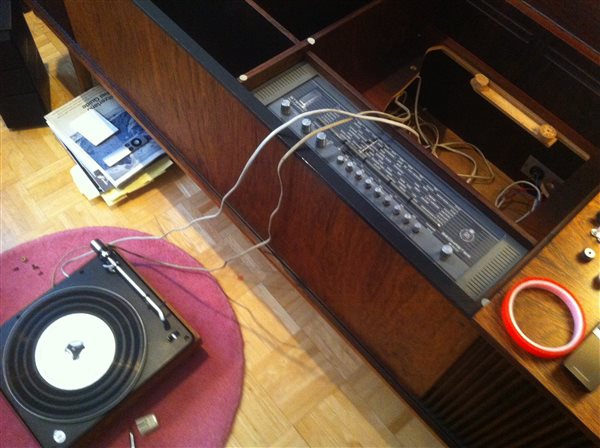

Concerning the beovox 2200's, I found out that one of the woofer coils was touching the magnet so I need to take a look at that.

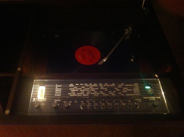

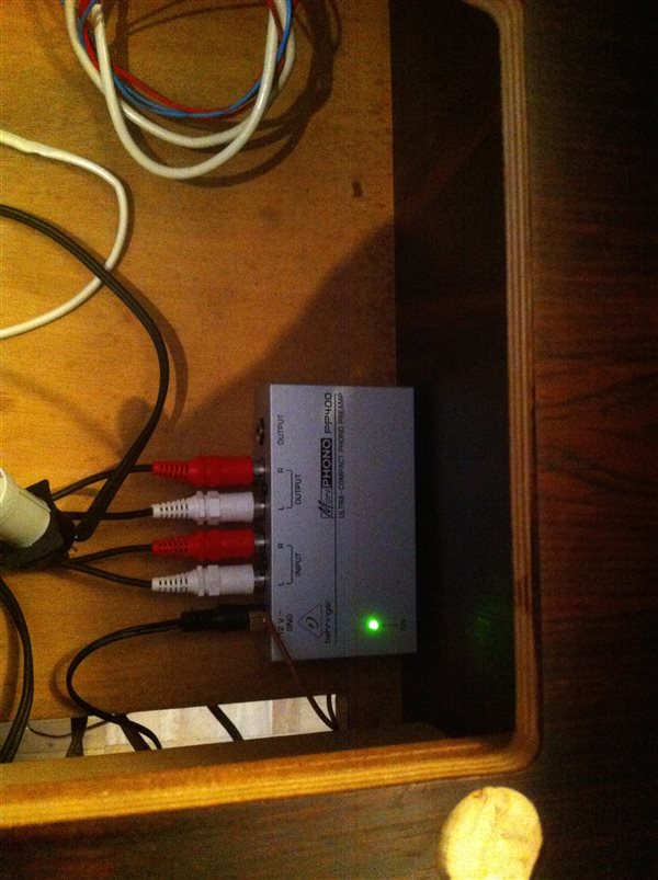

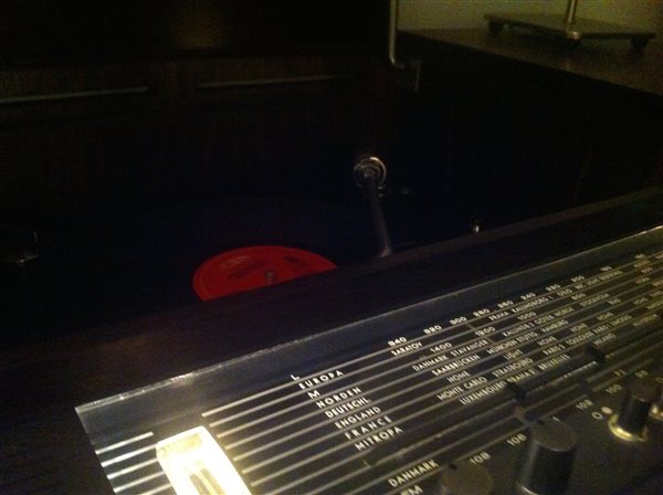

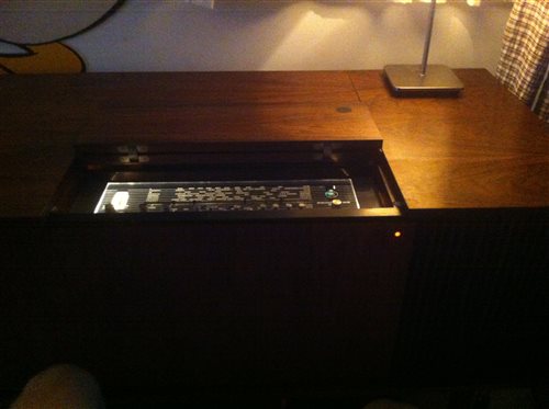

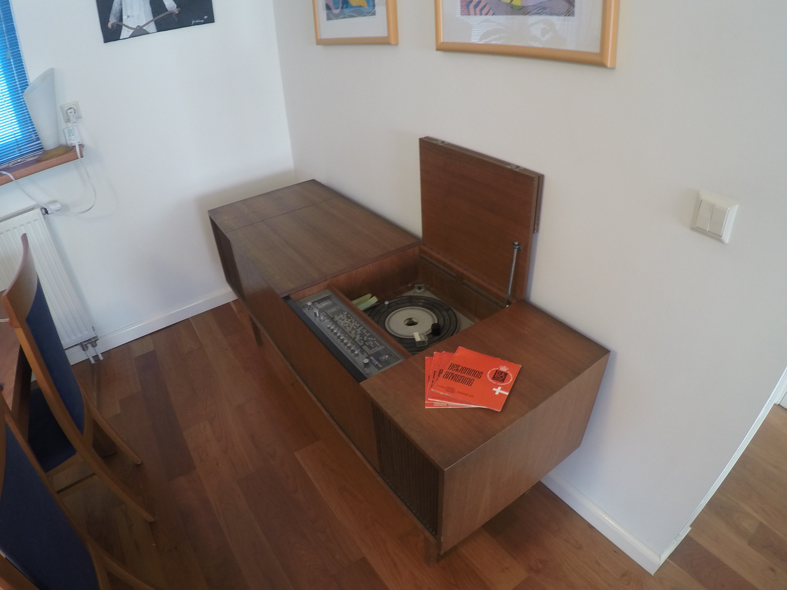

The good news: My Beomaster 900 RG De Luxe is completely functional. I used a donor beogram 1000 as the old motor was, unfortunately beyond repair. The "build in" preamp needs to be fixed so i used an external one. I love it.
Before:
The preamp (temporary solution):
The transplantation:
Previously the metal was suspended on the wood using rubber cylinders, unfortunately these were dried out completely. I used rubber rings from the speaker cabinet of a AV9000 tv to suspend the beogram and screwed the four screws into cork. Checked everything to be level using an iPhone, it's perfect.
A real beauty!
I love it!

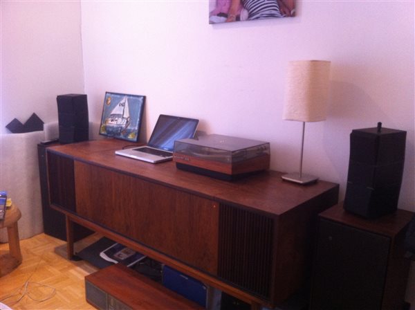

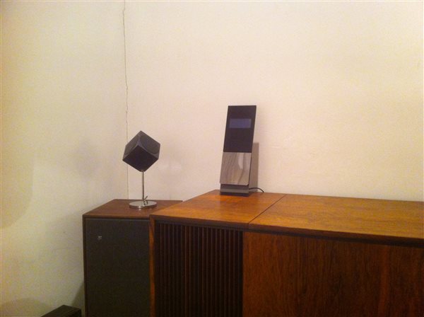

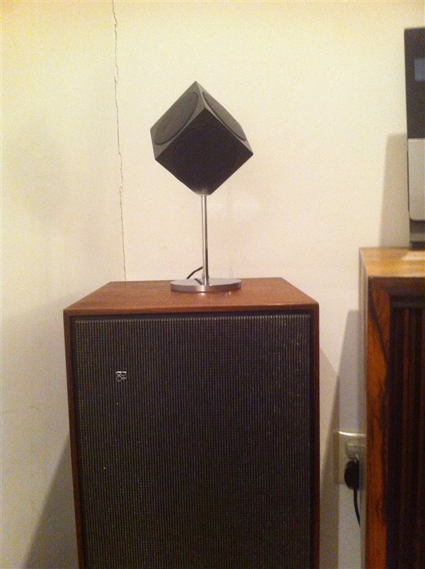

My vintage setup is complete! I finally found a pair of cubes! They are in neat condition, no scratches on the feet, but they could use some refurbishing. All the drivers are functioning.
The sound quality improved dramatically. Furthermore the sound stage has widened.
Icons of their time
