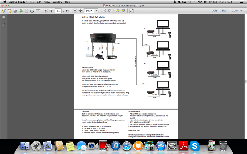

Is anybody using the Atlona H2H-44M (88M) HDMI Matrix switcher?
If so, do they work properly?
What about the matrix wiring/programming? You just connect all PUC devices to matrix inputs and your Beovisions to the outputs - that`s simple...
But how does puc wiring and -programming work?
Thanks
Stefan

Atlona works great with all B&O kit. Update your TV puc and connect a puc cable to control the Matrix & Cat Balin receiver that you will get with your Matrix. From there run your cat connections to the Matrix. Connect all video and ir cables from your devices to the Matrix system itself. Turn on and enjoy :)

Thanks for the replies. As I understand it, sources will be connected to IR-OUT 1-4 for PUC control and displays i.e. Beovisions to IR-IN 1-4 on a PRO3 switch, right?
I`m referring to 44M versions..
So, an Atlona H2H won`t work, as it ha no IR sockets. My initial question was referring to the H2H-44M.
Or will it work adding the HDXX-IR transmitter/receiver?
I would like to add the H2H version, as it`s less boxes and less cabling (I don`t need more than 15m HDMI in most cases)
A bit confusing for me is the V.AUX - GO - 02 - GO.....message.
Did anybody got the system working on a BS3 based system by activating sources (and controlling sources) by just one press, as we all are used to
control Beosystems`
Thanks
Stefan
