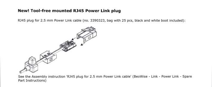

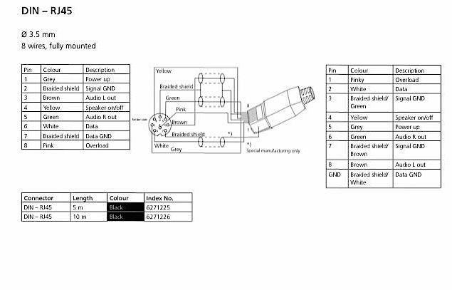

As the title says: Can I terminate old Powerlink cables with a grounded RJ45 connector (I think that it has to be the grounded ones?) or should I buy adaptors or new cables? I have a lot of Powerlink cables and I don't want to put too much money into new cables just to throw the old ones away. I frequently make my own network cables so it would not be that much trouble to terminate to a Rj45 connector - perhaps a little since the wires inside is not the same as in a ethernet cable. Anyone tried?

This might help.
Millemissen: This might help.
Great, thanks!

Actually this is one of the reasons for the change of connectors - it is much easier (and cheaper).
Millemissen:Actually this is one of the reasons for the change of connectors - it is much easier (and cheaper). MM There is a tv - and there is a BV.
berlin2010: When my BV11 was installed the dealer couldn't finish the job on the day so that evening i did the PL - RJ45 conversion myself.
Every installer should have a bag of these in his car
