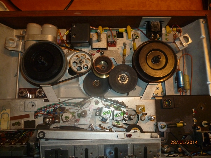

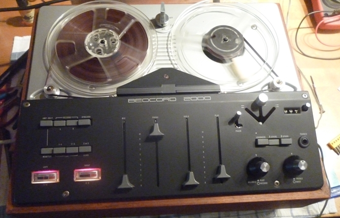

Tamtapir animated me to start on my BC 2000, so here goes. I am not as brave as D""ck, I have had some bad experiences with connecting used devices without checking the inside first, furthermore the main cable looked very bad with the insulation coming off in places, and as it is a little special, I dont have another to connect the BC.

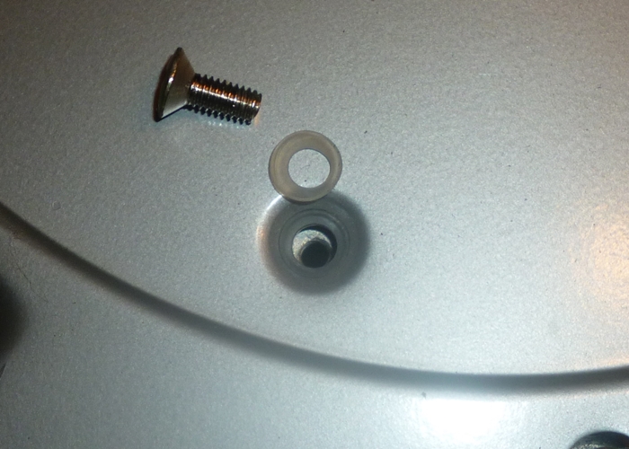

First thing I took off the top covers, knobs come off easily, some of them has a screw, the other ones are just pull off.
Not too much dirt in there

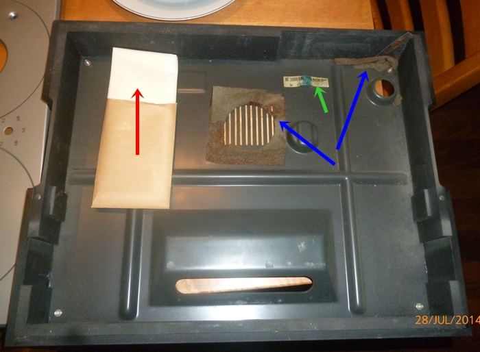

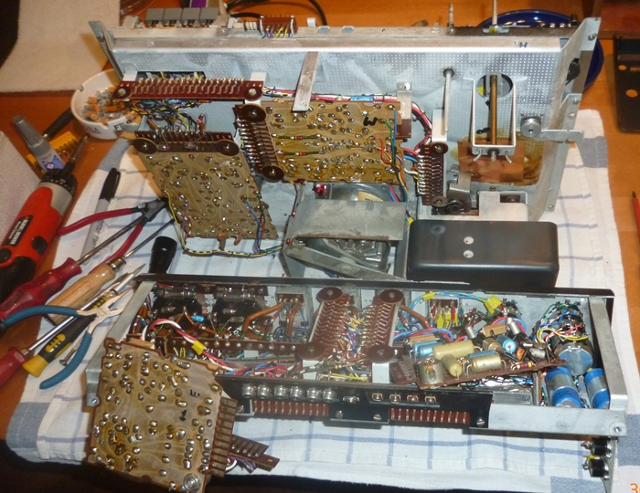

Then the bottom cover, found the drawing, a loose label and some old foam inside

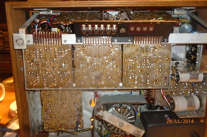

I could now see the PCBs and the way they did it then, simple but effective

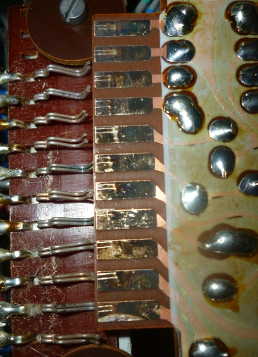

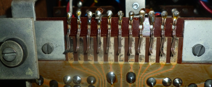

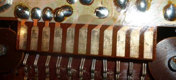

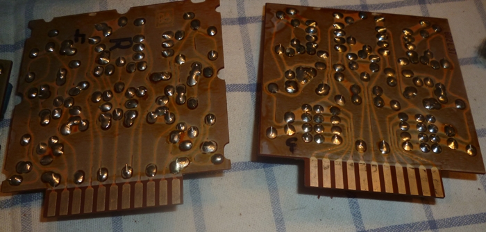

Now look at the PCB connections, after more than 50 years ( maybe 60, I´m not sure about the build year), they are dirty, but as I see it, still with connection
Here a PCB out, as you see connections are there, but all around dirty.

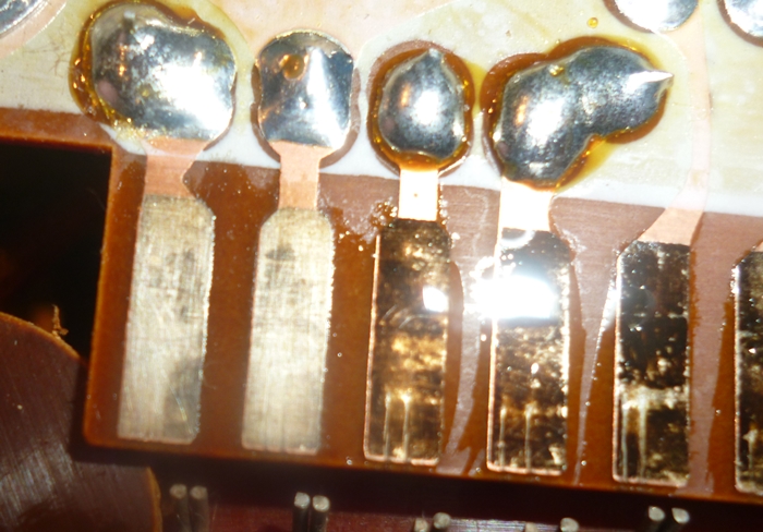

Now I got a bit ahead of myself, wanted to see what Deoxit could really do, soaked the PCB connections with Deoxit, waited 5 min. and cleaned 2 tracks with a cotton stick, nice and clean without abrasives. That will also happen to your switches when you clean them this way.

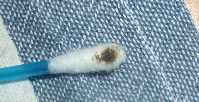

Here the cotton stick, after cleaning one track.
All clean after 15 min. soaking
I now numbered all the PCBs as I´m going to treat all of them the same way. Then I took off the wood frame, 4 nuts and 2 screws from below. Here the tone heads, dirty but not worn. Red arrow is a tape guide, it had a kind of plastic cover (plastic tube), that one came off in 1000 pieces when i touched it just a little.

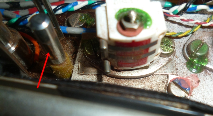

Here the erase head, not worn, but dirty. one guide, arrow, very dirty, but not worn, I found another one worn, amazing what a tape can do to chromed steel, I will grin/polish that one, hoping its only the chrome, and not through to steel.

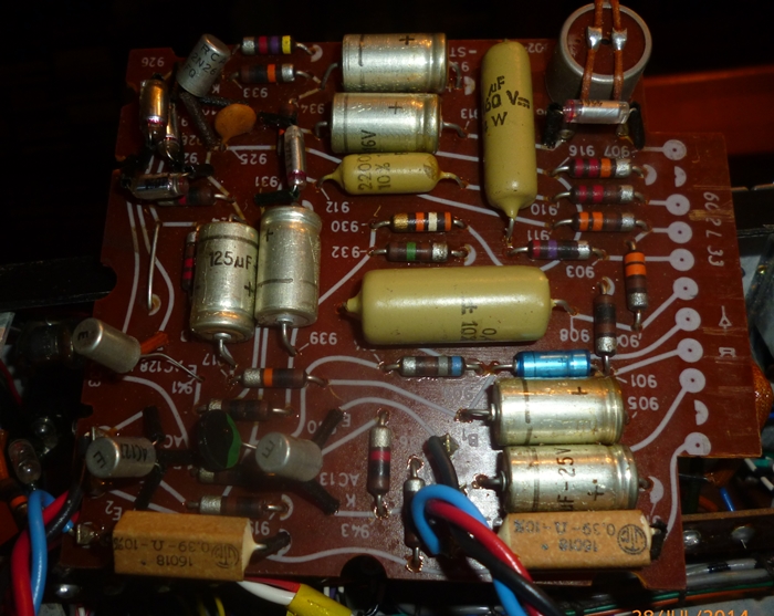

Here one of the PCBs, they all look good, no heat coloration, and the caps looks good too.

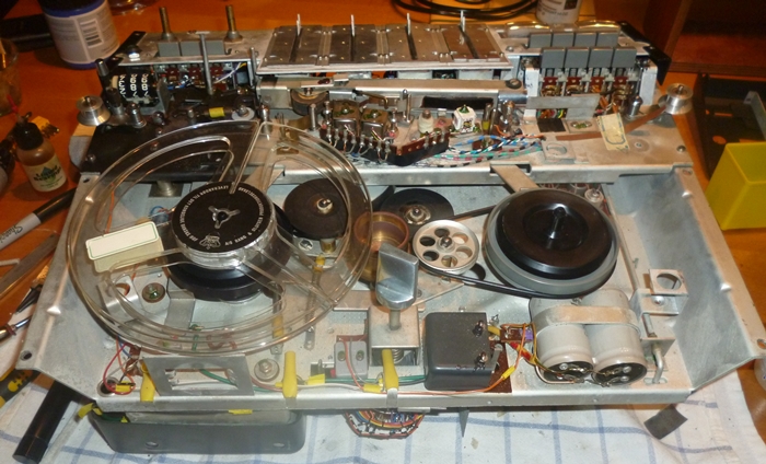

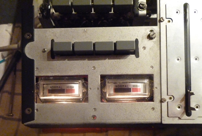

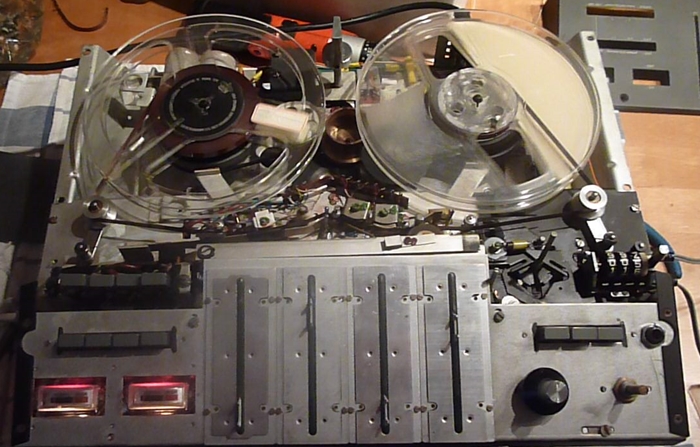

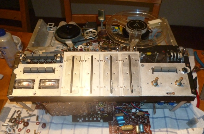

Back to the BC, I passed the wonderful machine a couple of times today, stopped just to look at it, and decided to take it further apart. This because the front panel switches shows oxidation, and it is to see that some of them has not been actuated for a long time, these may or may not  work after multiple "workouts" but I like it clean.
Panel off.

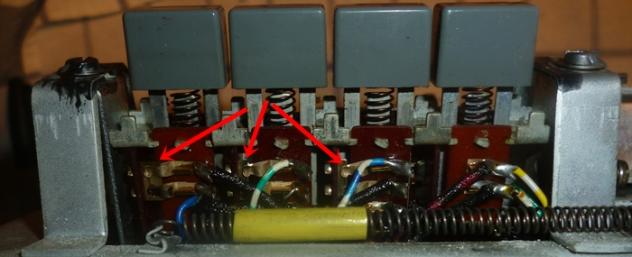

I can now get to the switches from both sides, the switches move front to back over the "tracks", I will apply some Deoxit, work them, leave them 15 min, then clean with ISP.

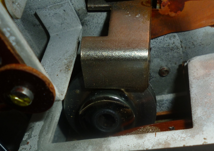

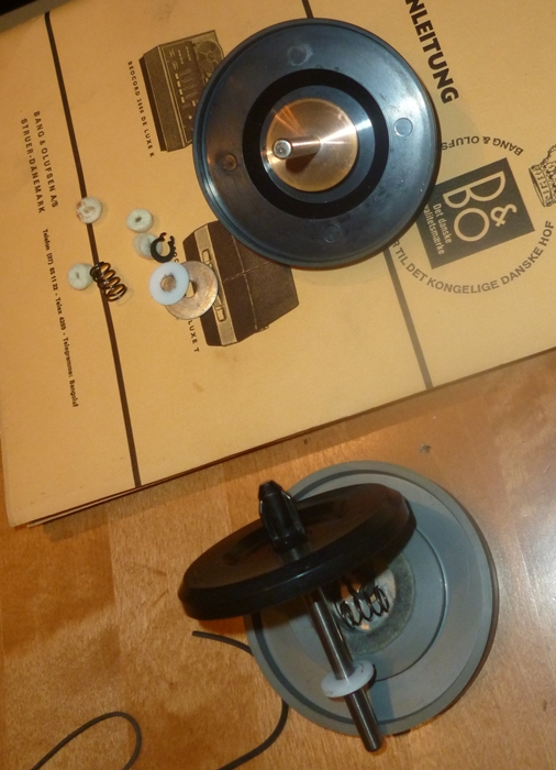

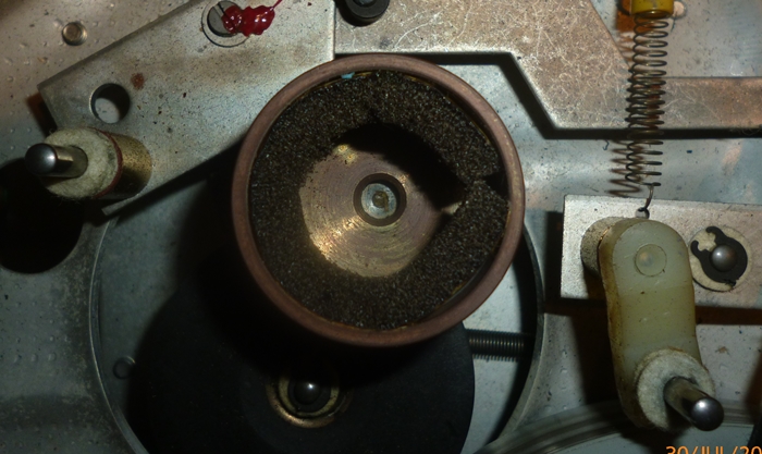

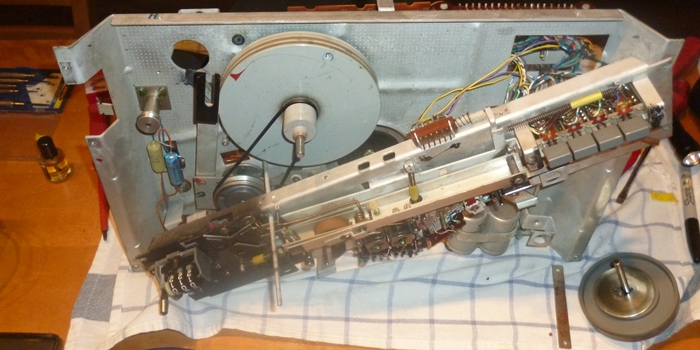

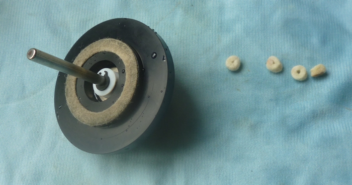

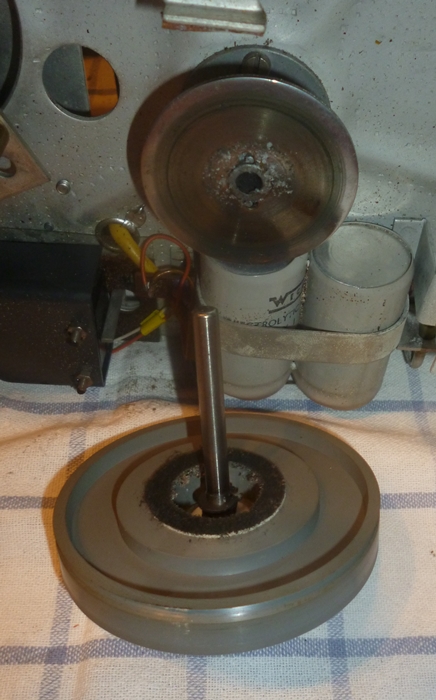

I then went on to study the manual, and found out, the reel drives are constructed from more parts, with a clutch system within them, made with felt pads, springs and washers, the felt pads treated with special grease. Here the components, the felt rings are from a "tape cleaner" located after the erase head an before the record and play heads. All pads cleaned with ISP, soapy water, and ISP again, left to dry over night.

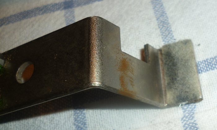

Here the main drive wheel, the old foam must be some kind of dirt catcher, as it is located directly under some ventilation openings in the top cover, I took off the wheel as well, cleaned it and the old foam went to the garbage bin.

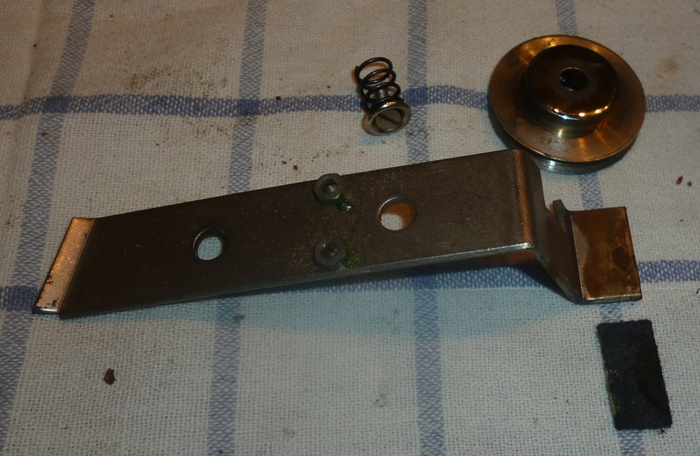

Here the left reel drive, the felt pad was totally dry, these molykote greases tend to dry out, and the only thing left is graphite like residues, these only increase wear, I have since many years prohibited the use of these greases in my workshop, but as the manual prescribes the use of this bearing and gasket destroyer, i went and bought a small amount of it, DONT ever use it for lubricating
To get at the drive pulley I had to loosen and move the whole tone head assembly, I did check this for a long time, but there is no way around it, next pic explains.
I could easily get out the right side reel drive, loosening the wheel for the counter drive, this wheel is also the adjustment for the play clutch, but the lever for operating this clutch can only be dismantled if the tone head assembly is moved to the back of the unit, you can then get at the screw holding it. This lever has a felt pad which also has to be cleaned and treated with a thin coat of Molykote grease. While fumbling around there the felt pad came off and fell down into the transformer housing, I had to dismantle the transformer cover to get out the felt pad. With the head assembly moved I could pull out the pulley, for cleaning and lub.

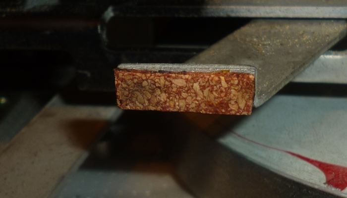

All out, see the old very hard glue and the dirty felt pad, I cleaned the felt pad with ISP, but the glue was still there, so I tried carefully with acetone, and that did it. This felt must be some cotton type because if it was poly or plastic it would melt with the acetone.
Lever cleaned with acetone, I then glued the felt to the lever with Arleenes Tacky glue, I have used this for driver surrounds with good results.
I left the items I cleaned with with ISP and soapy water to dry until tomorrow. The broken belt is for the counter drive.

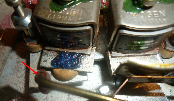

Today I was a little lazy and just did some cleaning, there is not much more to take apart, without a lot of work. So I cleaned all the PCBs. The connections tracks all look like this now.

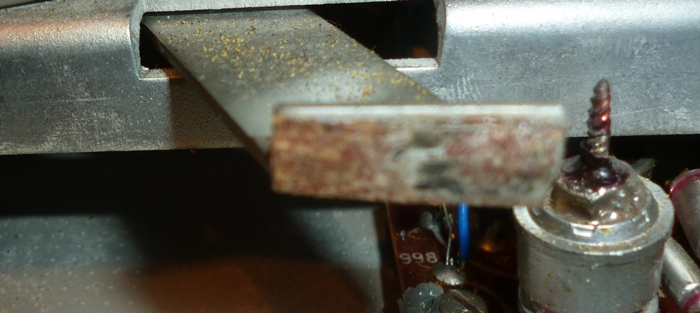

I also checked all the caps with an ESR, found 3 that was on the limit, but not bad, also in the power supply PCB the 2 big rectifiers read good 0.648 V , but the (I think) 9.7V diode only read 0.245 something, ? can this be right, measured on board not connected.
Cleaned the breaks.
Here a dirty one, not the best pic, but you see it.

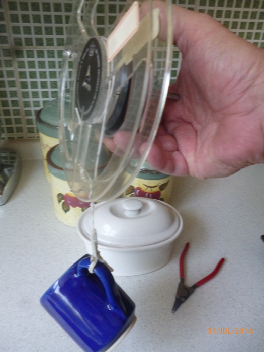

I then went on assembling it all again. According to the manual, I applied the correct grease on all the felt pads, they looked good with no apparent wear. The 2 tape drives has to be adjusted in a certain way with the help of a pull weight scale, these scales comes in different sizes from 0.0 to up where you only dream about it, the smallest one I have starts at 5000 Grams, so no use for it here, but thinking about it, and reading the manual, I made a tool for it. One is supposed to have a pull of 300 Gr. +- 25 gr. between the upper and lower part of the tape drives, so I came up with this. A coffee cup and my Swiss knife has about, 310 Gr. thats where about the upper part has to move from the the lower part.
Coffee cup with knife, move the upper part, without knife (45 Gr.) it does not, thats perfect.
The pair of pliers is to adjust the spring tension. Sorry for the pic, I only have two hands.
I then went on with the assembly, front panel back, its easy, only one PCB connector and 5 screws involved.
Back view, by the way, the original B&O tape spool, did not come with the BC, Søren Hammer gave it to me when I visited him in DK this year. He is still in education (just like Evan), we will hear more from him when he get the time for it.

Nice trick for adjusting the spring's tension Søren, very cunning!
The tool I have for tensioning is this:

chartz:
If I had to do more than just this one RtR I would go and buy the needed pull scales, its really needed to do this kind of work properly, but I will try out the BC first and then decide whats needed.

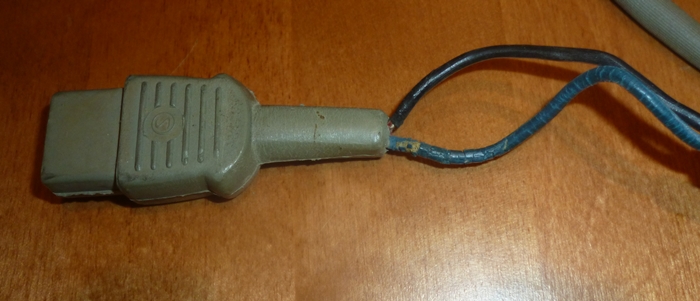

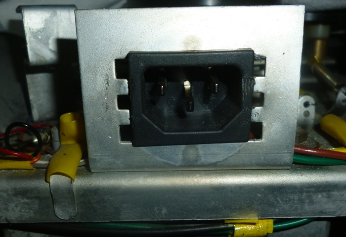

I could not do too much today as I had 5 guests for dinner and had to cook for them.
But I did manege to change the power supply jack, these old jacks and plugs are nearly impossible to find, I have been searching since I bought this BC.
The problem was the cable, that came in a very bad condition, so I was forced to find a new cable with a plug that fits the original jack, or find something that fits into the jack support. Here the old cable. As you can see someone tried to repair it, all the outer insulation is gone.
So I went to the " dont throw it away, maybe I can use in 5 years" bin, found a computer power supply transformer, where the jack could fit, took it apart, desoldered the jack, measured it and it was very near the outer dimensions of the old jack. I could then bend the aluminum taps, holding the old one, to fit the new jack. I have now a 4 feet connection cable, the old one was nearly 7 feet. As the BC only use about 350 mA, and the power supply was 800 mA, I think this will do good service.

Søren Mexico
Mexico City
Posts 6,411
Dave, thank you for the nice words, and of course, the rest of you, who follows the thread, commenting or not. Our responsibility is to teach, thats one of the reasons I post here, not only pics, but also an explanation, how too.
I got farther today, found the failure in the dis balanced sound, the double potentiometer for "play" was dirty ( I did clean it) and the 2 caps was way off, I changed those, 4 uF/40V in the drawing, but 3.2 uF/40V in the flesh, so i found a pair of 3.3 uf/ 63V. But I think the extra cleaning did the most of it. These poties are kind of difficult to get at, but carefully pulling and listening to Rolling Stones 40 Licks does it. Red arrow the cap, its the same on the other side, green arrows is where I applied Dioxit, and moved the poti up and down 100 or more times, that worked
before cleaning and chancing caps i had more than 20 % difference between right and left channel, after less than 10 % . Of course I checked that before assembling the unit. Now aint that beautiful, the big tape, and ready to record, Sam Cooke, Night Beat, from my BG 2404 with SMMC 4.
I love that pink light, I must go to Zona Rosa soon.
I have now balance between right and left, but treble and bass, has very low response, so I will now have to decide if I change all the electrolytic caps, clean more efficiently the poties, and get myself a microphone, to record my voice for the after world, or my nieces doing their things. also I have to get some good new tapes to record, the old one that came with the BC, has "old tape syndrome". I will give it a thought and decide on what to do. But I can record and play, without problems, and thats it for now.
