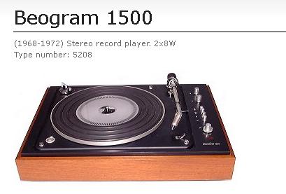

which Beogram 1500 did you inherited? Is it the older (and IMHO nicer) Version Type 5208 with build-in amplifier or the new Version Type 5714/5716?
So, this one
Or this one:

It's the top one from the late 60's, with the built in amplifier. It's lovely (and so heavy!) and everything is fine (volume a little crackly when being adjusted) but it just plays ever so slightly fast on 33, and when you turn it to 45 it doesnt want to know and the turntable stops turning altogether. When bringing it back to 33 (ish) it is a bit of a fiddle to get it to start again.
