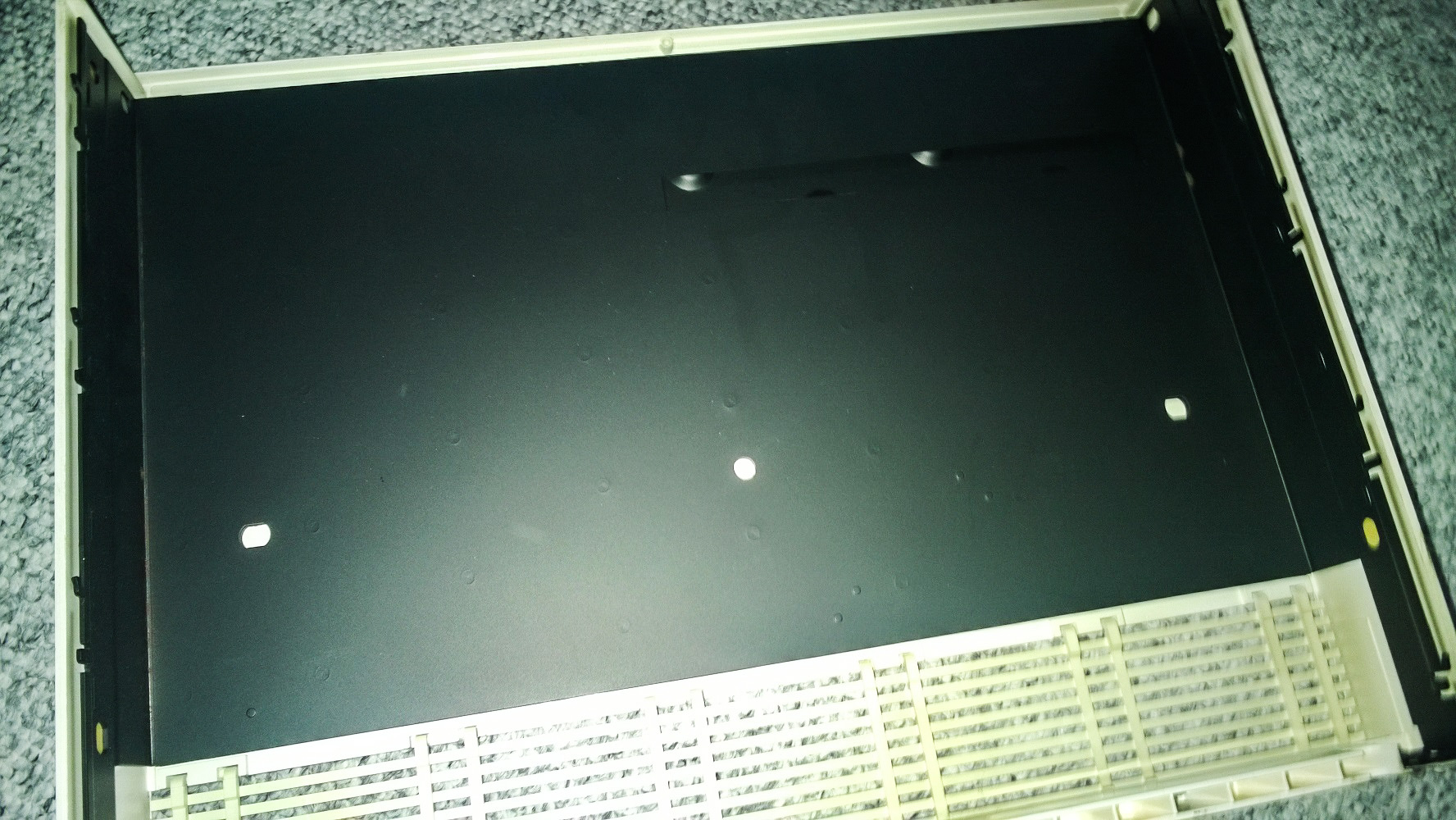

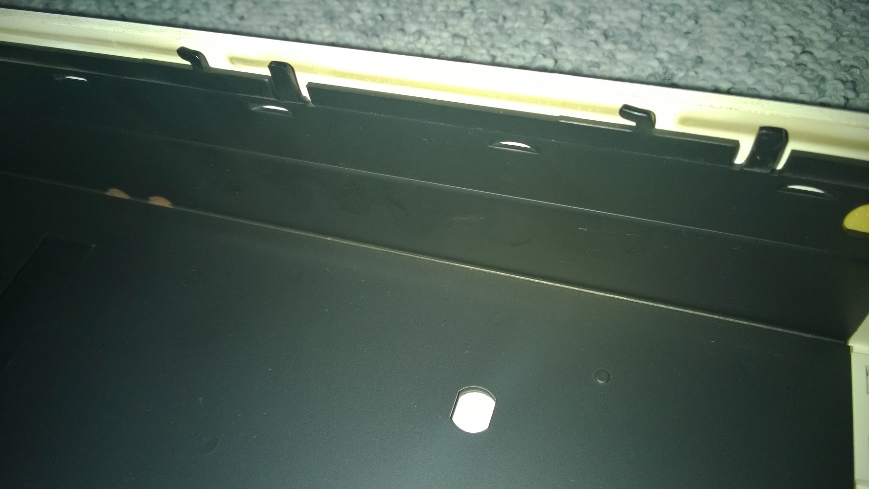

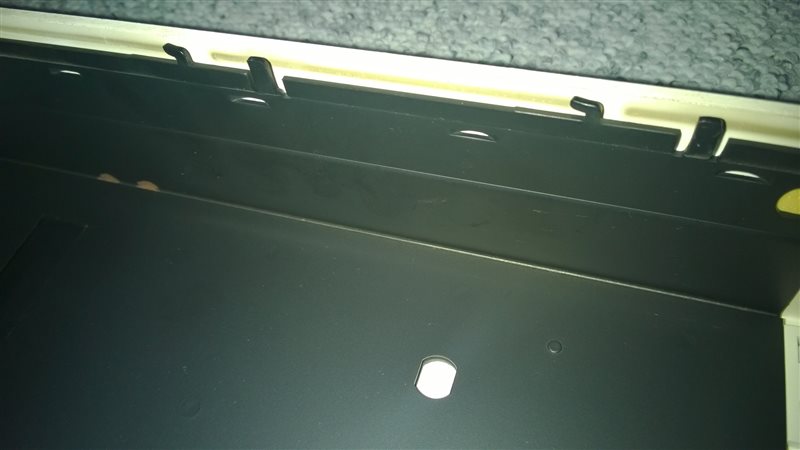

To get back on track.
Here's a few pics of the cover from a Beocord 6500. You can see the metal plate inside.
In the sides you can see some small tabs, that will slide into some cutouts in the bottom-plate (which is also metal).
I have once seen a unit where the previous owner somehow managed to force the cover beside those cutouts... then the sides will get slightly out of alignment.
 If the cover is mounted correctly, then there's no way the sides will get out of alignment.
