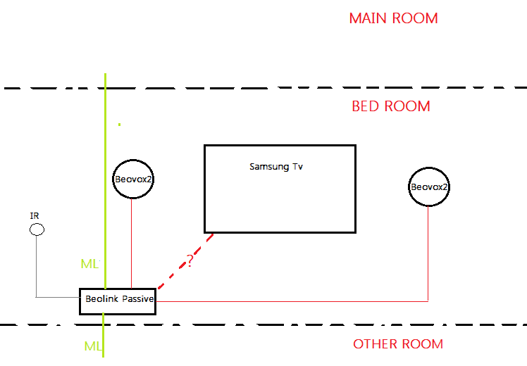

Hello , is there any way to get the TV ( non Bang and Olfusen)  audio through the speakers Beovox 2-2 ?

If you connect a 1636 Beolink active between the masterlink cable and the Passive you will be able to connect your TV to the active's 'PC' input and use it as a local source.
Note that you would then connect the IR sensor to the 'active' and use just a powerlink cable between the active and passive.
There are a few threads about using an 'active' in this way - be careful to use the correct input cable from the TV as the pin cabling is non-standard.
