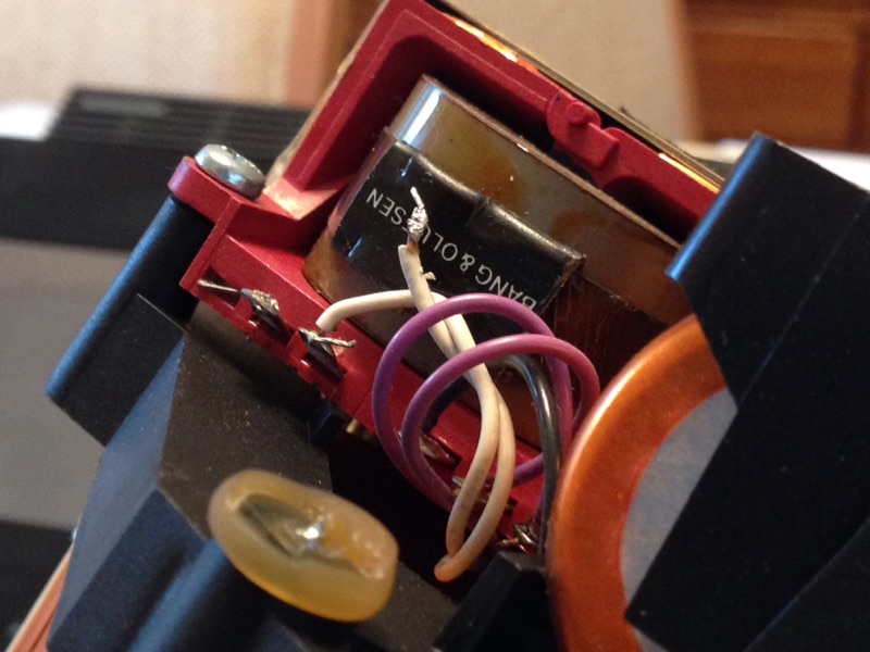

Have you measured if the display module in the dark tower is receiving power? There is very little else that can be wrong if you have already confirmed that the actual module is fine.
--mika

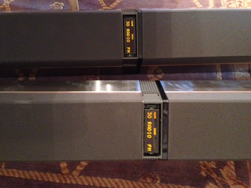

Well done! I believe the loose wire was exactly the supply feed for the display, if that was the smaller standby transformer in your picture. That winding isn't used for anything else, so the rest of the amp worked just fine with that disconnected wire.
